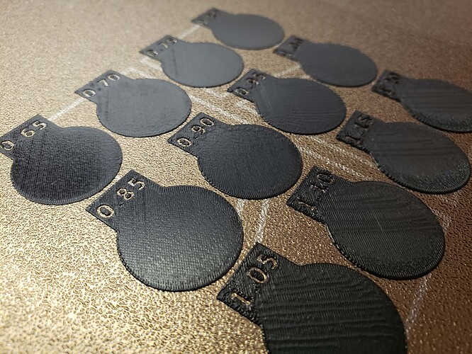

0.2mm nozzle bad first layer
Hi there, fully updated a1, bambu studio, bambu settings, clean textured pei plate with added bambu liquid glue, bambu 0.2 nozzle
underside

flow rate! thanks for the comment to lead me down the right path.
i had a feeling it wasn’t hardware or filament, i felt like it was slicing for sure but just didn’t know what part of it
I used this project Initial Layer Flow Ratio - Calibration Test - Free 3D Print Model - MakerWorld
