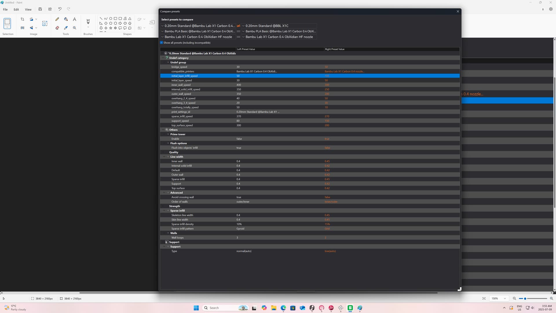

hi, i just recieved my obxidian nozzle and im really having a lot of trouble working through the calibrations for polymaker petg polylite pro. I have a good tuned profile for the regular but i cant seem to get the advantages of the obxidian nozzle.im having trouble figuring out what to change.
Which test am i supposed to do and does anybody have a baseline i could start from?

But another thing im trying to understand is for example once a filament is tuned, are you supposed to turn off auto calibration at the beginning of the print? and if yes, for what setting that you input the value should compensate for removing the dynamic flow calibration?
what im asking is what value does the flow calibration at the beginning calibrate for? Which setting?
Also, i been comparing the presets of hf vs regular nozzle
and i notice certain settings are lower than the regular nozzle. Shouldnt the obxidian be able to do at least equivalent as the regular nozzle?
Thanks
ploymaker PETG im having some trouble. polylite PLA pro is a bit better but i feel like im not able to take advantage of the hf nozzle

Go ahead and do some basic math to calculate the area of 0.4mm hole.
Then check the volume for this area if the cylinder is 0.2mm high.
You can use your line width if you prefer…
Point is that with such small volumes a little bit off on the flow ratio can cause a lot of trouble.
If you want to see how good the hotend is than do a few test prints with the Bambu profiles and then just select the normal nozzle in the settings and do a full manual calibration of filament and print settings - the later either for speed or for quality or both.
You will find that what you established will be quite different to the Bambu defaults for the E3D.
