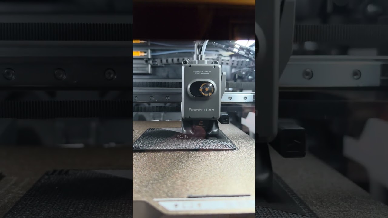

So just the other day my h2s started making incredibly loud clicking noises just like these guys.

Has anyone figured this out? It seems like nobody has been able to repair it. I am requesting bambu replace the printer. It is only one month old.
To be honest, I’m not really sure your issue is related to the topics you linked. In those two cases, the noise only happens during extremely fast movements and when the direction changes quickly. That’s not a click either - it’s a knocking sound in these cases.
Your printer clicks constantly, even when printing very slowly. That’s a completely different problem. It sounds more like something came loose during shipping to you, since it’s a new device.
Its driving me insane. You can hear it from the other room. Imagine 13-30 hours of that. It’s not the ptfe tube. It’s not the extruder. I cant really seem to pinpoint it at all. Whats funny is…so far my $500 qidi has actually performed better than the h2s. I switched to bambu to try to get better quality nozzles,more quiet performance, and various other things. Here is where we are.

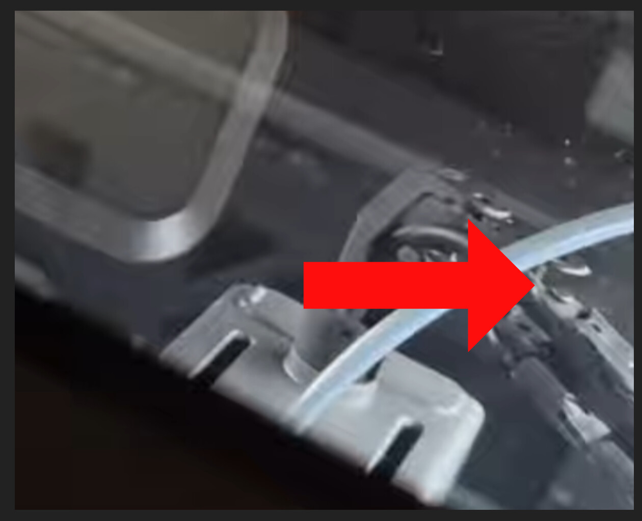

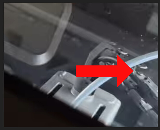

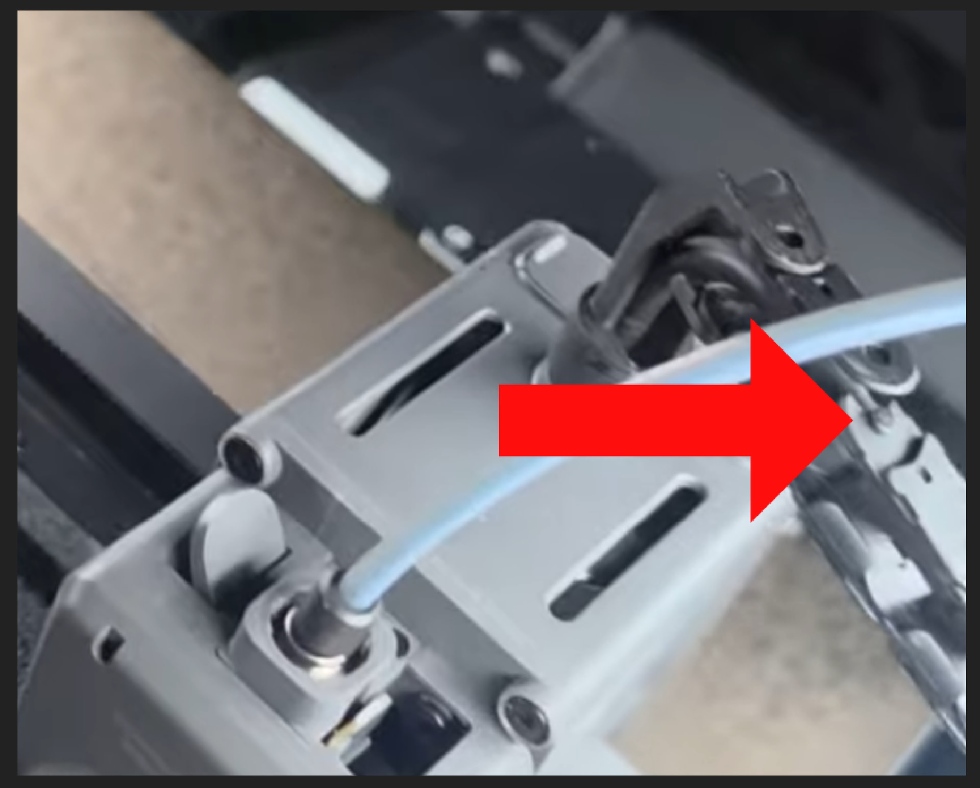

I found the problem - one of the cable chains isn’t snapped into place. That’s probably what’s causing the noises.
Im going to check it when I get home, buy did you hear how loud that noise is? I doubt its that. We are going to see though.
Sadly the noise is not coming from the chain
In any case, the fundamental question arises:
  • Why was the chain loose?
That doesn’t just happen out of the blue. Maybe the printer dropped at some point? Delivery? I’m sure there are other parts that are loose, too.
