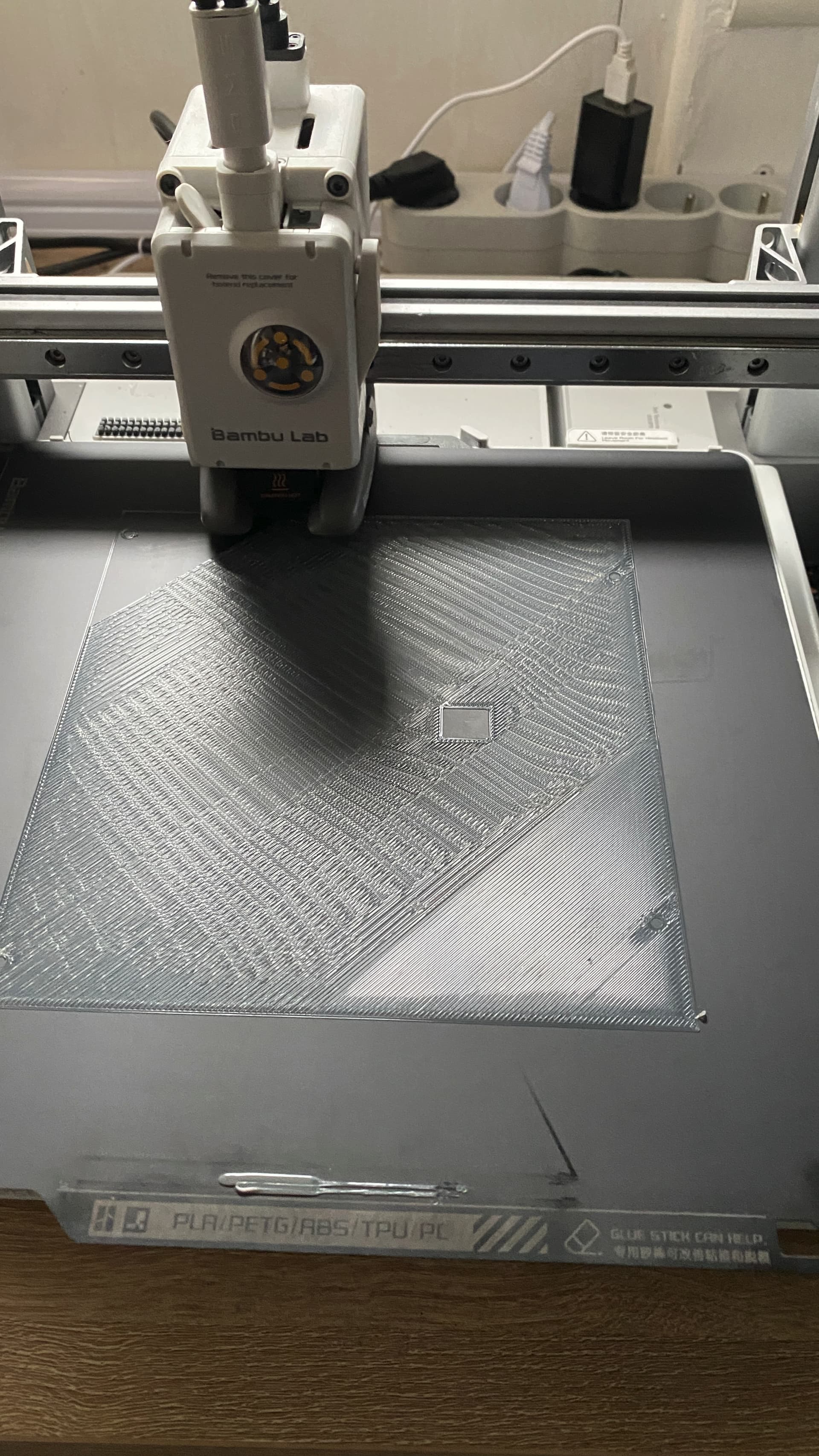

1rst layer issue even after level adjustment
even after level adjustment the first layer stay not well…
WHY? im not biginer I have setting the callibration. and leveling the plate with the 3 screw (stupid system for info)
Can you try to clean the plate first?
This looks like bad adhesion. Also there might be overextrusion. Have you checked the settings yet? You probably hit a key and messed up the settings.
juste clean the bed before this print
With detergent and everything?
Other than that, would you please try to watch what your printer does on the first layer and describe what happens? It might help figuring out exactly what went wrong.
i use washing-up liquid that work fine that not adhesion problem, why this part is relavly good:
last layer isn’t totaly good too , compar to my old prusa mk2s
the next isnt bad only 1st and last layer isn’t cool
I do not know if you know this or already have done so but maybe manually calibrate flow for your filament in Bambu Studio. On Top under “Calibration” then “Flow dynamics”. You can save the value for each filament.

Rase your nozzle’s Z to +.05
