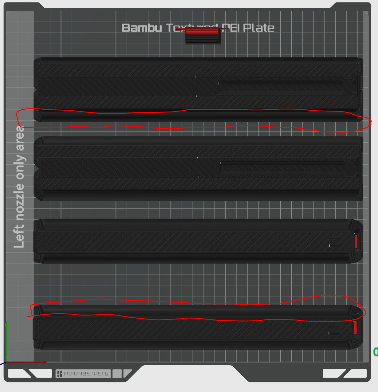

The other frustrating thing is, sometimes when slicing something it will add “trim” not sure what it is called, but it makes the parts much bigger, and I have to print fewer things at a time. I would like to disable this for sure.

This is usually called a “brim” and can be changed/disabled in the project properties under Other → Bed adhesion → Brim type. It is set to “Auto” by default, which in some cases may add brims unnecessarily (or errs on the side of caution).

 Thank you on both cases. I found brim and set it to No-Brim.
Your print is likely to fail without a brim. It’s too large and too straight, the shrinking force would try to pull your part off from the plate. Be careful when sending prints like this.

okay, I will definitely keep watch of this. I have had 3 other printers, many, many years ago and the shake with these is crazy. Right now, I am printing the plate above as is, but I really need needed 4 of each of these rails. When these are finished, I am going to try again without the brim to see what happens.
