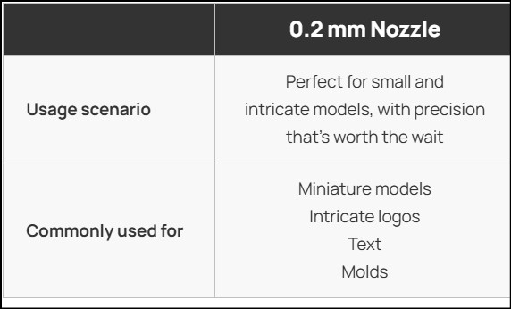

They do not recommend printing PLA using the .2 mm nozzle.
Maybe this will help
Printing with 0.2mm nozzles - Frequently Asked Questions
The problem is the 0.2mm profiles have very low flow rates, they are set at 2mmÂł/s or lower for most filaments. When I use my 0.2mm nozzles I bump the speed to 8-12mmÂł/s for PLA Basic and ABS/ASA. When its at 2mmÂł/s the filament sits in the extruder for a very long time and has time to soften from the hot gears. And yes you need to have good ventilation to prevent heat creep.
I would do a max flow test and set the volumetric flow rate between 8-12mmÂł/s to avoid this issue.
Also if you have aftermarket extruder gears that have metal arm that will cause premature heat creep issues. I would suggest to sticking to stock bambu gears.
What I would say is BL has probably done extensive testing to arrive at their default settings and if one is way wide of the defaults I would expect trouble.
I messed with a .2 mm nozzle a little bit back when I first bought it and the prints took longer than I was willing to wait.
From your link:
What filament should be used with 0.2 mm nozzle?
The 0.2 mm nozzle works best with PLA, PETG, ABS and ASA.
Thats a nice sentiment but unfortunately that is not the case for 0.2mm hot end profiles. Its very clear from looking at them and printing with them that the 0.2mm profiles were at best an afterthought, just like 0.8mm profiles.
I have 9000 hours of printing on the bambu printers and the 0.2mm and 0.8mm profiles need some tuning for best results.
Well I would say they have very narrow window where they are useful.

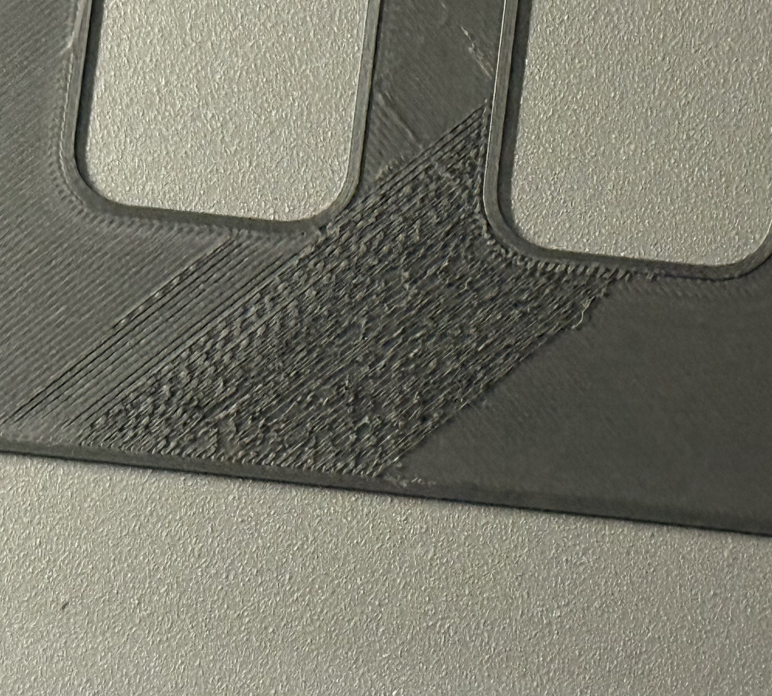

Solid bottom/top layers have always been a problem for me when printing with 0.2mm nozzles, on any printer.
I think the cause is just that the nozzle is moved through that solid material for an extended period of time and can’t release any pressure like it can when printing outside walls, or during travel moves.
Which means while printing solid layers a correct flow value is really important. I would begin by lowering it by 1-2 percent.
Another thing that helped me was increasing the first layer height, although your first layer seemed to have printed fine.
