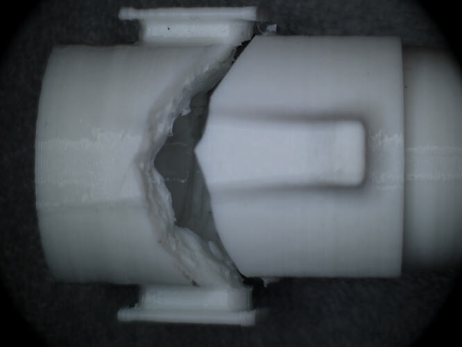

My nut failed like this:

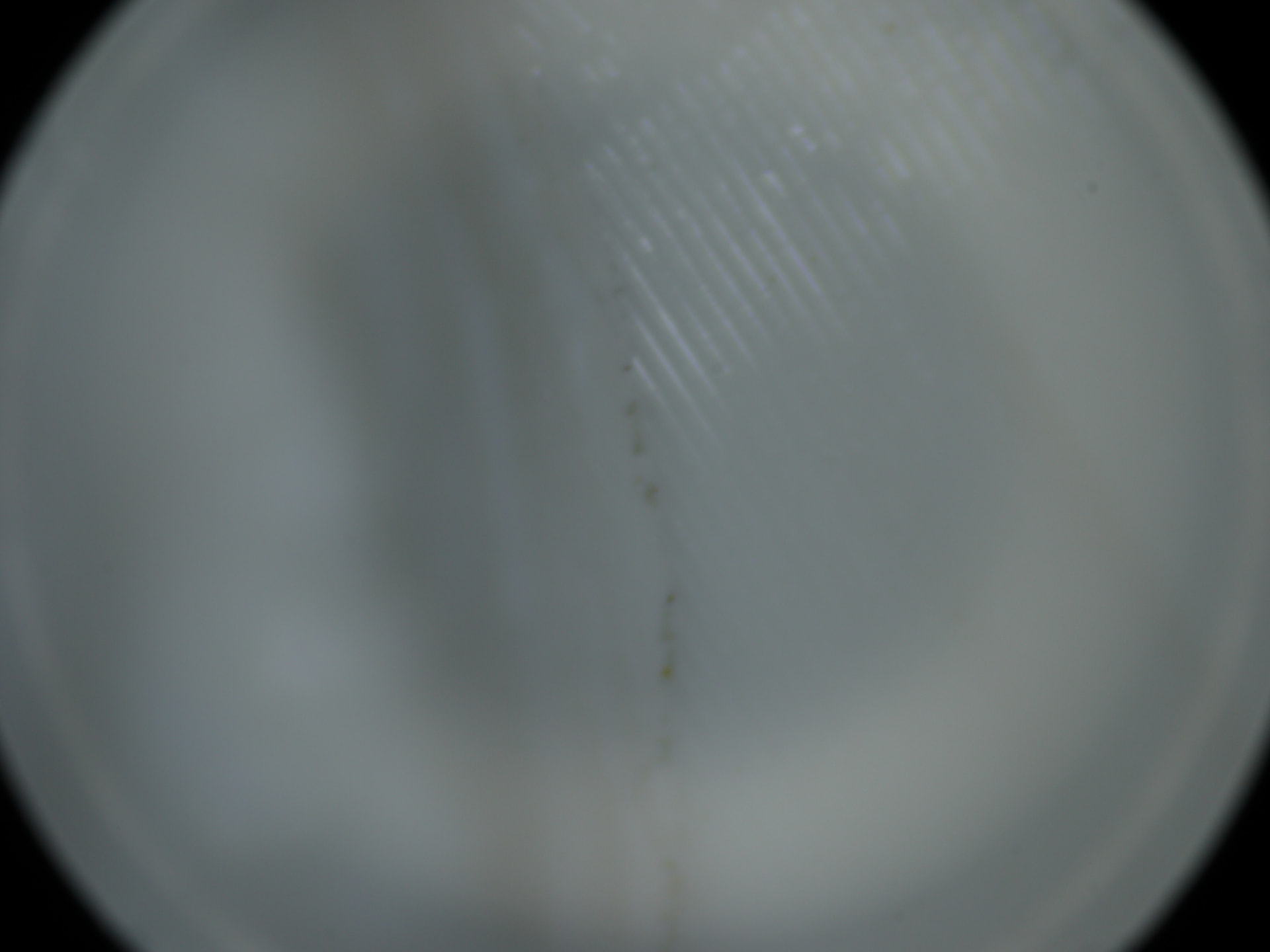

As we can see, it didnt break the way the lines are what we can see clearly in the picture bellow.
And here we can also see the infill.
This is what it looked like with 100% infill.
I wonder if anyone knows, how to improve the strength of my 3d printed nut. Or did i simply hit the boundaries of 3d printed PET-P?
The failure looks like maybe it was caused by “low” interlayer adhesion. Can’t say anything about if it is out of spec though. Could be as good as it gets or maybe not.
Things that affect interlayer adhesion are filament moisture, extrude speed, extrude temperature, and chamber temperature at least from what I’ve read.
No expert on that though but if you need more strength it might be a place to look and maybe others who have looked deeper can add better info.
Thank you very much for your quick response!
Unfortunately, that doesn’t seem to be the problem here. Under the microscope, it looks like the crack goes straight througth all of the layers and not between.
Thank you anyway!

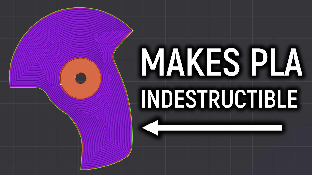

There are tricks you can do with interleaved layers or brick layers (they are different things) that increase the strength of parts printed this way.
Makers Muse has a video on interleaved layers, which he used to print spinning blades for combat robots (battlebots).
Thanks!
Seems very interesting, let me print it that way real quick.
