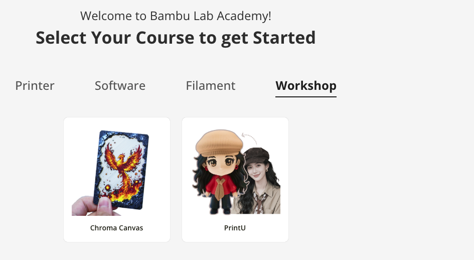

Another great write-up. There have been quite a few other great posts sharing knowledge or tips, such as the power system plan series and the tips on preventing warping.
I would suggest MW put all these writings, and links to knowledge-sharing Youtube videos, in the Bambu Lab Academy. Maybe add a new menu called “Knowledge Base’ or “3D Printing Tips” and add it to the right of Workshop.
Without a central place to hold them, users can easily miss these articles if they don’t happen to see the posts while visiting the forum.
We are actually working on that and we should have an update soon :grinning_face:
