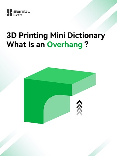

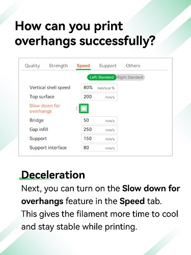

3D Printing Mini Dictionary - What Is an Overhang?
If you want to learn more about overhangs, check out this Bambu Wiki article which goes into more detail.
