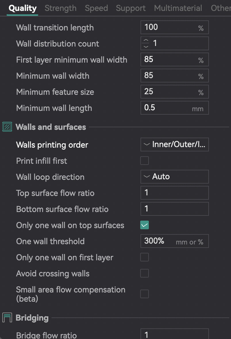

I’ve the BBL A1 for a few weeks now and I’m struggling to tune my printer.
I’m printing a 3dbenchy and I’m using both or slicers BambuStudio and OrcaSlicer and I have the same issue with both slicers.
Essentialy I have two problems.

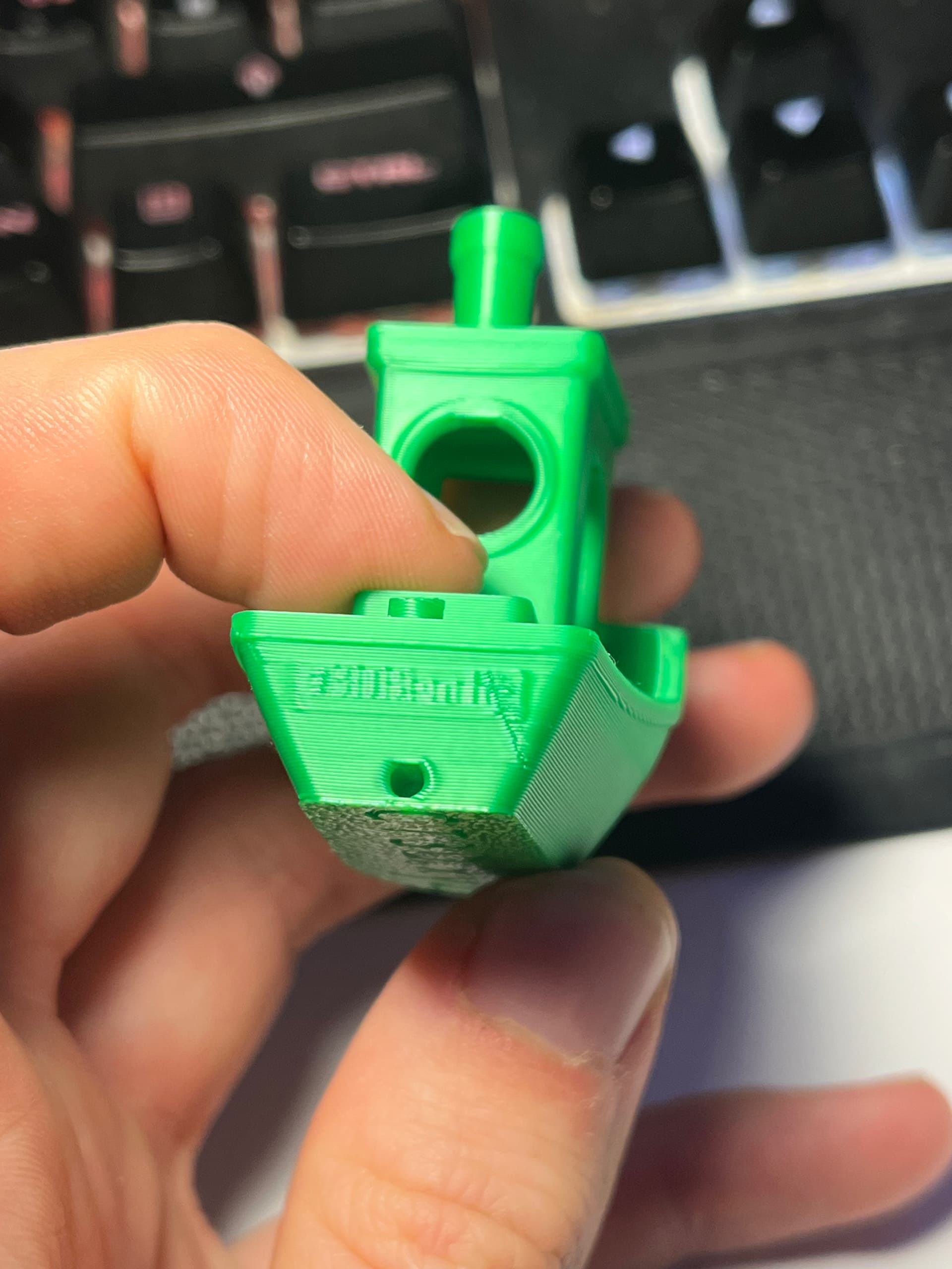

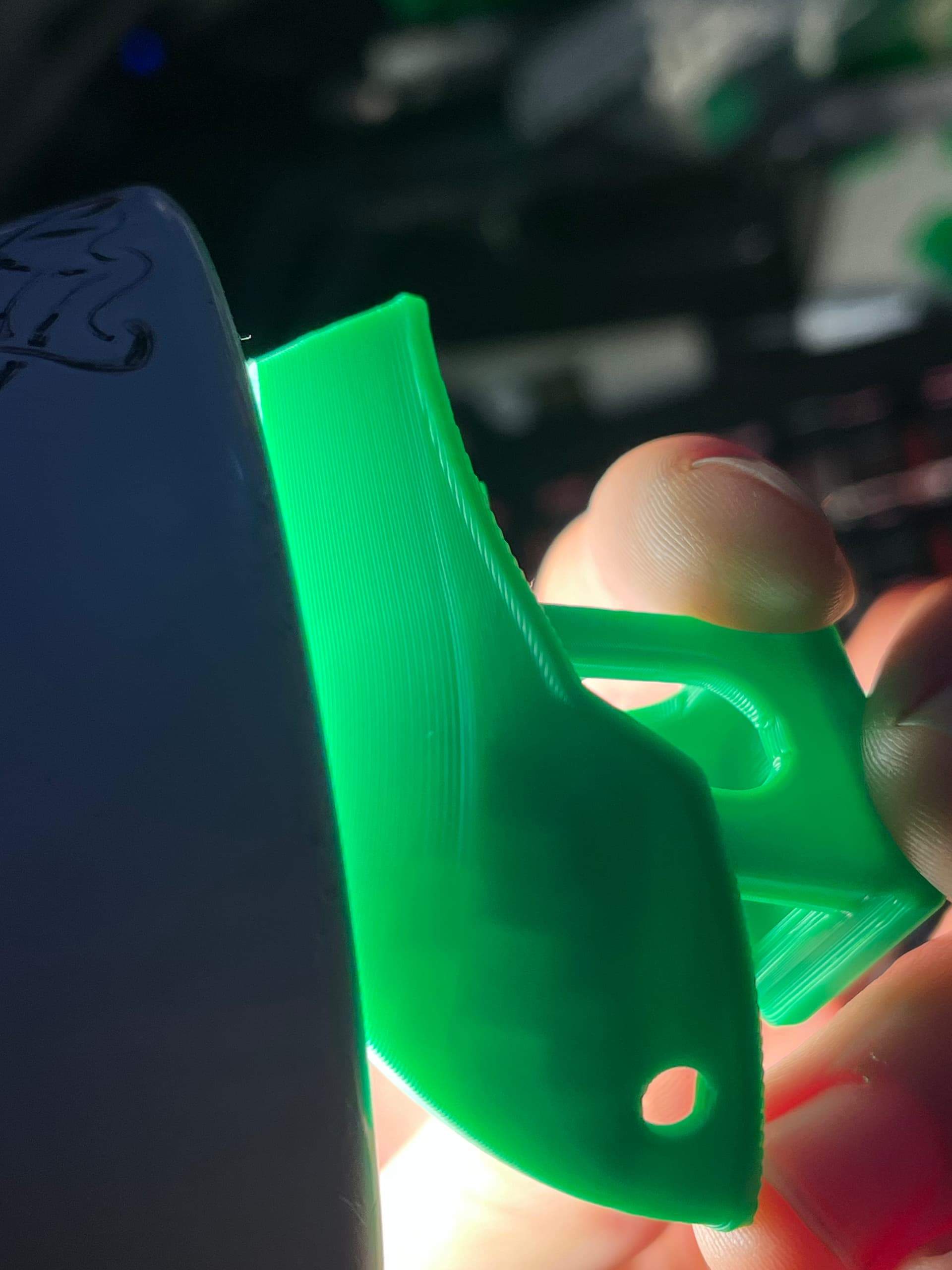

The first one is:
The first 8 mm of layers seems like the perimeter is smaller than the others one above that 8 mm the surface isn’t smooth. I’ve tried everything as outer layer speed from 200 to 50 but nothing changed, more outer walls but nothing.
There are a few photos below.

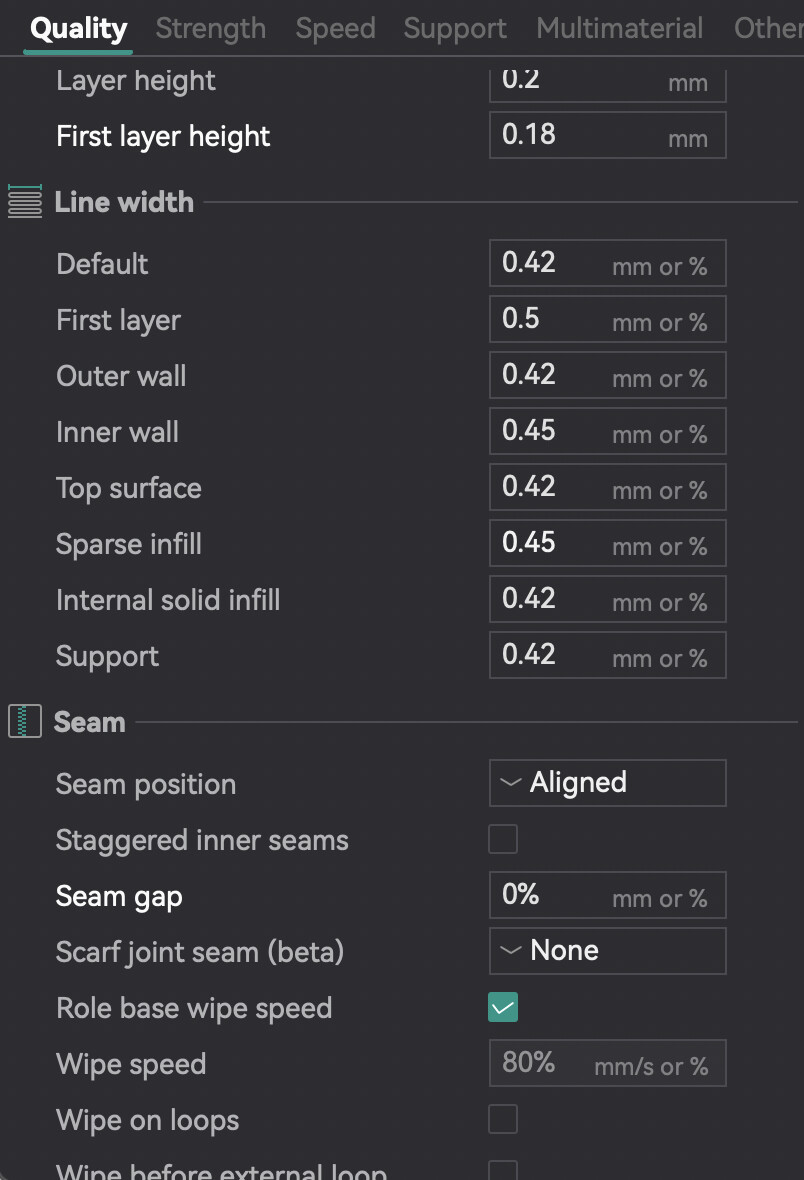

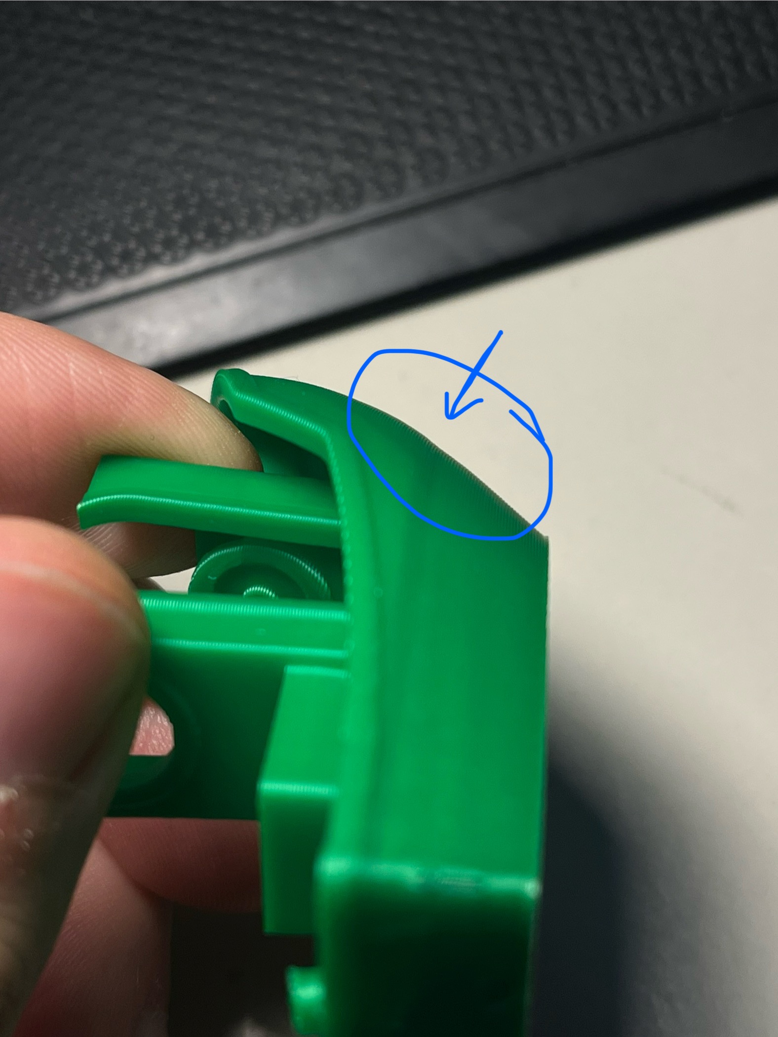

The second one is:
The seams, in this print was 0% but nothing change from 10%.
Any tips to have a good seam?

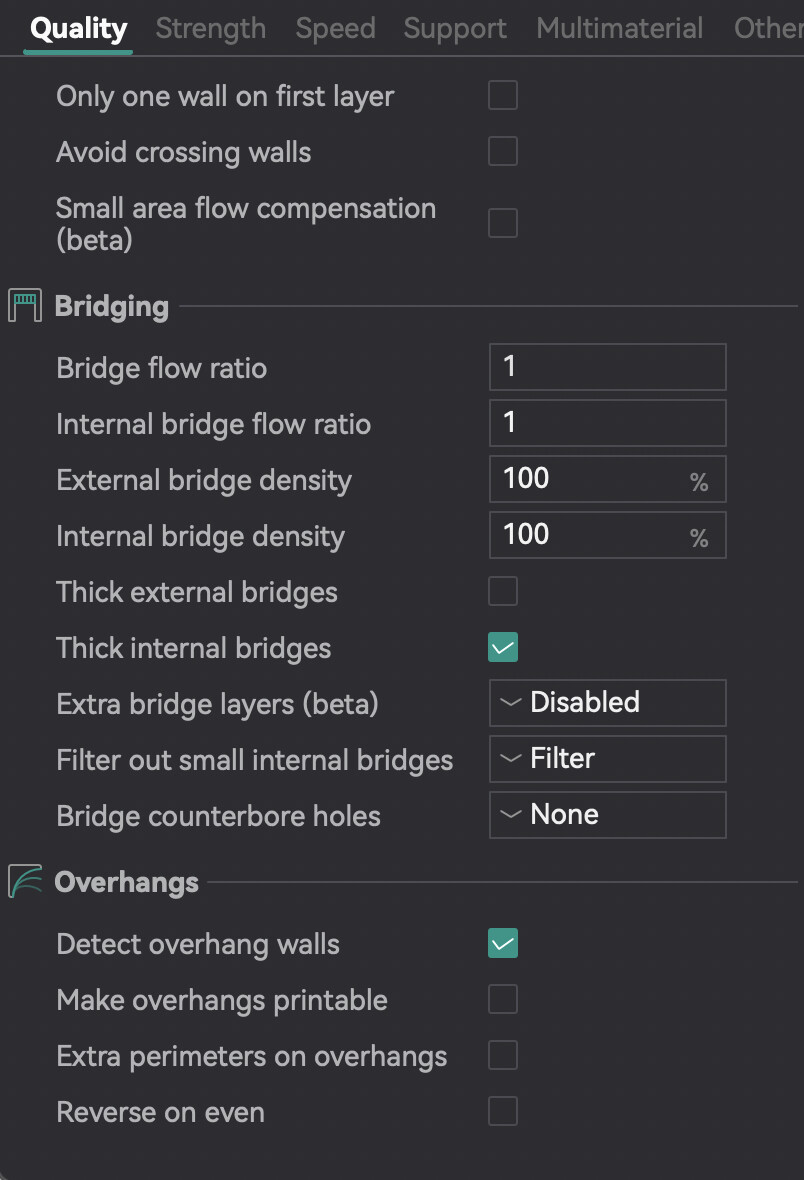

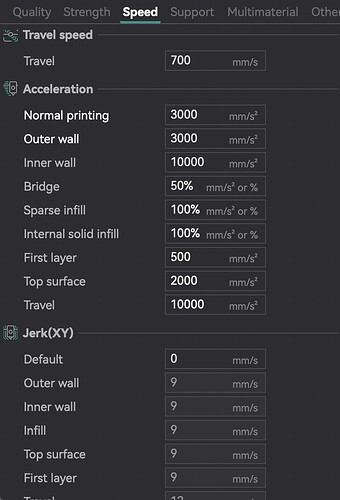

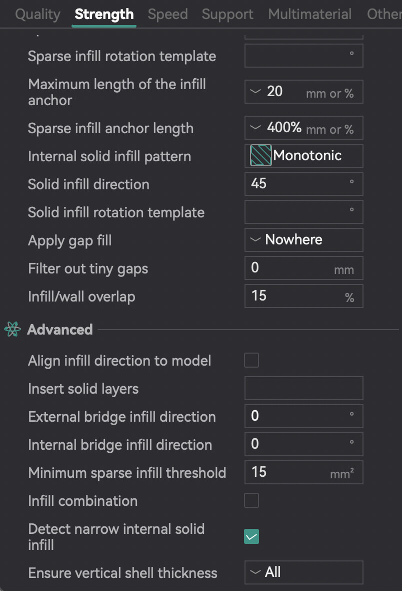

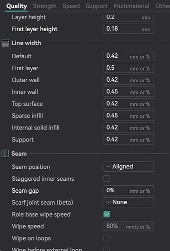

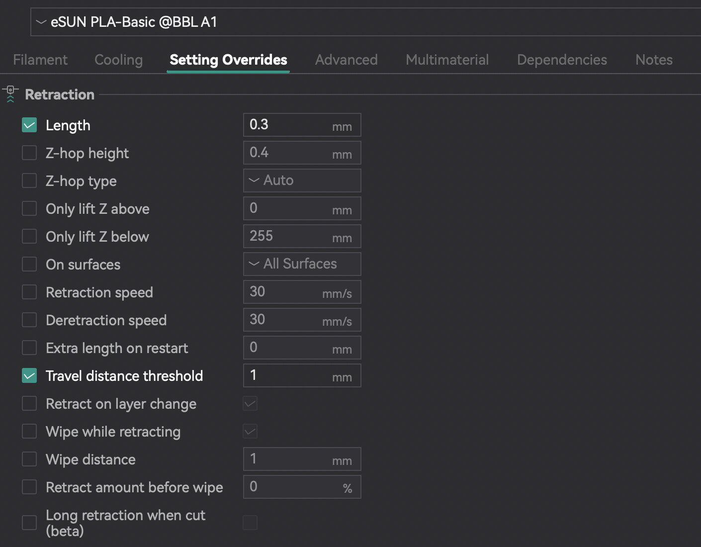

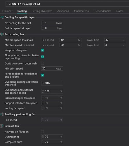

There are some changes I’ve made from Generic PLA Filament profile.
Process: 0.20 mm standard
Filament: eSun PLA-Basic 1.75mm
Extruder: 0.4mm
----Filament—
Flow Ratio: 0.9577
Enable pressure advance: Yes
Pressure advance: 0.026
Nozzle: 220 / 215
Smooth PEI plate: 60 / 60
Max Volumetric speed: 22
—Setting Overrides—
Length: 0.3
Travel Distance: 0.1
Process:
Thanks for your support
Luca s.
It looks like the Benchy hull line. Do a search for that since its a well documented issue.
