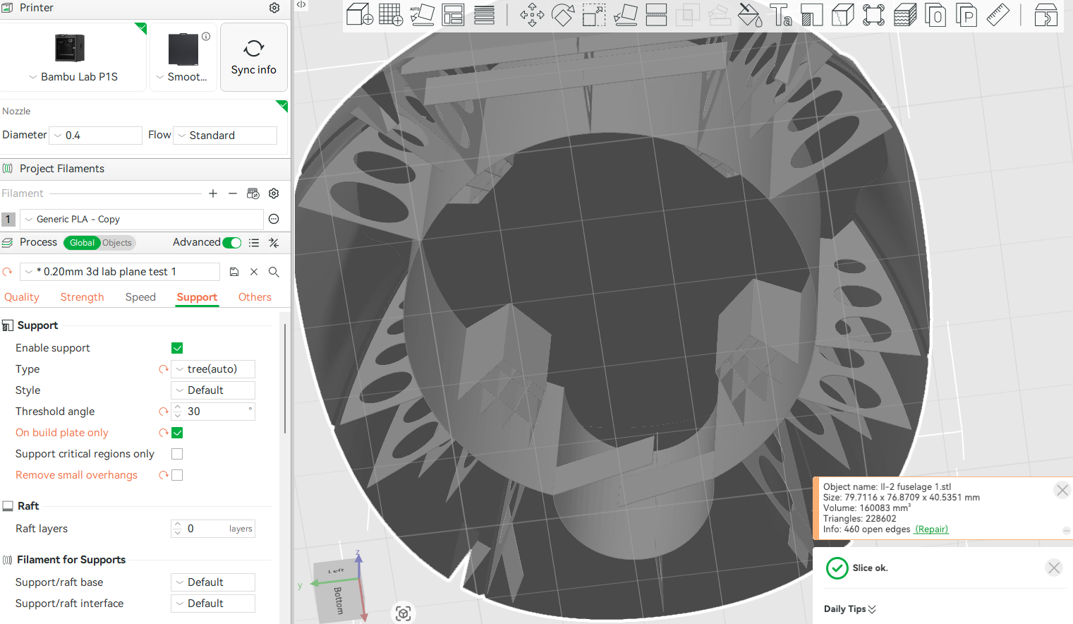

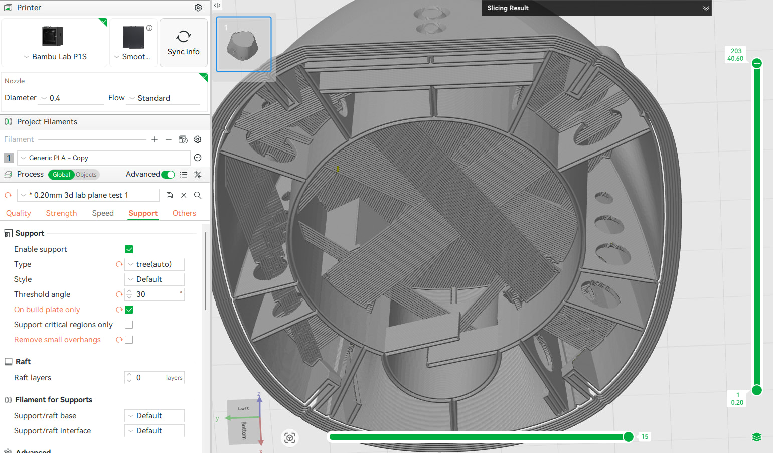

Printing a 3dLabPritns plane, and when I add a top layer for a piece where it’s necessary, the Bambu slicer adds horizontal artifacts that run across the print, blocking off the center of the fuselage, and they even protrude a bit from the outside of the print. (This even happens when I use 3dLabPrint’s downloadable Bambu settings - I’m not using vase mode)
Top picture below is how it should look, the bottom picture is what the preview looks like.
Where are these artifacts coming from and how do I get rid of them? Any suggestions would be helpful.

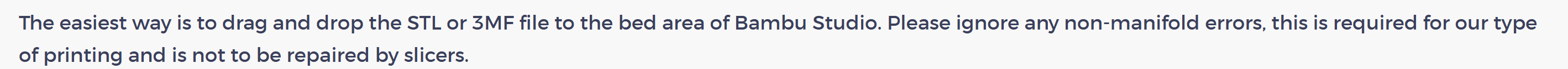

However, I then read what was written in the fine print on a separate page of the website:
“Please ignore any non-manifold errors, this is required for our type of printing and is not to be repaired by slicers.” - So the models are intentionally “defective.” This, of course, pushes the slicer to its limits, and depending on the version of Studio, artifacts and errors may occur.
By today’s standards, that’s not really how things are done anymore. Especially when they tell their customers that the objects are intentionally defective, meaning they’re not delivered in a mainfold state.
Any company that presents itself as a professional business must clearly indicate this on the shop page where customers select the product, or simply avoid selling models that are not manifold in the first place. It’s hidden away in the small print at the end of another page.
The company has maybe achieved a remarkable accomplishment, though, I can’t judge that - however, this is no longer state-of-the-art. Slicer want manifold objects, not defective objects.
There is a way to get around this in Prusa Slicer, but unfortunately that won’t help you right now; however, it does explain a few things: 3DLabPrint airplane models objects were sliced in Simplify3D and, among other things, are not intended to be modified.
