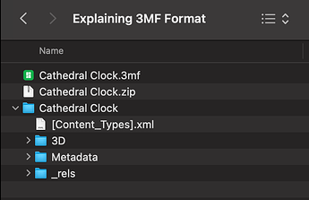

Taking a Look Inside
So, after downloading the “Clock” print profile, creating a copy, renaming the copy to “[filename].zip” and unzipping, you’l be looking at this…
Inside the Metadata/ folder you’ll find (amongst others) the files “plate_5.png” and “plate_5.json” which show a preview of Plate 5 (PNG file) and information about the plate itself:

…is probably the biggest takeaway from the JSON file; however, other than that… not much more information in the 3MF/ZIP files that you’d likely be interested in. Also, note that the 3MF is not just a random ZIP file, so you can’t just:
  1. Unzip
  2. Download missing data
  3. Add to folder
  4. Zip and rename to 3MF
…because that breaks the 3MF structure and Bambu Studio will refuse to open the file. So, on the one hand, it’s is true what @Cypherous is saying…
…as far as adding multiple STL files in Bambu Studio and then clicking “Save Project” to create a ZIP archive of these STL files; however, the information that you are interested in…
…is not part of the 3MF file. Hope this gave a brief overview… if anybody is super interested in what’s going on inside the 3MF… you can view the specs on the 3MF Consortium website (link below):
