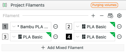

As you are choosing to import “Geometry Only”, you are actually only importing the equivalent of the STL.
The STL (or geometry) is just the model, it does not include any colouring, filament, settings or any things the designer configured to make the shape look as they presented.
Do NOT choose “Geometry Only”, and the expected colours and more will be presented as you expected to see it.

If you want to keep the filament (colours) information, you must import the 3MF as a project and not just geometry.
The geometry is only the shape information and nothing else.
You can not import a model into an existing model and maintain the colour information.
Even if this was possible, you would end up with mixed palettes.
Assuming the first model has red, white and blue and the second one has purple, green and orange, importing the second one wouldn’t gain the purple, green and orange, it would be mapped to the first model’s red, white and blue.
Bambu Studio doesn’t yet support import with settings and filament information in tact.
I don’t know why, likely because the merging and conflict between the source and target would be seen as complicated.

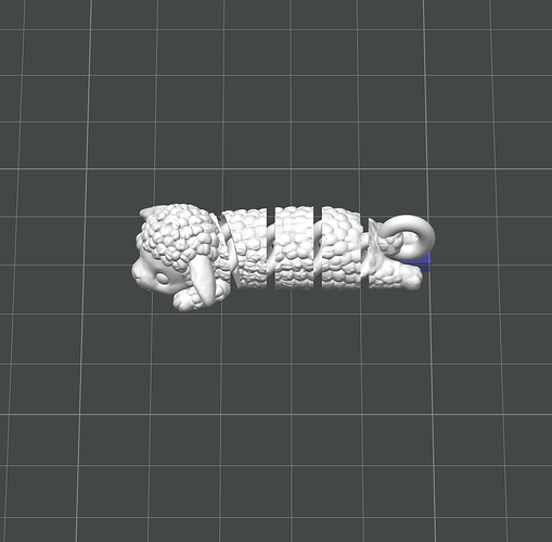

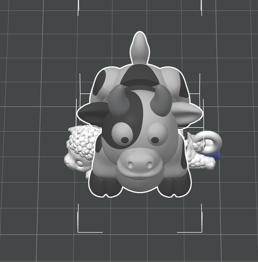

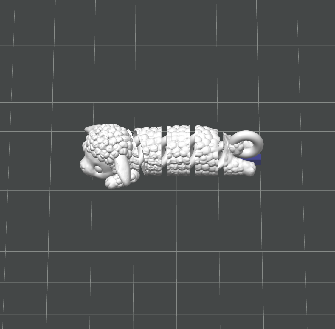

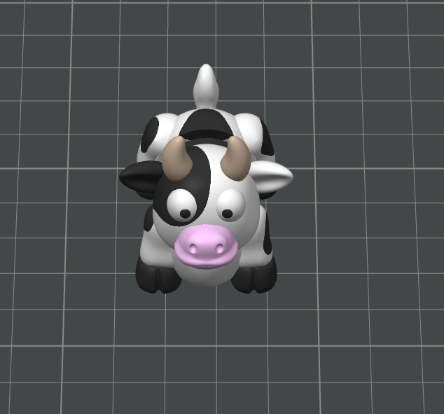

The pink and the beige have been replaced with the colours that had the same index in the sheep’s palette.
EVEN if you add the pink and beige to the sheep’s palette, no palette matching occurs.
Import as geometry loses the colours because it cant match the palette or even bring the palette over.
It is annoying, and dumb as the code to fix it is very small and very easy.
If you open the model (not import) you get all the designer’s colours. If you do not like the settings, you have two choices.
