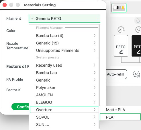

I am really frustrated with Studio’s filament management and calibration right now. What I really want is that when I put a spool of something I’ve calibrated into the AMS, I can choose that calibrated filament in the Device page.
I suppose all the calibrations are governed by the machine, the nozzle size, and the plate material. Is that a reason why I can’t find Overture Gold PETG here, or at least Overture PETG?
I have it as generic PETG in the filament manager tab. That’s because I can’t rename anything in the Filament Manager.

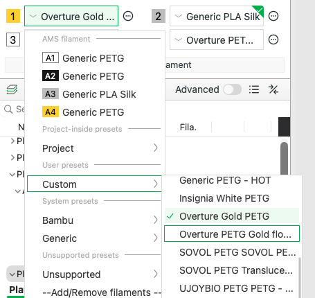

Back in the Prepare tab Project filaments, I can find my Overture and select it. I guess I get to do the same thing for every project where I use my Overture Gold.
I keep thinking there is a reliable way to enter the filament name once, calibrate once, and just keep using it project after project. Someone please tell me there’s a right way to do this.

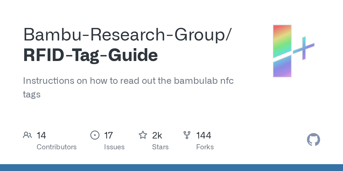

What I can offer, though, is a workaround - but it depends entirely on how determined you are to go through with it. You’d have to create your own RFID tag. And because Bambu uses a closed system, it’s not exactly straightforward. Essentially, you’d need to hack together a filament profile in a kind of Frankenstein fashion - one you’d never actually use for printing.
You’re basically relabeling your third-party filament as an official Bambu filament - but one that you’d never actually use, because you don’t want to ruin a filament profil that you use all the time.
You might also be wondering why I’m suddenly bringing up RFID tags: Well, how should I put this? Anything that has an official Bambu RFID tag or is based on an official Bambu filament profile essentially gets VIP treatment in terms of synchronization: Slicer, Project, AMS, printer, …
One button, and everything is synchronized, almost.
So, depending on the circumstances, it might be worth “Bambu” branding the third-party filament.

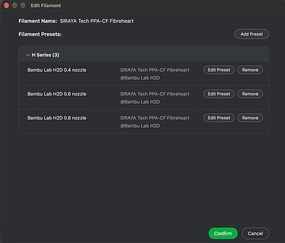

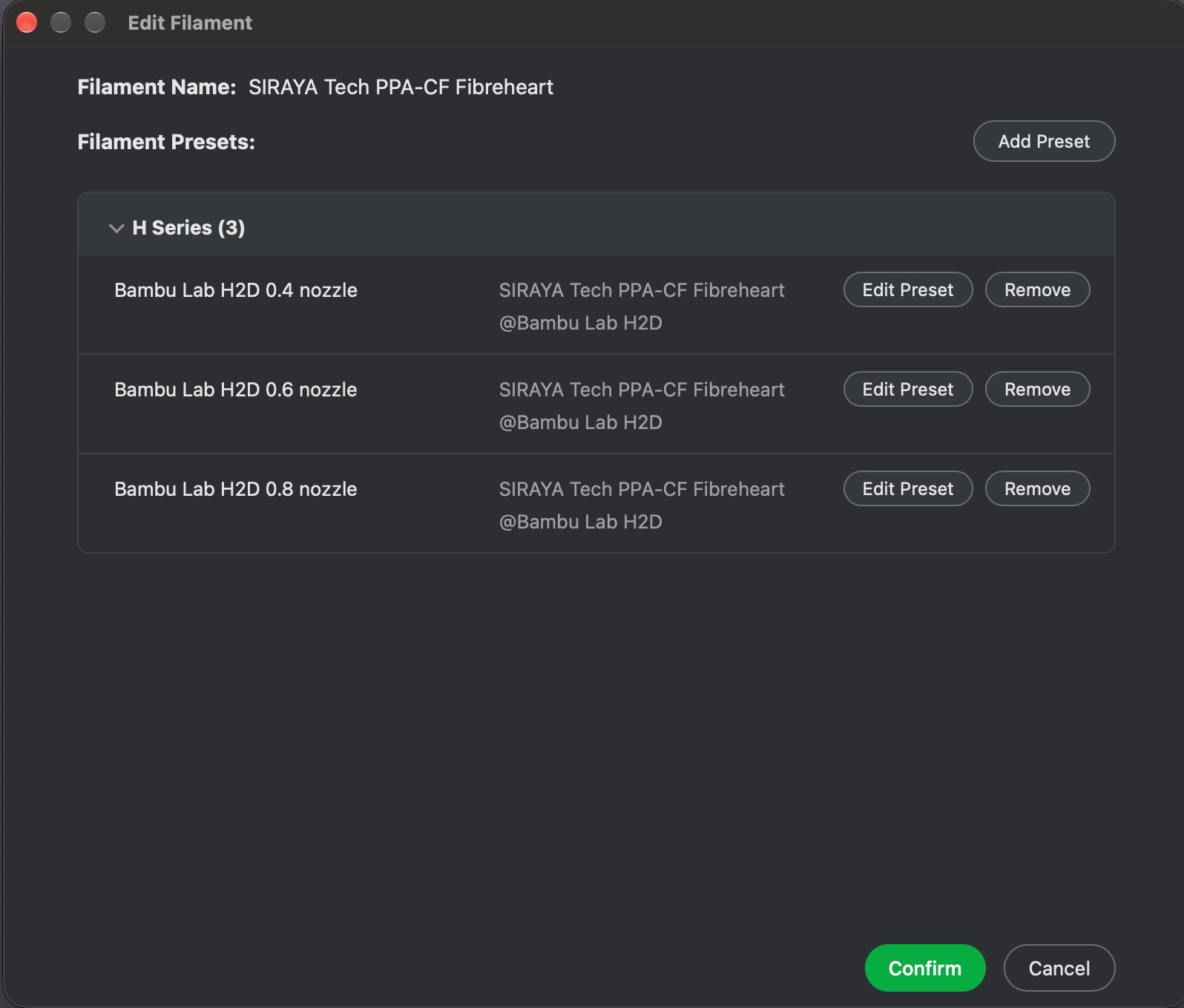

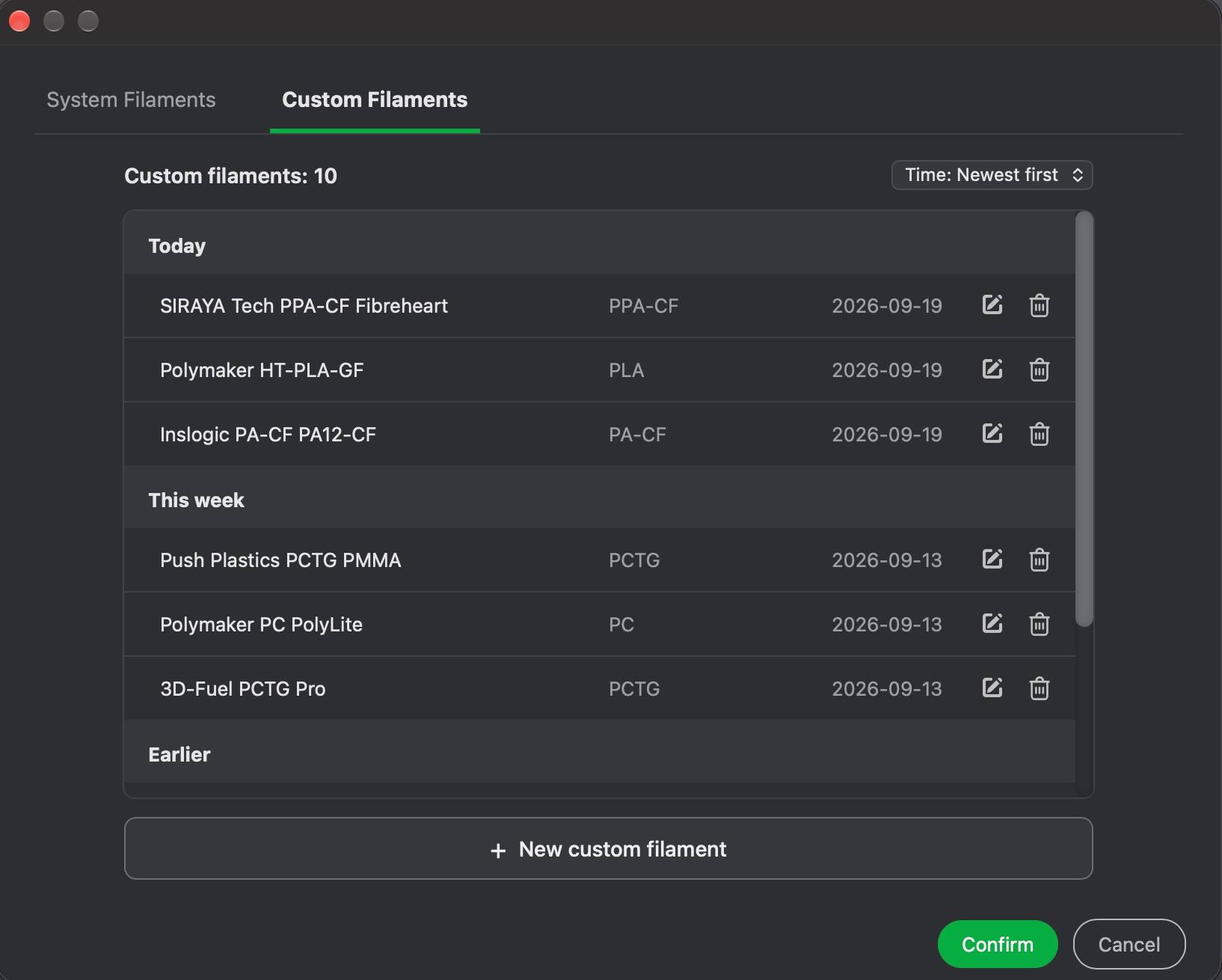

I can get reasonably close. When I create a custom filament using the filaments dialog at least it shows up on the printer UI AMS screen under vendor and type for whatever nozzles it’s compatible with. I still have to manually select it in the printer but at least it syncs up correctly in Bambu Studio. Certainly not as convenient as a RFID tag.
Thanks! I’d forgotten about that screen - yet another for adding filament info…
My filament entry does not break down custom filaments by date, I just have the vendor/type info. Are you running a Bambu Studio beta version?
