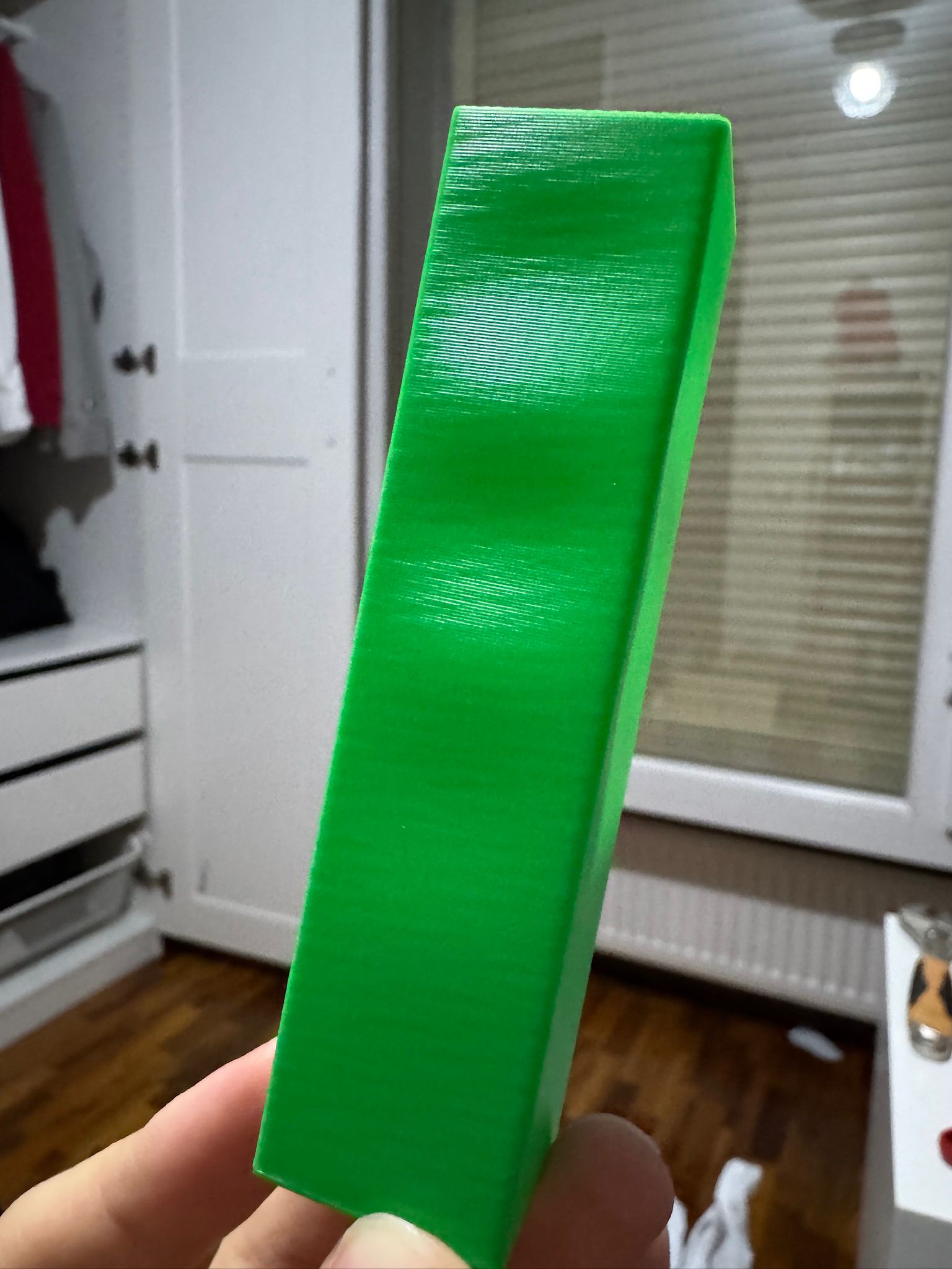

I got my first bambu lab A1 printer from metatechtr in june 12.I have upgraded from an Ender 3 V3 SE to a bambu lab A1. Then I turned on the printer and started printing things like benchy and sd card holder. While i was looking at the sd card holder i noticed some z wall defects on its z wall and it was banding.I printed xyz cubes and cylinders trying to solve issue by software but nothing did really helped.
So as any normal person would do i contacted reseller metatechtr about this (30.06.2025). They made me do belt calibration and bed tramming. I reprinted the model and it did not helped apart from making the model more clear with a bumpy surface finish.When i contacted them again about it they just said I did it wrong and made me do it few more times. Afterwards they told me that I send back the printer to them but a payment will be required which i was pissed as the defect wasn’t my fault at all and furious because the money they wanted was not a small amount. I declined the offer. They wanted me to retighten the hotend screws which also failed and every time I wrote to them about this and following issues but they were just so confident about the assumption that it was just my fault so it just went on and on. I wrote to them again and they wanted me to retighten the belts and do bed tramming again. After yet another fail they just did not believe I done it the correct way and asked me “Are you sure you did it correct?” or “Do it again just to be sure”. This went on for a very, very long time. After all that I went on and wrote about everything in one single message and stated that this defect had been happening since i opened the box and I did everything you guys said(AS SAID) and its still not working. I am not paying them anything. Maybe I could have overtightned the belts or idk perhaps I just missed something?

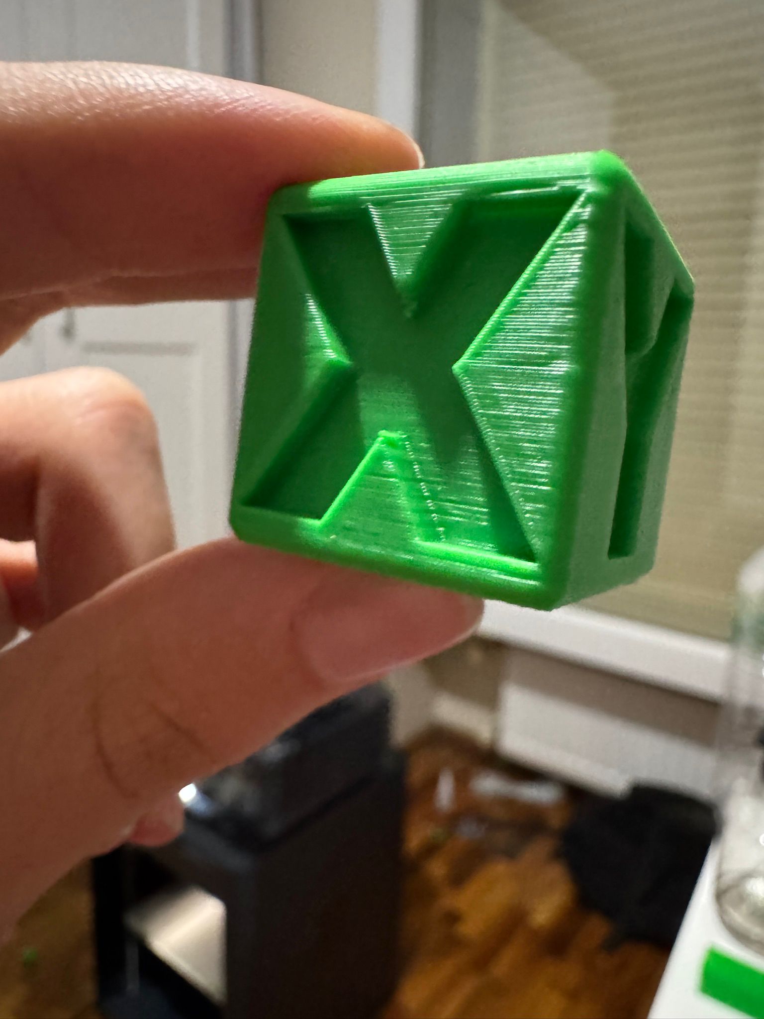

On the date of 26.09.2025. p1s arrived. I setted it up and printed some basic things like a benchy and a xyz cube to compare with ender3 v3 se. well that p1s … had z banding too
I retightened the belts a few more times and did bed tramming. I tried every single troubleshoot possible I just couldn’t convince myself that it had z banding at this point and how am i supposed to explain this at metatechtr now?? i tried
cleaned carbon rods on 99.9% Alcohol
regreased rods
oiled linear rods
retightened belts
did bed tramming
cleaned bed (i did not had any adhesion problems anyways)
In software:
calibrated filament
decreased temp
periodically lowered speed to 40mms
tried arachne walls
tried tuning down volumetric flow it was maybe just inconsistent extrusion?
increased layer time (for better and optimal line shrinkage)
infill wall overlap -5% , 0%, 5 %,10% (made it worse)
as a last ditch effort i tuned acceleration down to 500mms

Can one believe this? It came with z banding again. a faulty unit again and this time i dont even know what to feel about it. Its just empty feeling getting your tolerances ruined and your print quality so bad ender 3 v3 se really beats it up ???
so i did all over again did every single thing i did with my previous p1s
at least 3dteknomarket tech support was actually helpful they just wanted a picture and diagnosed the issue as z wobble told me to retighten the belts and do bed tramming i told them i already did it and just said send it back it was easy as of today 24.11.2025 i packed it up again and tomorrow i will give it to the cargo and send it back for a replacement (again)
