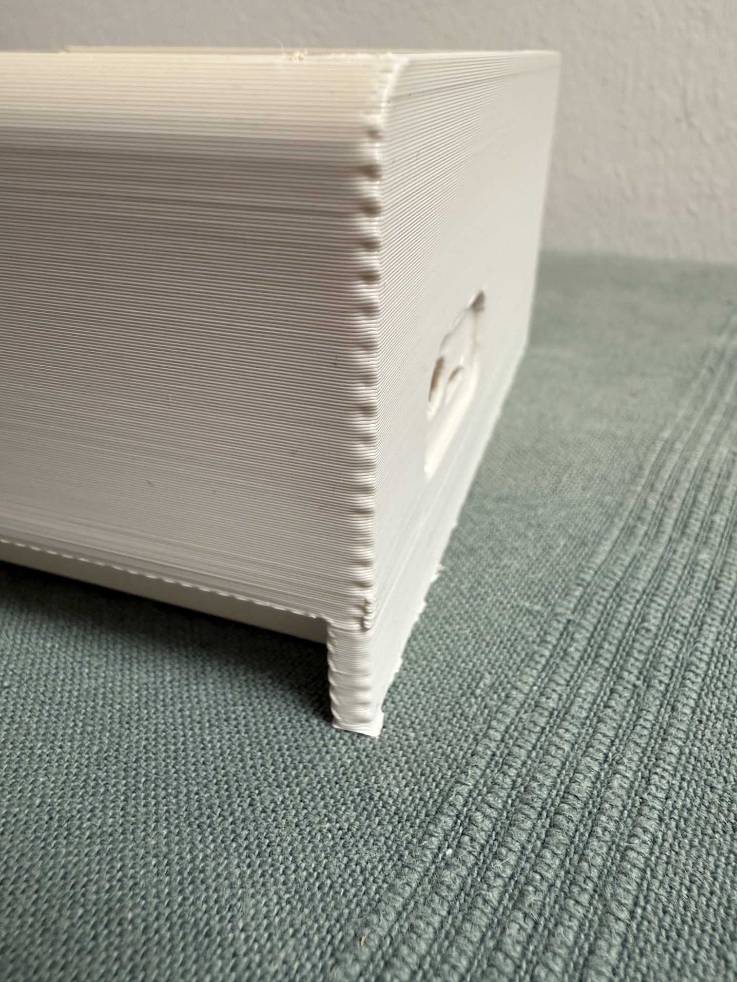

Hello, i have a serious issue at the corners of my print. (H2S with AMS2Pro, 0.6 HF Nozzle, Material: ASA).
There is a kind of wobble-pattern. The first prints with this new machine worked incredibly clean at the corners. But after a few printing hours (less than 50). I see more and more of these kind of corners. I did a complete calibration process, and also the first time a vision encoder calibration. I have the impression, that it got even worse since that point. Maybe its a mechanical problem, which was increased by the rough movements during calibration?. I can nearly exclude a damaged z axis, because in this case it should have been from the beginning, and i didnt move the printer since then.

Thanks for your reply. I tried some of your suggested parameters. I had screwed up speeds before, then i went down significantly, but the wobble stays. I will do some tests with PA too, as you suggested, but let me ask one question: Is it a typical sign for issues based on filament amount control, when the “waves” appear exactly every 10 layers - even, when the geometry is not the same in every layer? I thought, if its a problem of filament “squeezing”, it should appear somehow different in every layer, depending on the amount of filament missing or over extruding, caused by different geometries? It is very noticeable, that it occurs that rhytmically along the whole z-distance. I just want to exclude that it is a mechanical z-axis-issue…

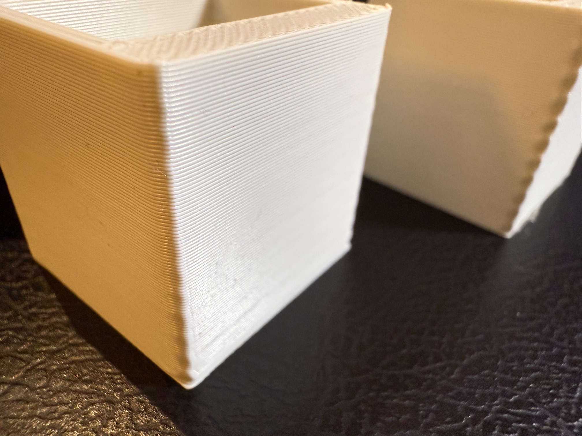

I did some test prints since my last post. It has nothing to do with the mechanics, because i could print a test file at higher speeds without wobbling. In the attachement you can find two test prints. One with and one without wobbling. I made several changes fitting to my larger print, so it is no solution swiotching back to the settings in the working test print. On the other hand i couldnt figure out which of the settings is responsible for the issue. If you compare the settings, maybe there is a genius out there who can?
The two imgages show the testprints. At the left one one can still see the artefacts, but way less than on the right side-

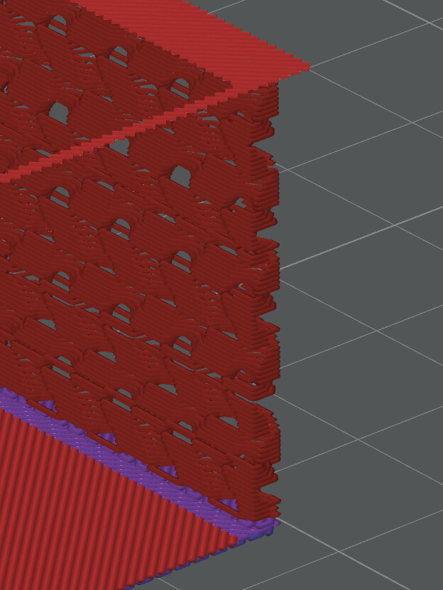

I dont have H2 printers, so take this with a grain of salt, but looking at your gcode atatchments:
At every “corner wobble” artifact is where your infill pattern alternates attaching to either the exterior wallgroup or the interior wallgroup.
X-ray showing infill, no walls
This being ASA, I’m pretty sure those are doing “Something Contraction-Related©” to your corners while hot, pulling them in as they cool. Try some different infill types, pay close attention to the preview patterns they want to make. Or no infill (4 walls at 0.6 is pretty tanky).
Hey, thanks for the brilliant x-ray- idea;-). I’m pretty sure that Gyroid causes the issue, showing repetitions in a similar pattern like the real print. It think you found the reason behind, but other settings seem to increase it dramatically, because as i mentioned, i could print a relatively ok cube with other settings but still with gyroid. i tried a next cube with the same settings like in the “wobble” file and only changed Arachne to classic and got a nearly perfect finish. next step i will try different infills and arachne swithed on again for cross-checking…

As you can see: no wobbling at all - but i must confess, this part is sanded afterwards. Nethertheless sanding would not have been the solution before, as the wobble were much bigger than sanding could equalize. So what finally helped:
  1. switching infill pattern to grid
  2. slightly slower speeds
compared to 0.4 nozzle and 0.2 layer hight i must say that i have still some slight wobbling, but maybe that is normal (i don’t have too much experience with 0.6 nozzle and 0.3 layer hight)
