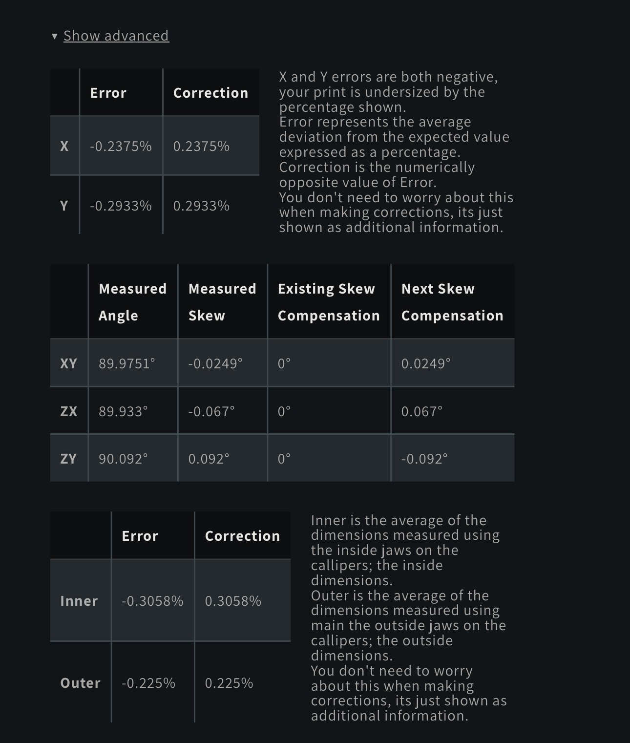

Hey all,
Let me preface by saying I don’t think this is a hardware issue but rather my settings. I just finished printing this awesome modular desk riser shelf - I tried it in both ABS and PLA. My issue is that the legs that print upward skew outward and are not square with with the horizontal bottom part. My device isn’t letting me upload pictures but I’ll try to edit the post when I get home.

But long story short, picture a capital “L” where the vertical part of the L is leaning left outwards. I don’t see warping in the classical sense of the edges lifting off the build plate but maybe I just can’t see it?
I’ve tried:
ABS and then PLA to rule out ABS being finicky
Re calibrating all of my printer and using motion accuracy calibration
Factory defaults and fresh calibration
Re-tramming the bed
Washing the build plate and trying another build plate
Considering they are kind of long and thin parts of the object, is this just a hurdle of FDM printing?
Thanks in advance!
it seem like its zy zx skew if you can run a vector3d calilantern and it will show you youre xy slew as well as the zy zx skew you will have to tram the bed a bit to compensate as there is no software copensation for zy zx skew just xy. there is a thread here talking about this very thing

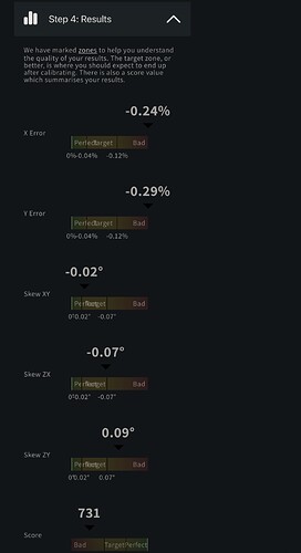

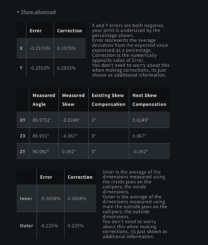

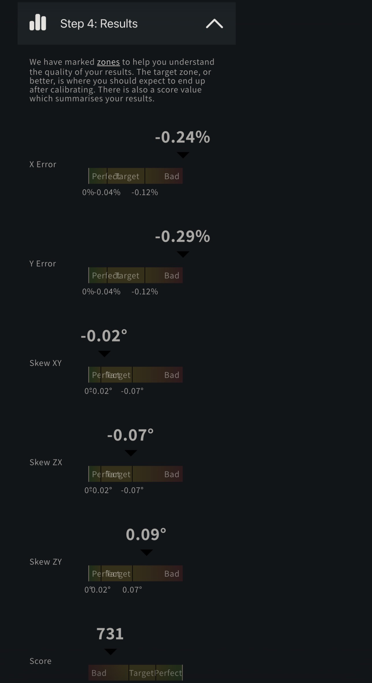

Alright did my test! I’m assuming for results this bad, I had to have messed up my print settings or caliper measurements. Will try again… curious what others have though.
This is not particularly bad. Anything less than 0.1° on a Core XY printer is good.
The ZY skew of 0.09° on a 300mm tall part is 0.47mm in Y and a ZX of -0.07° is 0.37mm in X so together thats around 0.60mm in total skew.

Hey thanks for chiming in! I guess I haven’t ran actual skew tests before and assumed the worst. Sounds like all of the “bad” ones are because Calilantern are incredibly strict for those trying to get things perfect?
Anyways I’m assuming in that case for roughly .60mm that the skew probably isn’t the source of my issues. It’s pretty visible on the models I’m printing. I’m trying to get good images but it’s hard to capture the leaning vertical wall in an image. I’m wondering maybe it’s the model design and the walls aren’t resilient to hold it at a straight 90 degree angle.
