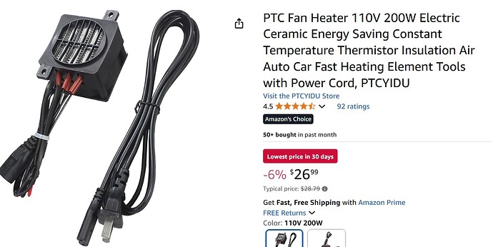

The housing consists of two parts – a front and a back – and is made of PA6-GF. It is mounted on the right inner wall without restricting the movement of the build plate. The images shown are simplified, as my prototype was a bit over-engineered.
I used this heater:
https://www.amazon.com/Temperature-Thermistor-Insulation-Conditioning-PTCYIDU/dp/B0BTLMNFB1?th=1
With it, the build chamber heats up quickly and quietly. I believe a 100-watt heater would have been sufficient as well.

Here’s how it works for me: The fan motor in the heater is rather weak and produces only a mild, barely noticeable airflow. Therefore, there’s no need for throttling. In fact, I consider the weak airflow an advantage — the air coming out is certainly well above 212 °F.
The temperature controller is very simple: when the set lower limit is undershot, it switches the heater on; when the upper limit is exceeded, it switches it off again. A more elegant solution would be dynamic control of the heating element, but that’s beyond my skills. So the real “art” is positioning the temperature sensor correctly inside the chamber. Based on gut feeling, I placed it a little higher on the left side next to the housing so it sits in the intake airflow. The picture shown in the post is misleading — the housing also has ventilation holes on the left side. With my setup, the control loop works very reliably.

Earlier I suggested that a 100-watt heater might be sufficient instead of a 200-watt unit. That was incorrect. In fact, even 200 watts is rather insufficient. At higher chamber temperatures, a lot of heat is lost through radiation from the aluminum housing. If you don’t want the heater running continuously but instead at about a 50% duty cycle during printing, you’ll only reach a chamber temperature of around 128 °F. However, this is already enough to noticeably improve print quality with ABS, ASA, and similar materials.
