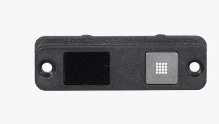

@maxim3D do you know what the new thing on the offset calibration piece does
Im not sure what “thing” you are referring to?
H2d:
H2C:
The center rectangle between the sensor and metal grill I can’t find anything about it could also just be a piece of plastic “also explains why we need a new one for upgrade”
