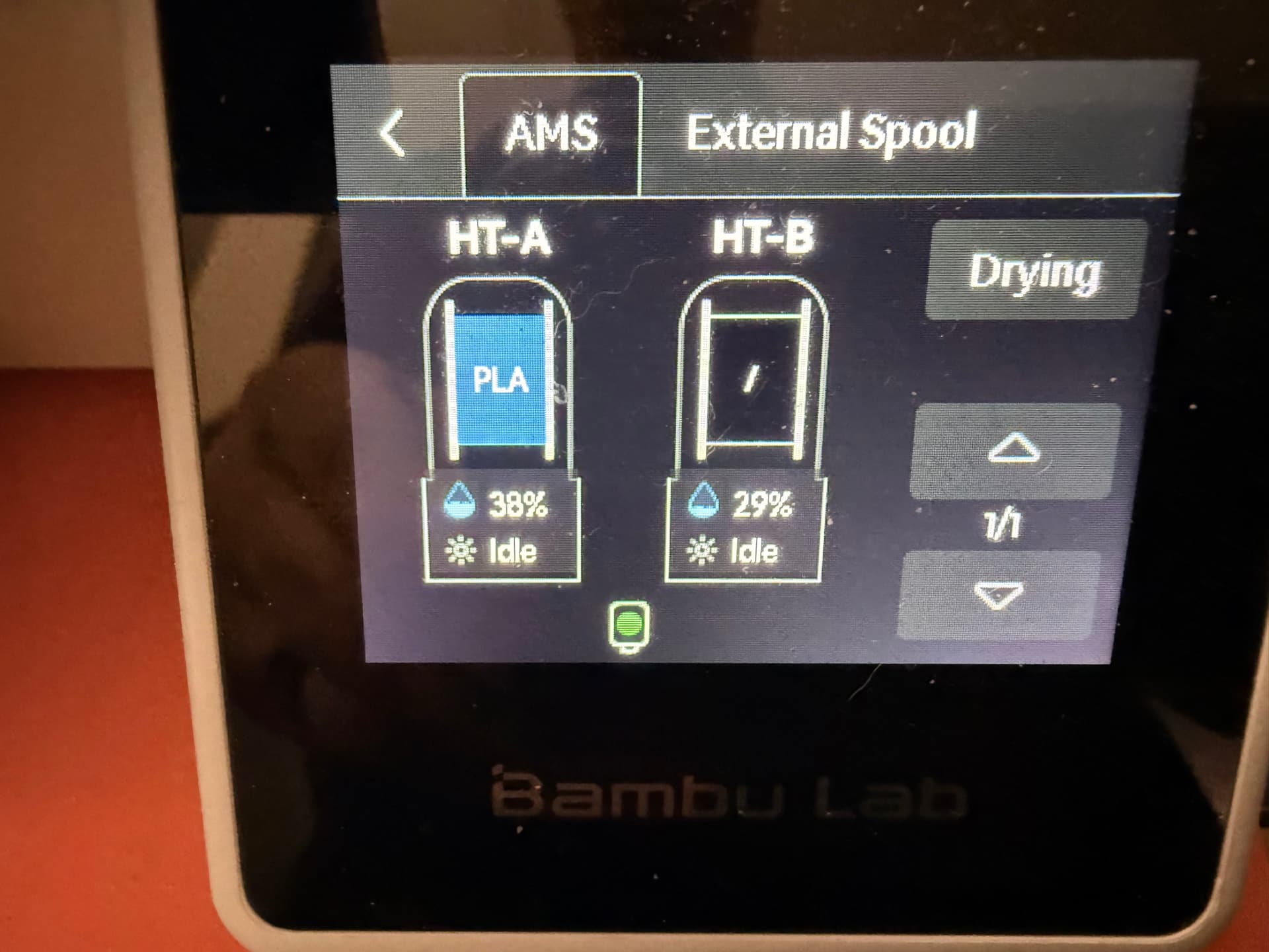

I just connected an AMS 2 and an HT to the mini and upgraded tot he correct firmware. The AMS 2 shows as just another HT.
Just a few minutes ago
Am I missing something?
How are you linking the ams units ? ht to ams / ams to ht ? to printers hub
I daisy just for this. My AMS is on another machine but the cable reached. HT to hub, AMS to HT. Maybe it’s different than AMS to hub and HT to AMS?
