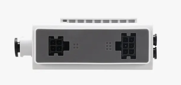

In anticipation of Bambu releasing the OTA update that allows the AMS HT to work with the A1, I received my HT today. I know i can use it as a passive spool holder via the TPU slot until the software released sometime in Q3.
I noticed that the bus cable supplied is a 6 pin and the A1 uses a four pin.
does anyone know if Bambu will have a 4-6 pin cable available to order before or at the software release?

It would be the wrong cable for the A1, correct cable for my X1C.
Hmm, concerning. I may have jumped the gun buying it then. They must need to sell a 6 pin to 4 pin to make it work, or perhaps a 6 to 4+4 to make it compatible. I assume that’ll be available when the firmware is done to run it.

Did you also purchase the required hub for the A1? AMS Hub - A1 Series | Bambu Lab US Store
I’m assuming that the A1 filament hub will have a 4-pin socket for the cable from the printer and a 6-pin socket for the cable to the AMS/AMS2/AMS HT. No 4-to-6 adapter cable necessary since you won’t be going from an AMS directly to the printer. Apparently we aren’t allowed to use our AMS Lite with the new AMS setup.
