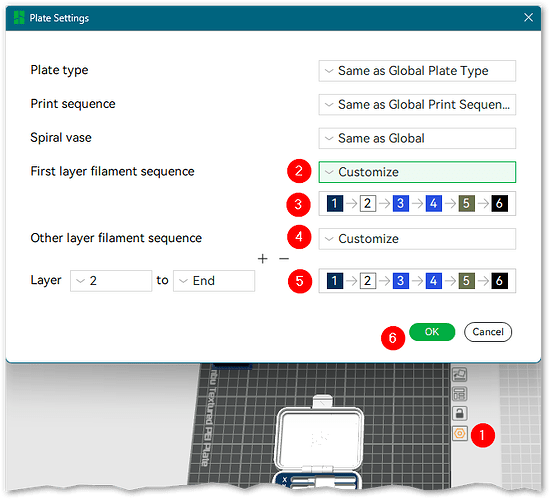

  2. The first layer deposited the white before the blue infill resulting in inconsistent blue line width and poor edges. I suspect that definition would be better if the graphics were printed first.

  2. Would you recommend printing the blue graphics first? How do I change the object print order?

  2. The filament print order can be changed on the Prepare screen.
  • Select the plate.
  • Click (1) “Customise the current plate”.
  • (2), etc.
Printing the blue infill first gave a great result.
