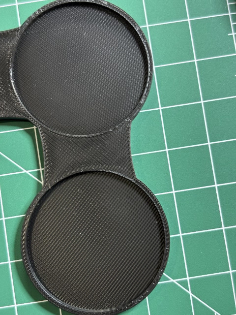

Coincidence or not, since I tried using a 0.2mm nozzle and then went back to my 0.4mm, quality degraded. Among other places, very noticeable in top layer. Where before I easily had smooth top surfaces, these are now quite rough. Also I see more defects in walls and more visible layer lines throughout. And while using a textured plate, my bottom layers aren’t bad but where I used to have a perfect bottom surface only showing the texture of the plate, I also see layer lines now.

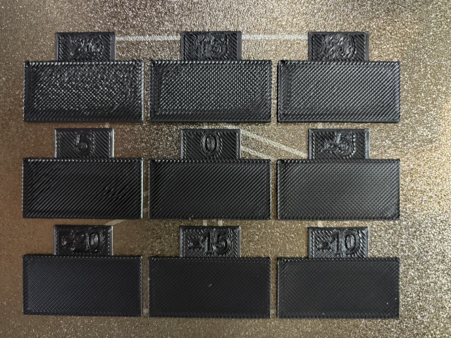

With certain infill types I hear the nozzle dragging against the infill, never happened before. I printed another flow ratio test and I just hear the nozzle dragging against some of the plates its printing. In the past I’ve ran multiple flow ratio tests and they always end up very close to 0. The one I just ran, all surfaces are just really rough, nothing like the flow ratio tests I got in the past. This is on a brand new spool, straight out of the box, freshly delivered.

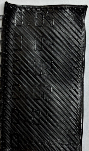

I ran a dynamic flow rate calibration and the part with the actual values look horrible. Dont mind the fact it’s deformed, I pulled it off while the plate was warm cause I saw how failed it looked.
Rough top layers
Layer lines visible, I’ve had seams before but never looking this bad

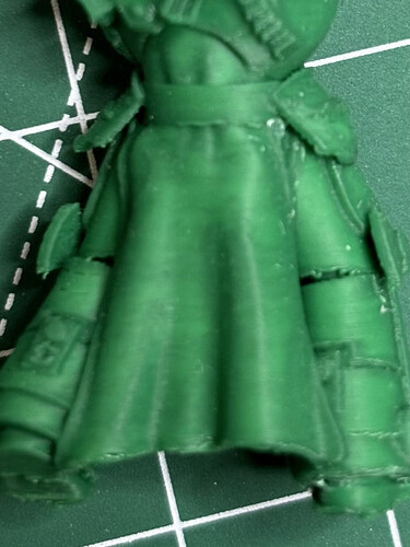

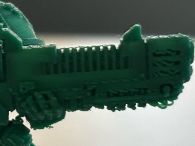

Out of the box, printing was ok except I had massive drooping (for lack of a correct term) on every small overhang. I ran calibrations and adjusted flow rate and while it’s better, it’s still not perfect. I still get some drooping but also there seem to be parts of the model where the PLA is lighter than other places. Again extrusion issues?
The dynamic flow rate test comes out very very thin and is really hard to read.

Loops or ‘drooping’ issue is visible here.
Color shift. Hard to see in the pictures but some parts of the model are clearly lighter than other. This also happens on this cloack for example wich is just on solid part that’s equally thick everywhere. Below the back of the knee, still some drooping.

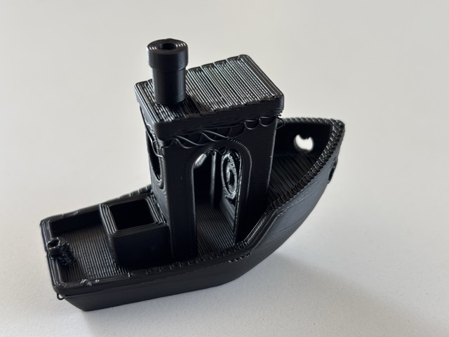

Update that might be relevant. Support asked me to print test files like a benchy and add those and something interesting happened. I now have the drooping issue on my 0.4mm nozzle as well. This is the result showing the drooping and the fact that top layers are again really rough:
Again, this is on a completely factory reset printer with a brand new PLA spool.
