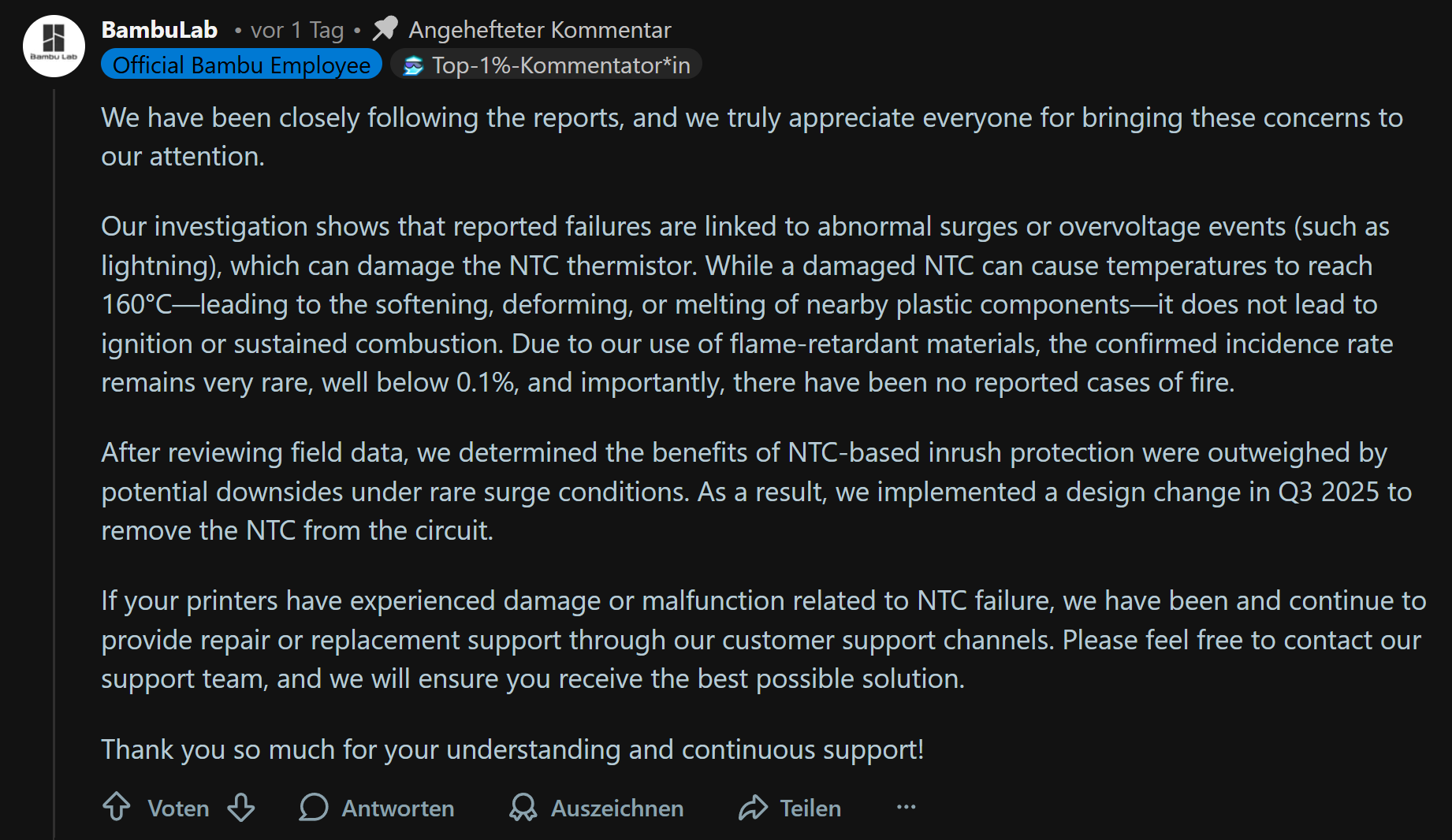

Bambu recently posted another statement. We have read something similar before and much of it is repetitive. Here is the latest version, which goes into much greater detail:
We have been closely following the reports, and we truly appreciate everyone for bringing these concerns to our attention.
Our investigation shows that reported failures are linked to abnormal surges or overvoltage events (such as lightning), which can damage the NTC thermistor. While a damaged NTC can cause temperatures to reach 160°C—leading to the softening, deforming, or melting of nearby plastic components—it does not lead to ignition or sustained combustion. Due to our use of flame-retardant materials, the confirmed incidence rate remains very rare, well below 0.1%, and importantly, there have been no reported cases of fire.
After reviewing field data, we determined the benefits of NTC-based inrush protection were outweighed by potential downsides under rare surge conditions. As a result, we implemented a design change in Q3 2025 to remove the NTC from the circuit.
If your printers have experienced damage or malfunction related to NTC failure, we have been and continue to provide repair or replacement support through our customer support channels. Please feel free to contact our support team, and we will ensure you receive the best possible solution.
Thank you so much for your understanding and continuous support!

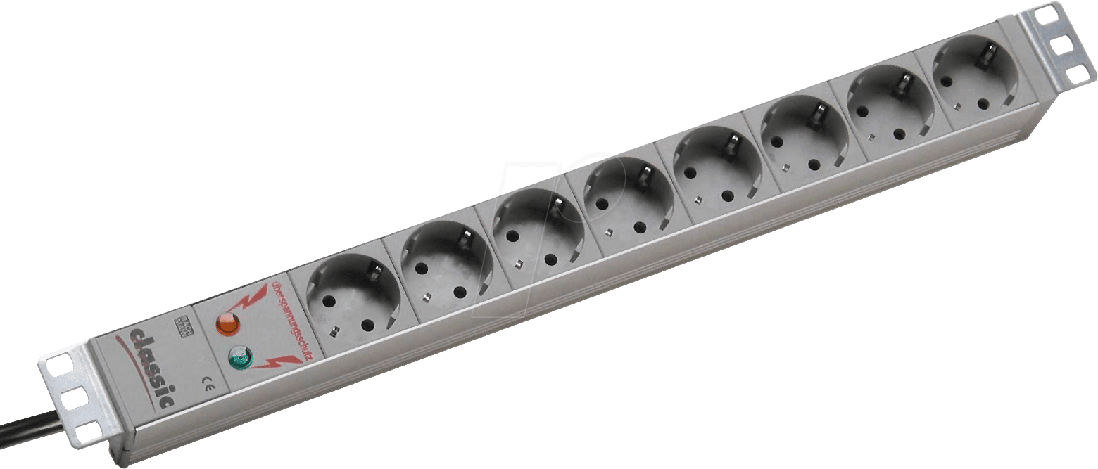

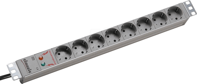

I know that was meant sarcastically, but to answer the question: That’s what Bambu recommends, as do other hardware manufacturers in general - whether Sony, Samsung, LG, or whatever - and what every household and workshop should have. Also on your PC, TV, coffee machine, whatever.
Any electronic device can start catching fire without such protection.
Lightning and overvoltage protection:
Zeus in particular.
No sarcasm intended. While it doesn’t mean it negates insurance coverage in the U.S. anyway damage by something like lightening is classified as an act of god and can potentially impact any settlement.
Just sacrifice a sheep once a year - problem solved. :rofl:

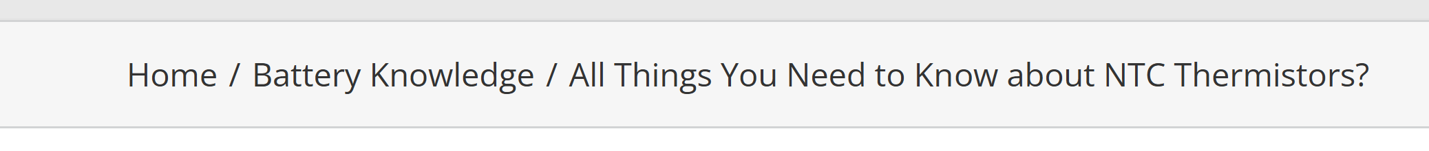

From

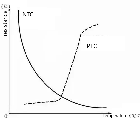

Disadvantages of NTC Thermistors
NTC thermistors in series at the input terminal can play a role in suppressing excessive current, but NTC also has inherent disadvantages.
First of all, NTC is connected in series in a circuit. Although its resistance value will decrease and maintain a lower resistance value after normal operation, it will still cause the circuit voltage to drop. This has a negative impact on the efficiency of the power supply.
The other is that NTC has thermal inertia. When the charger is working normally, the temperature rises and heats up, and it is plugged back in immediately after unplugging. The NTC is not cooled, and it is still at high temperature, so it can’t suppress the current. At this time, the current will be very large, and the charger that does not usually have sparks will also have sparks.
Edit: yes, this is oriented toward Lith battery chargers, but the principle of the component is the same.
There’s no point in copying the text now, because it doesn’t address the “smooth start” function. Other applications. Believe me, the data sheet for the thermistors and the function have now been analyzed to death. Read through the topic.
Furthermore, the report refers to lithium batteries, not 3D printers.
Edit: Here is the link that explains it.

NTC Thermistor: Such a thermistor is highly resistant at first and lowers its resistance as it gets heated by the current flow. It handles the sudden rise in current and changes itself to maintain the flow. The 10D-9 and 20D-11 are widely used types of electric cars.
The thermistor only gets hot when the 3D printer starts up, during the first few seconds, and only if the heating bed is cold or there are voltage fluctuations in the grid.
After that, the thermistor cooled down again and is now just warm. That is also the basic function of the thermistor - to convert excess energy that occurs in seconds into heat. That’s why it doesn’t need cooling, because we’re talking about seconds or less. In contrast to thyristor, for example, which often need constant cooling in the form of a heat sink.
