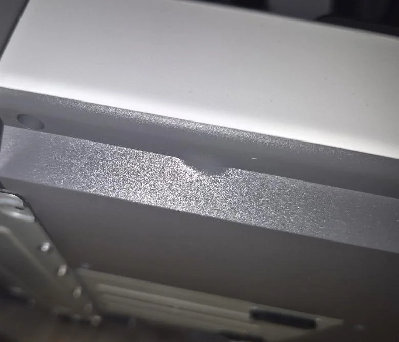

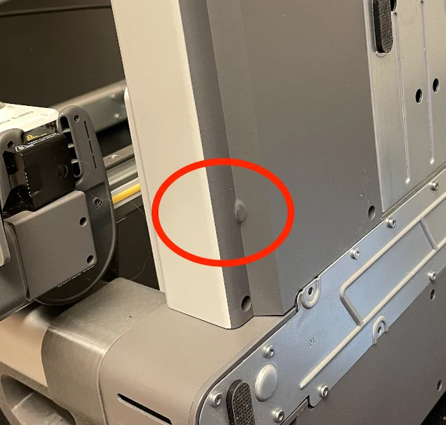

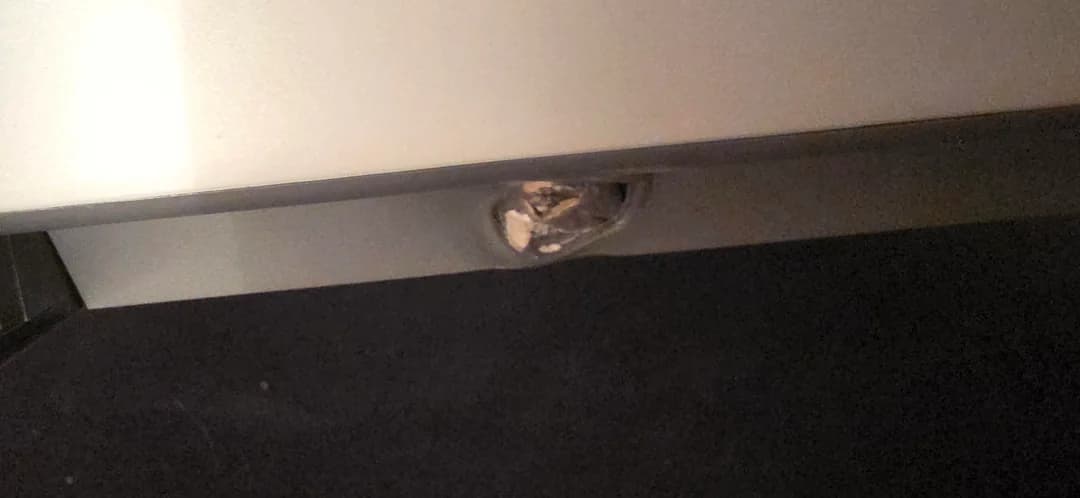

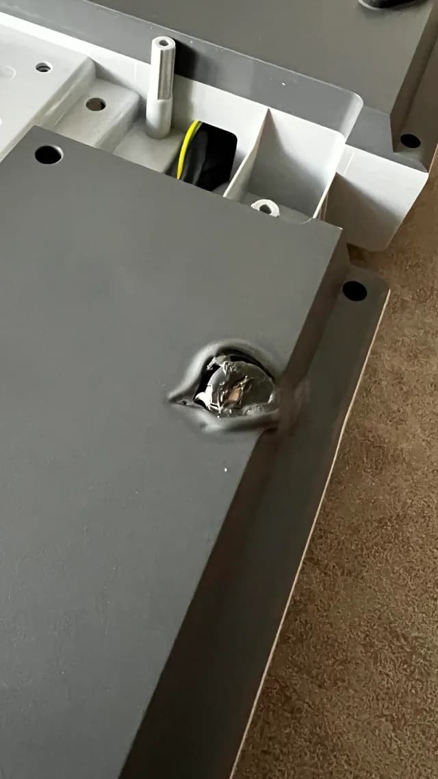

Below are some photos from various sources showing what smouldering looks like. Just to clarify what most users mean when they say “My printer caught fire.” Of course that shouldn’t happen.

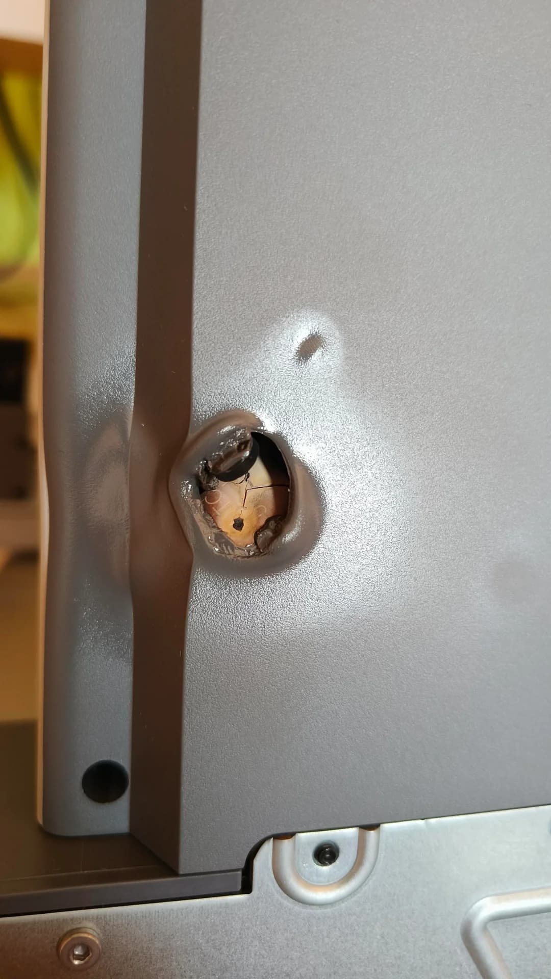

Just to clarify. There have been many many examples that have been more serious than that.
There have been just as many or more examples of the plastic burning all the way through.
It is also important to point out that most of these incidents are not reported on public forums. We will never know the true numbers.

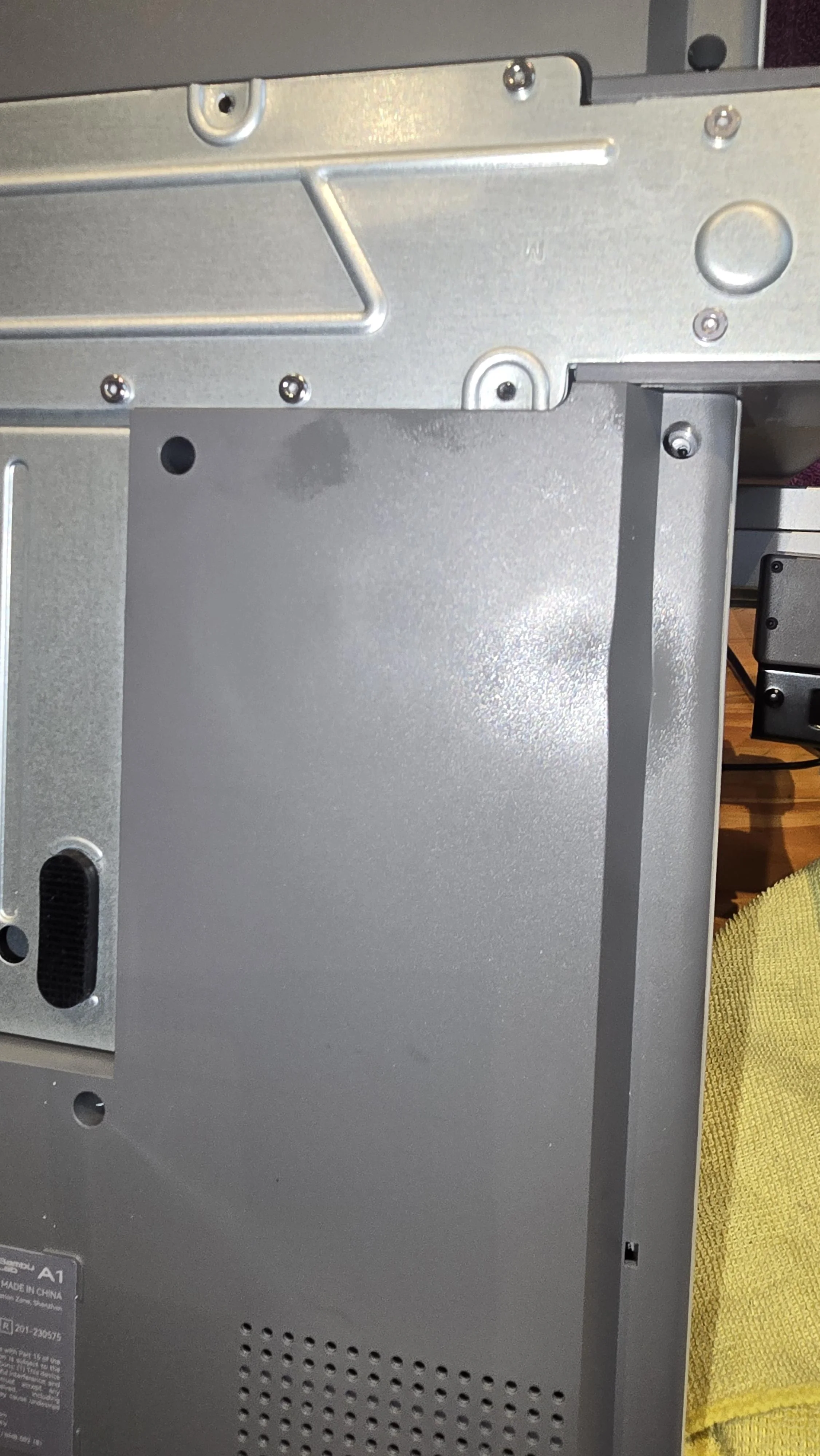

Yep, it looks like the housing is fireproof; at least I don’t see any fire. Which is at least some good news. If it were cheap plastic, it would have burned completely.

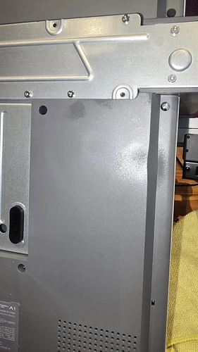

This shot is too close. For what I can say, those may be even the cigarette burns :joy:
Maybe there’s an issue where plastic is too close to the heated element, but it doesn’t necessarily mean that the component is failing. I’d like to see more of the context. Finally, RMA those and get it over with. If enough people RMA their stuff, maybe Bambu will admit their mistake and recall those at scale.

Does the charring and soot not give away that there was a small thermal incident?
It is obvious that they are using flame retardant material, but it is also obvious that the material specifications are being exceeded.

All of the examples I listed are from reddit. Real customers will real machines.

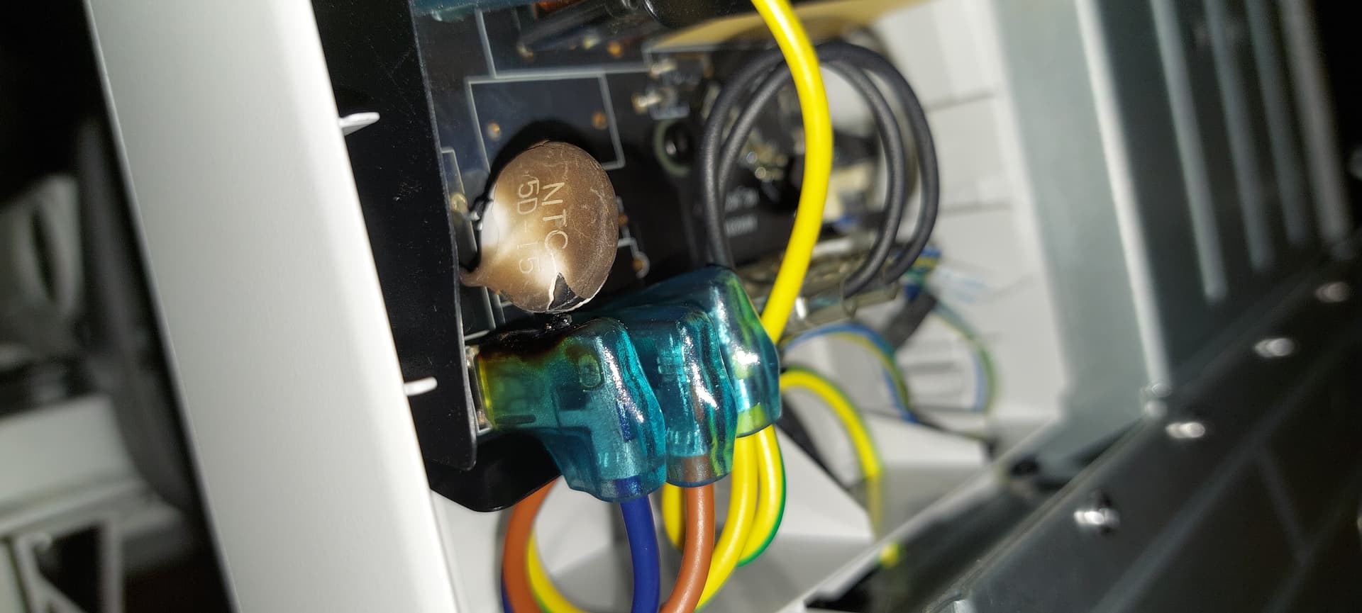

Am I understanding correctly that the failure is in the power supply component?

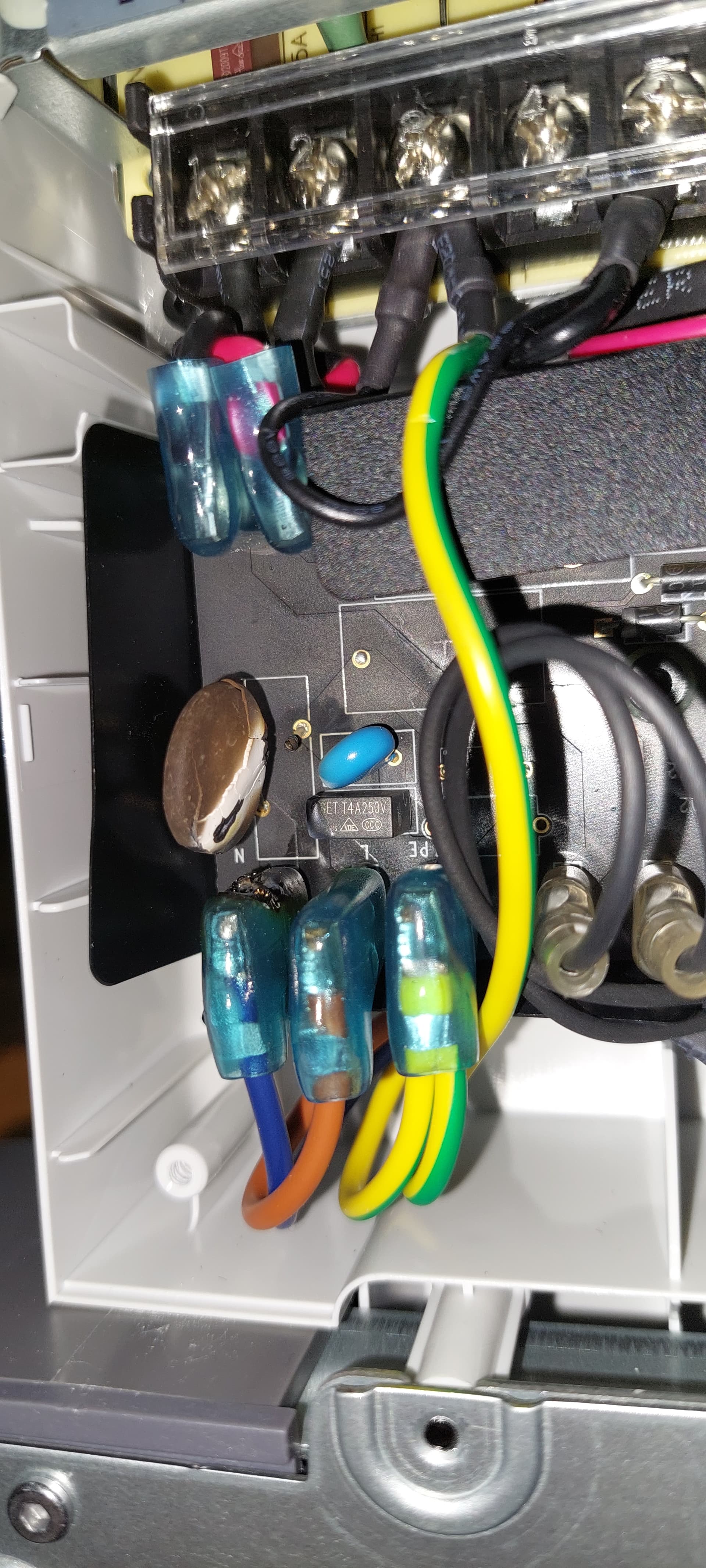

Edit: Photos posted below show the NTC outside of the PSU, not within it.
Without intending to diminish the potential severity of the issue, this is a component that is certified to meet reasonable safety standards (the backwards “RU” is UL’s “Recognized Component” certification, with safety certifications for CE, CB, and China shown) and not a board designed or fabricated by Bambu. The PSU has a specified operating temperature of up to 50° C (122° F) with no derating and derates linearly to 60% at 70° C (158 °F).

He has more boards, and more incoming.
It is in the comment section in his videos you see people saying they had the same issue. Here are a few more pictures.
MrDontCare’s photos strongly suggest it’s not encased in a metal power supply enclosure. Just sayin’ so we can all get on the same page.
My mistake, thanks for the photos! :+1:
So… there are actually two thermistors. One in the power supply and, as the photos show, one outside on the circuit board. So no metal housing after all. That’s… not good.
Add to that the heat build-up from the power supply, and it’s not a good combination. Okay, that’s just… silly. Of course the thermistors gets hot, that’s what it’s designed to do, react to heat, and then it’s so close to the housing without any metal protection? - and next to the power supply, which probably produces heat build-up. Ugh…
I have decided to delete the comment regarding the power supply. That was clearly my mistake, as I thought the circuit board was installed in the power supply. To avoid confusion, I deleted the old post. Anyone who wants to read it can still make it visible again. I just want to avoid confusion now. My mistake! Sorry! :heart:
Well, kill me if this is not the exact same board from the video :smile:
The scorch mark on the capacitor looks identical, but let us not jump to conclusions.
In that YouTube video, he showed the board without an NTC. The blue component is actually a MOV (varistor), and it is part of the mains protection. That was my first red flag, right next to the capacitor mix-up. I kept thinking, “Is he absolutely sure that is an NTC?” Then he pulled up the datasheet and convinced me. Still, the whole presentation made me start doubting his credibility.
