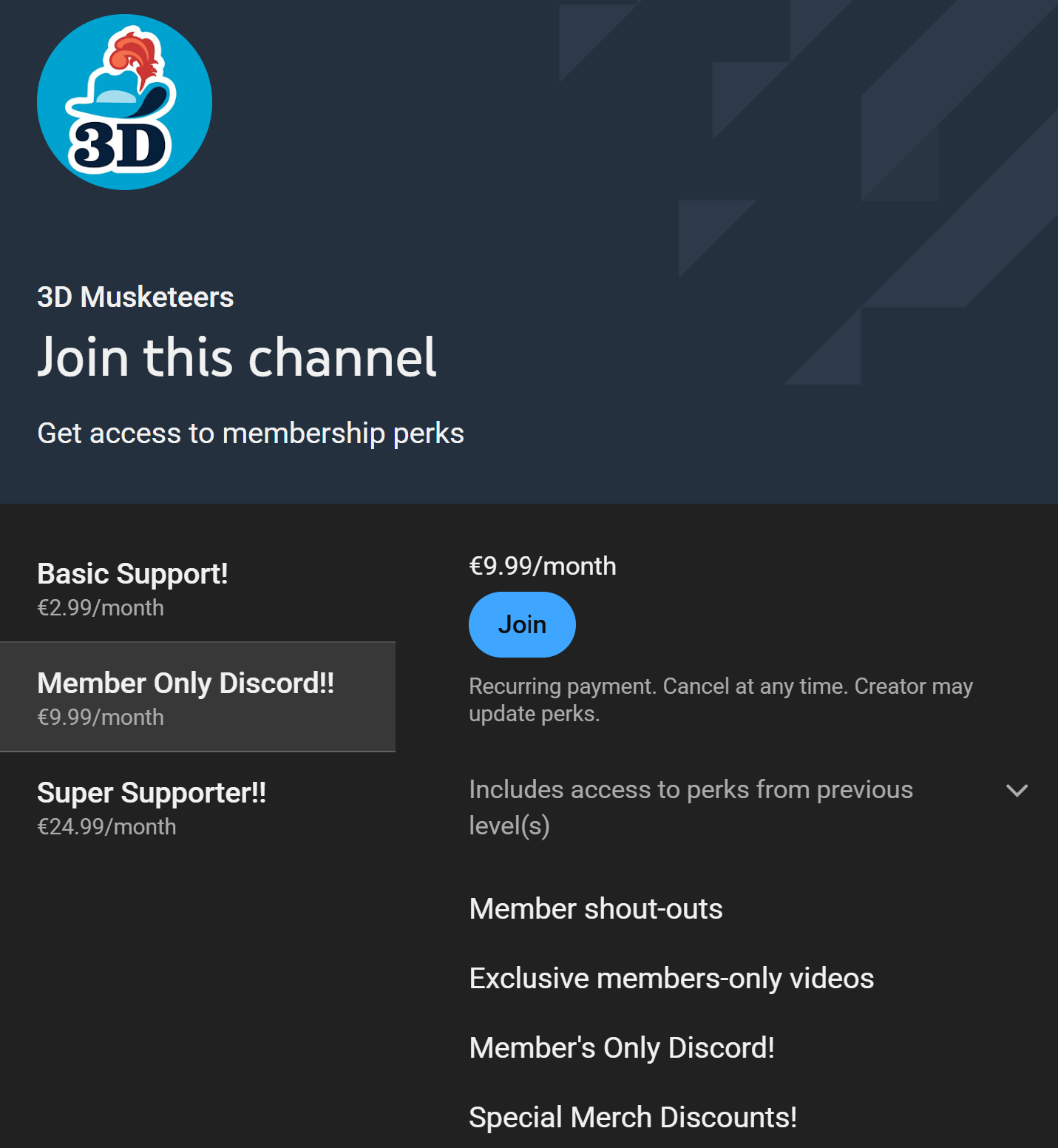

There’s no reason to think 3D Musketeers is using this video to increase his membership. I take the warning seriously. I recently sold my A1 but I contacted the new owner about it.

Come on… he’s even promoting his membership as well as his own company in this video. :rofl: Your argument would have been so good without that sentence. :+1:

Well, I’m not saying that there was no encouragement to subscribe. Everyone does that. But surely you don’t think he fabricated the bit about the fire hazard. Or do you?
