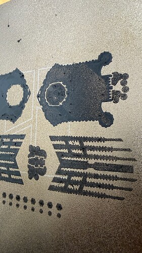

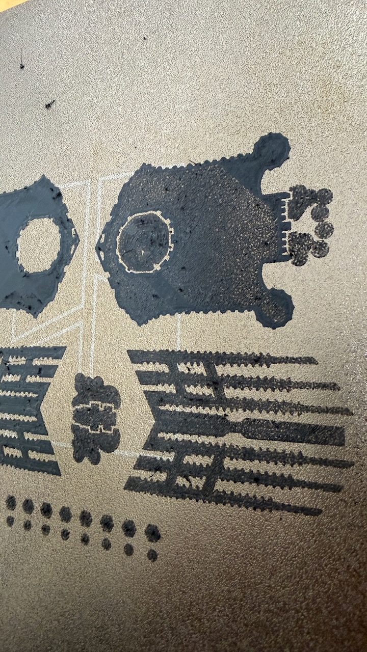

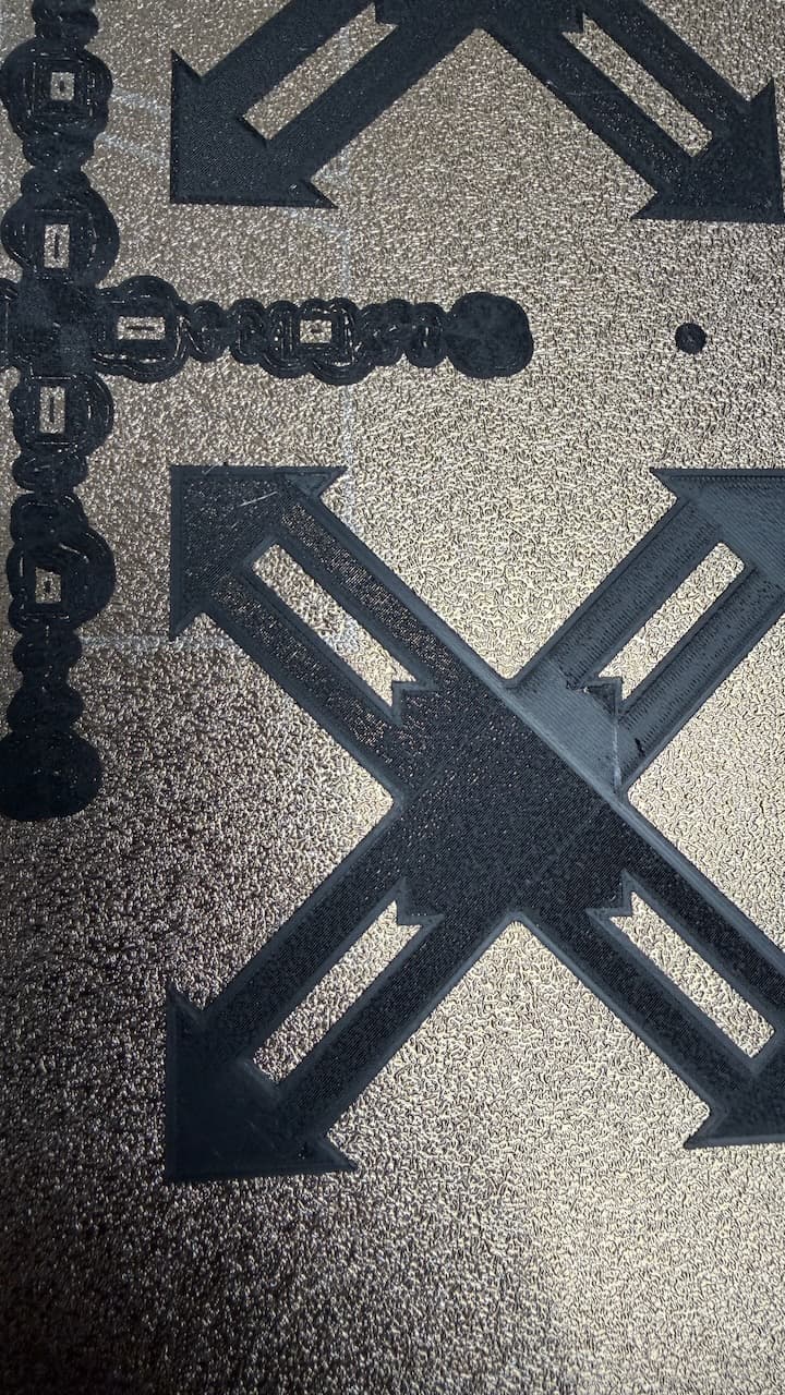

Having a bit of a perplexing time with a Bambu A1 with ~800 hours on it. Been great until I switched to a .2 nozzle. After doing so, it printed great and was quite impressive until a print seemed to have an issue after the first 2 layers (see picture). The print was still running, but the filament was not being pulled in from the AMS, even though the extruder seemed to be working correctly. When I stopped it, the filament was ‘stuck’ in the extruder, and the auto procedure to unload the Bambu filament would not complete. I had to gently help it unload during the unload procedure by manually flowing the filament through the extruder via the front panel to get it out of the extruder. Once free, the filament that was in the extruder seemed stretched, but I am not sure from what.
Took the nozzle out, cleaned the extruder as best as possible, ran filament manually through via controls on front panel without issue. Filament flowed steadily and no issues. Verified locking clasp is closing and locking correctly, and screws are tight on the back of the heating element. Calibrated throughout all the tests below and cleaned the build plate each time.
  • Tried different Bambu filament with the same file.
  • The same event occurred at a different point in the print but early in the layers (<layer 4). Same process to unstick the filament, same stretched filament, although it was easier to get out.
  • Took the nozzle out, cleaned the extruder as best as possible, ran filament manually through via controls on front panel without issue. Filament flowed steadily, and no issues.
  • Attempted print again with the same second Bambu filament and it printed without issue - success.
  • Printed a different file with original filament - and it printed without issue - success.
  • Attempted original file again with the original filament, and it printed without issue - success.
  • Then tried a different file with the original filament, and the same failure event occurred. Cleaned up and removed filament like above.
  • Attempted the same new file, failure event occurred again in the same way. Same process to unstick the filament, same stretched filament, although it was easier to get out.

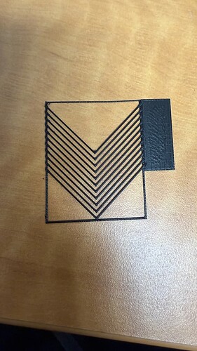

  • Then, I completed a filament flow calibration, which worked perfectly, and adjusted the flow rate as explained in the wiki.

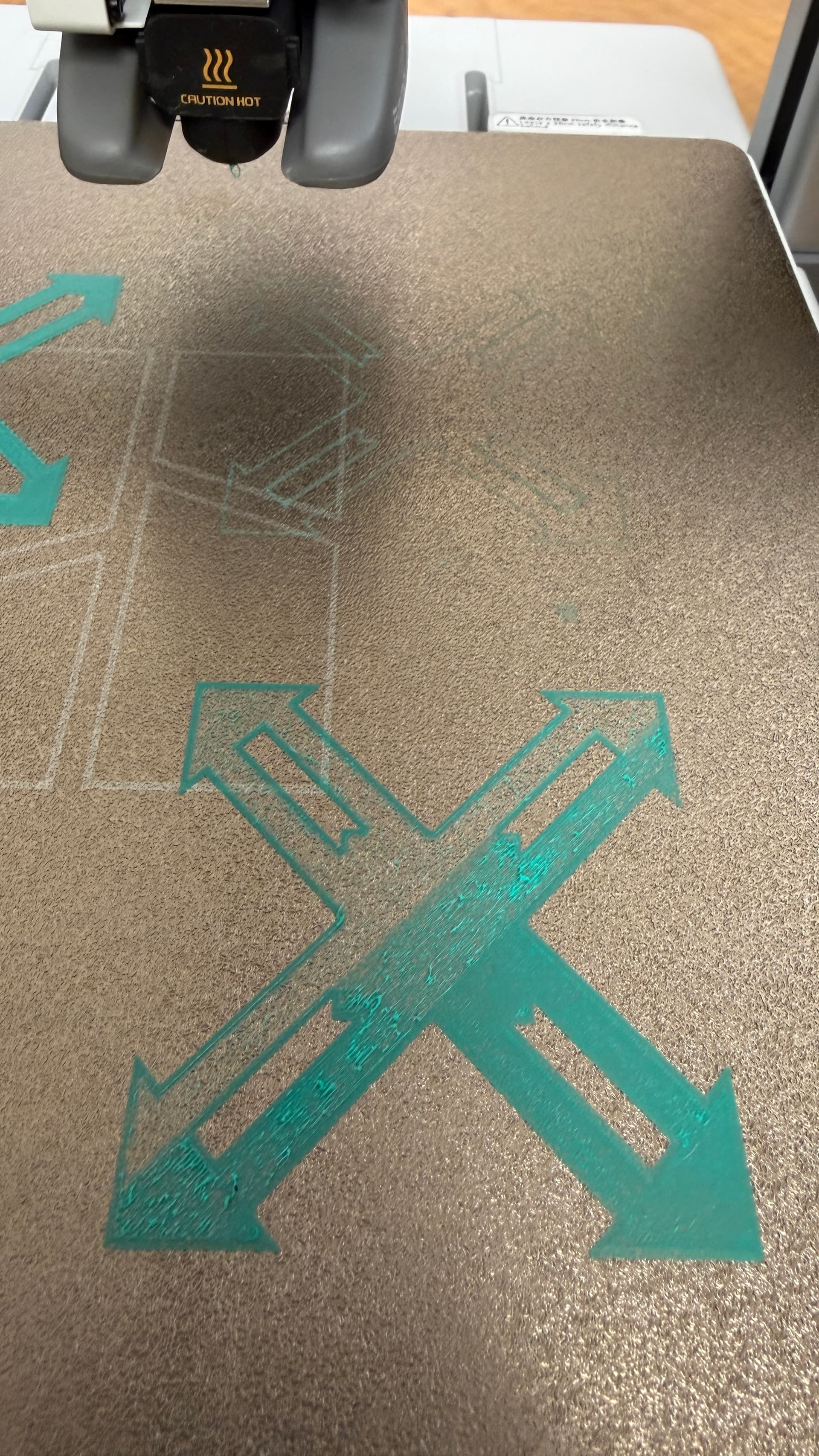

  • Tried another file with the same Bambu filament. The same thing occurred - stuck, but print kept running as normal, just no filament flow. Harder to get the filament out, but eventually succeeded.
Any guidance here? The issue happens with different Bambu filaments and different files, but also succeeds intermittently with the same files. When it fails, the machine has no idea, even though it’s not pulling any filament, and it fails very early on. I have three A1s and PS1, and this is the first time I have run into this.

Thanks for the feedback!
I did the calibration as you mentioned and the flow calibration (Noted above).
I dried all the filament at the start. Not sure why it would work and then not if this was related.
Only using presets from Bambu.
Haven’t messed with speeds, but again, sometimes it works and then it doesn’t.
The loose wiring may be related, I can’t find any when I cleaned everything I checked. Odd thing is the intermittency, but that issue works both ways. :wink:

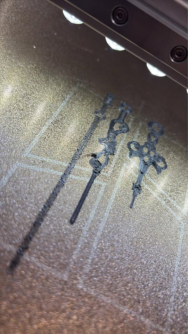

Same thing happened a few minutes after the original post. New file same printer. Hoping for ideas as this makes no sense.

Is the filament on the spool snagging?
This could be a spool that has the filament snagged or too tight.
This could explain the hit and miss as it would normally affect one section of the width of the spool.

Thanks for the ideas.
Thought of the spool sticking first time it happened. Checked and no issues. Even still I had tried exactly what you said after the fail and it didn’t change. When I used different filament on different AMS position it still happened so don’t think this was the issue.
Like was mentioned, the failed print didn’t work, then did on new filament and eventually on the same filament. Very inconsistent.
Felt this could be the feeder gears failing but when the flow calibration worked flawlessly I figured that cant be it. Seems odd that it fails like this always in the initial few layers.

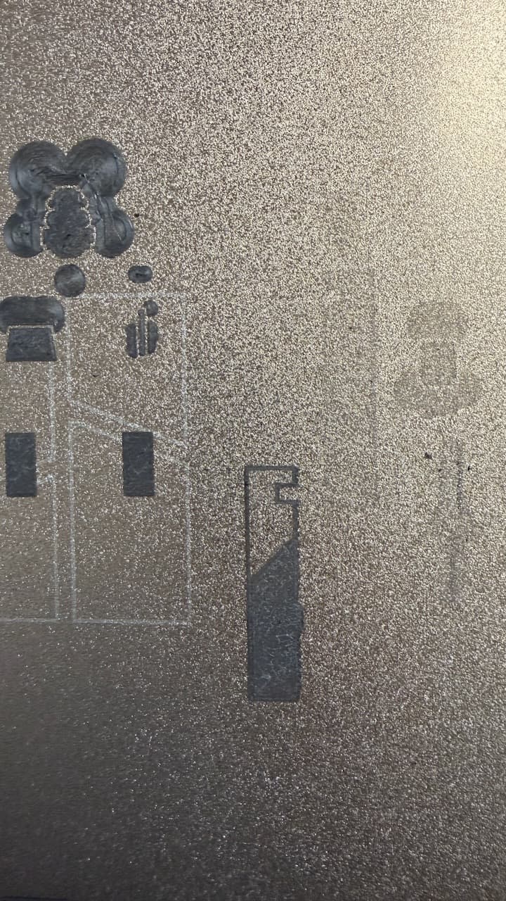

Thanks! Yeah, that fb link has all the things i thought of and/or found too, doublechecked the clip even. I did the manual flow test today (the pic I showed) and still had a file fail in same way after that.

Nope. The issue is not Matte vs normal PLA. Couldn’t make it past first layer.

FWIW, I did one more test before I was going to tear down the extruder on the machine. I took the same .2 nozzle and matte filament, but both into one of my other A1s, and it printed one of the failing files perfectly. I tried it a few times, and every time was perfect.
Certainly leans toward it being in the extruder/assembly. Not sure which is easier, just replacing the entire extruder or the extruder gear, but it seems to be where the issue is at this stage.
