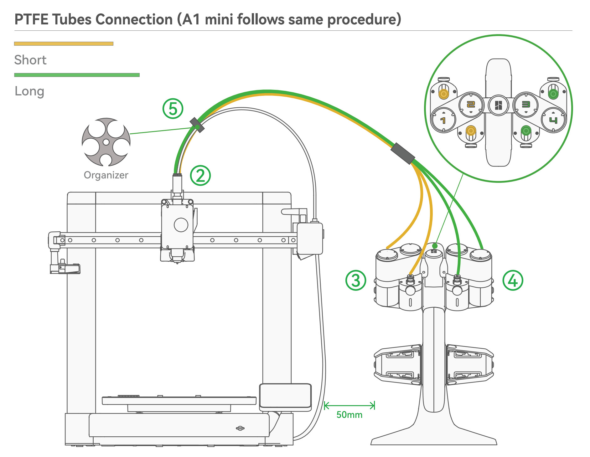

TLDR: The tubes were too short and/or the AMS was positioned too far to the right. It is, of course, important to set up the long and short tubes as specified in the instructions. Also use the recommended distance of 50mm.

Just measured, A1 Mini + AMS - delivered separately, not combo - device from May 2025 -(please note the edit!)
  • The long ones 85 - 86 cm (green in the operating manual)
  • The short ones 75 - 76 cm (yellow in the operating manual)
How long were your two short tubes (yellow operating manual) and how long were your two long tubes (green operating manual)?
[ Edit ] - However, I believe I have identified the reason for the varying lengths:
The length of the PTFE tubes included with the AMS Lite unit corresponds to the dimensions of the A1 combo, specifically 730mm * 2 and 850mm * 2. However, for the A1 Mini combo, the PTFE tube specifications are 580mm * 2 and 700mm * 2. If you intend to use the AMS Lite with the A1 Mini, it is advisable to adjust the position of the tubes or cut them shorter. Excessively long tubing can elevate resistance during loading and unloading, potentially leading to false filament entanglement detection alarms.

I’m out of the discussion. The most important question that would help everyone here wasn’t answered by you: how long are your tubes? That would help beginners measure it themselves.
Please bear in mind that what I post is intended for all newcomers, not just you personally. This is a forum. Newcomers read this topic. It was never only about your personal setup. However, you also ignored why the tubes are of varying lengths. I’m out here, and goodbye.

The new tubes were:
Short: 60cm
Long: 71cm
