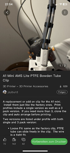

Today I printed a ring for the tubes that holds the four tubes from the Ams properly. Everything has been running smoothly since then. Thanks for the helpful tips
Could you share a image? Curious what you have there.
