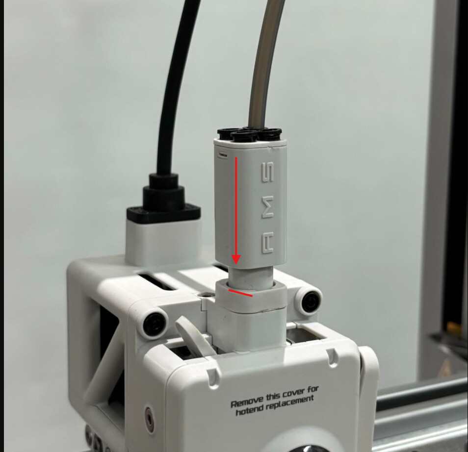

Your extruder gear is probably worn out. As I said, probably! I can only guess, but you can check this relatively easily. You don’t have to replace it right away, just take a look inside and clean it if necessary.
Also check your PTFE tubes to make sure they are not crimped, the angle is not too steep, and the ends are not properly seated. Although it is highly unlikely based on your description of the error, since you are already checking the tool head, it is only one more step.

What does your PTFE look like? I mean the internal diameter, does it show wear? Does it have any sharp(is) angles? Have you tried different holes in the 4-1 at the top of the spool head?
I changed the PTFE last week to a new one (cause the SV06 needed a new one and there was 0.8m left).
Also, trying all holes with the same result.

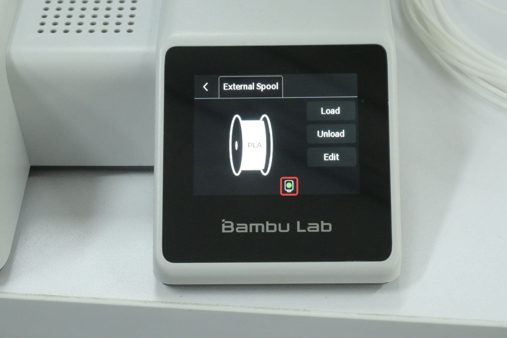

After 1500 hours with the A1 Mini, I use the following technique:
Gently push the filament hub with one hand, and with the other hand push the filament toward the toolhead.
You can feel the filament slip into the gear, and you should also see the green light.
After that, release the hub and click Load.
It works like a charm for me — 100%.
Thanks. After trying this method, seems to work as designed. Lol. Probably in an unread section of the manual. (Palm to forehead).
