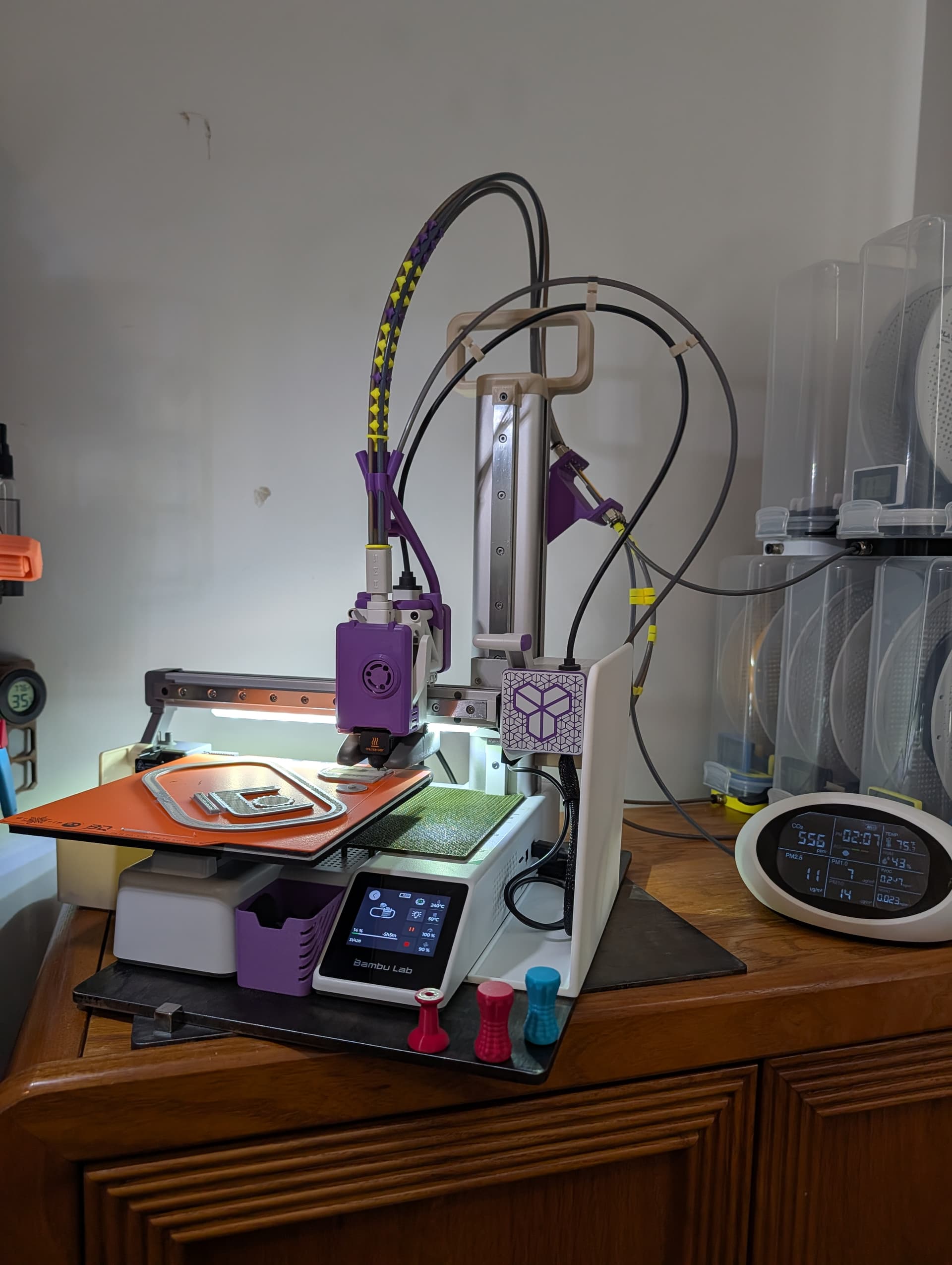

A photo of my current printer + MMS setup for context:
