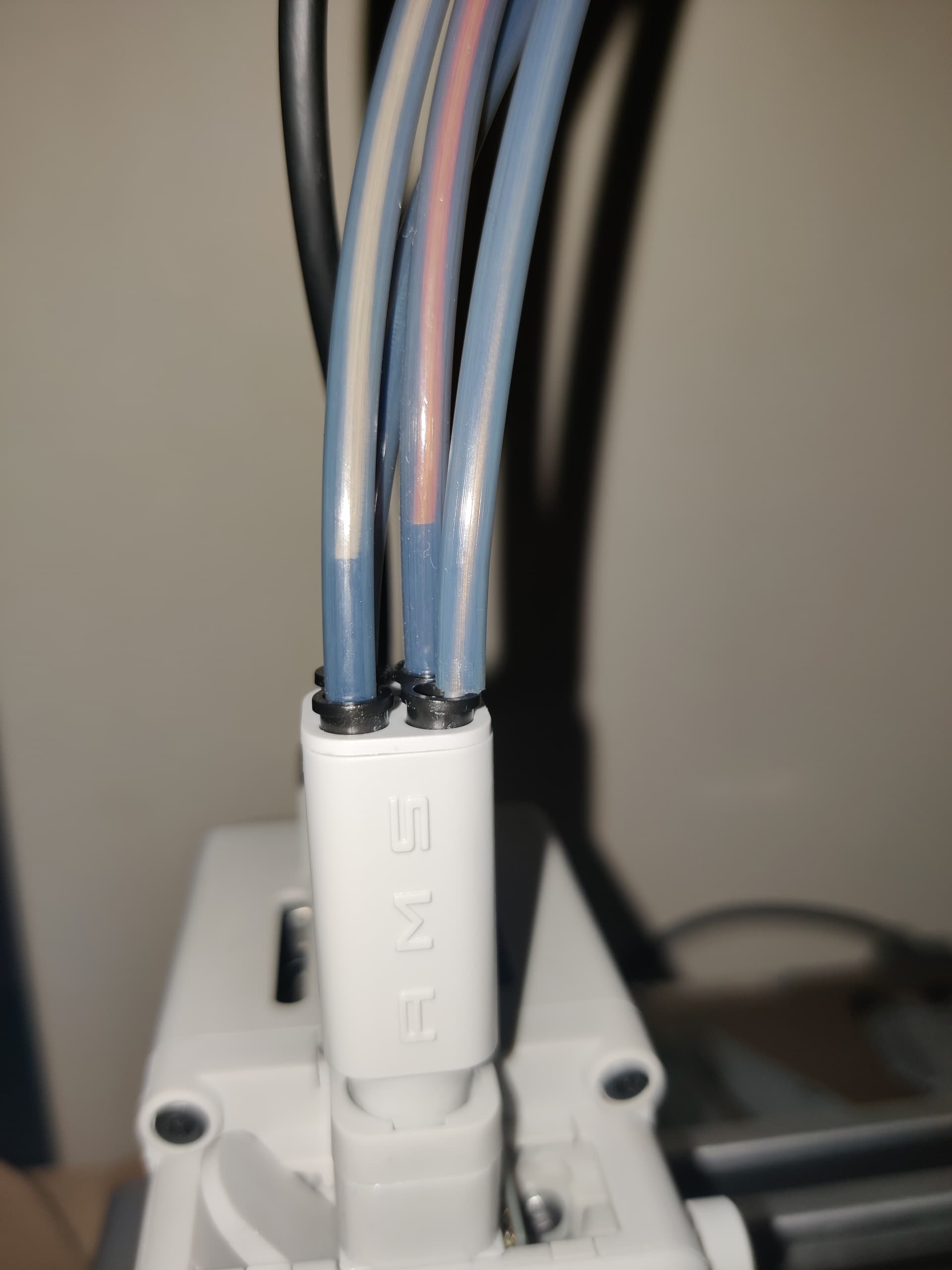

A1 mini ptfe tube disconnecting when filament gets retracted
one specific ptfe tube just randomly started disconnecting whenever the filament retracted and I dont know why, the printer is basically brand new only a month old and for whatever reason it just doesn’t connect properly.
does anyone else have this problem?
should I replace the whole ams hub thingy where the tubes connect on the toolhead or the ptfe tube itself?

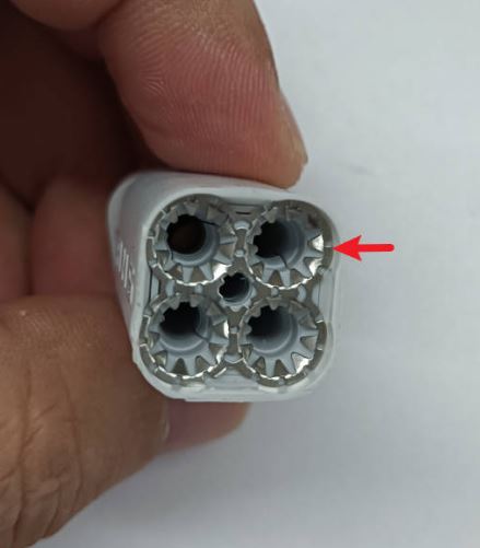

This should help.
Bend the clips till the tube is tight.
