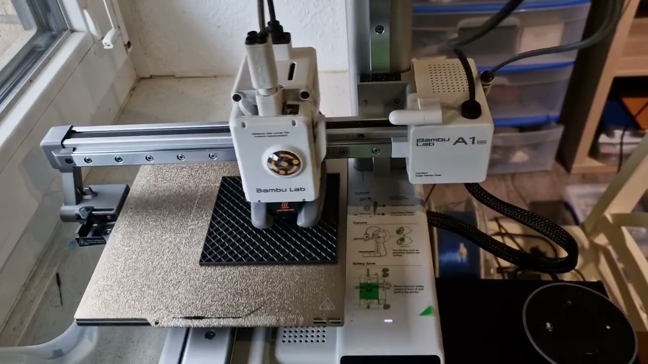

Hello Community,
my A1 Mini starts to rattle after 3 Weeks. I do not know where it come from. Everything seams to be tight and have no play. Here is the Video:
Have someone an Idea?
Thank you for your help

Hard to hear…I hear the fan & the nozzle hitting the infill…but no rattle.
Ok maybe rattle it is not right word. I ment the sound beside the fan noise. That rrr rrr rrr sound
like something is vibrate during movement. So you think the nozzle hit the print. How to prevent that and is it dangerous?
Change your infill to Gyroid.
The nozzle hitting the infill will sometimes knock it loose from the plate causing layer shifting or knock it off the plate completely.
Ok Thank you, I will try this next time.
