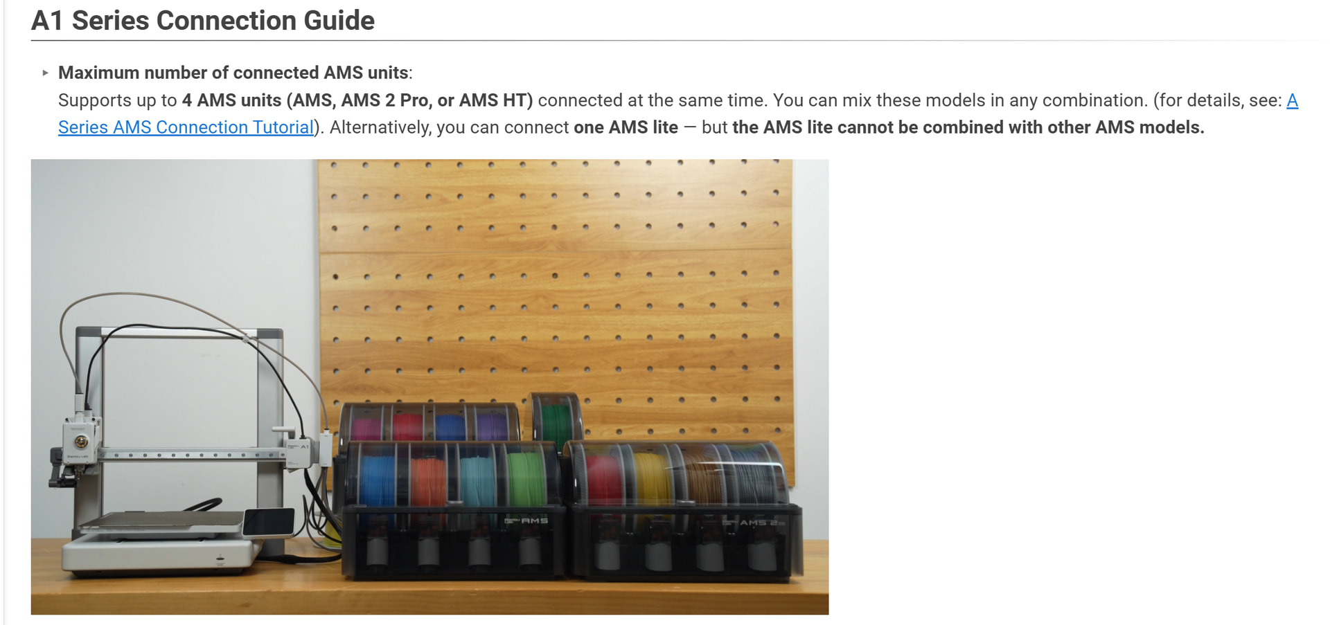

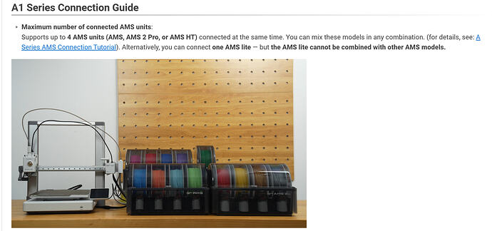

Just because you connect a hub with multiple ports to an A1 Mini, the printer can’t simply print more colours than intended. The deciding factor is the AMS hardware that comes before it.
If you connect an AMS Lite, it will remain at 4 colors.

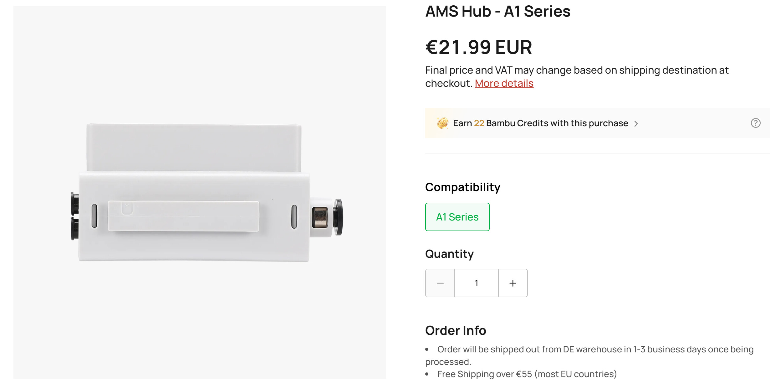

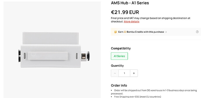

To print additional colors with the A1 series, you’ll need multiple AMS units as described in this guide - just scroll down to the A1 section.
You’ll also need the A1 Series AMS HUB for multiple AMS
