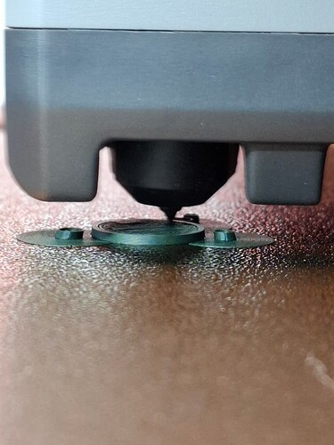

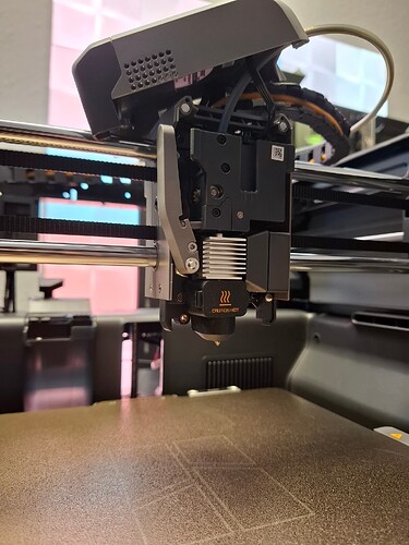

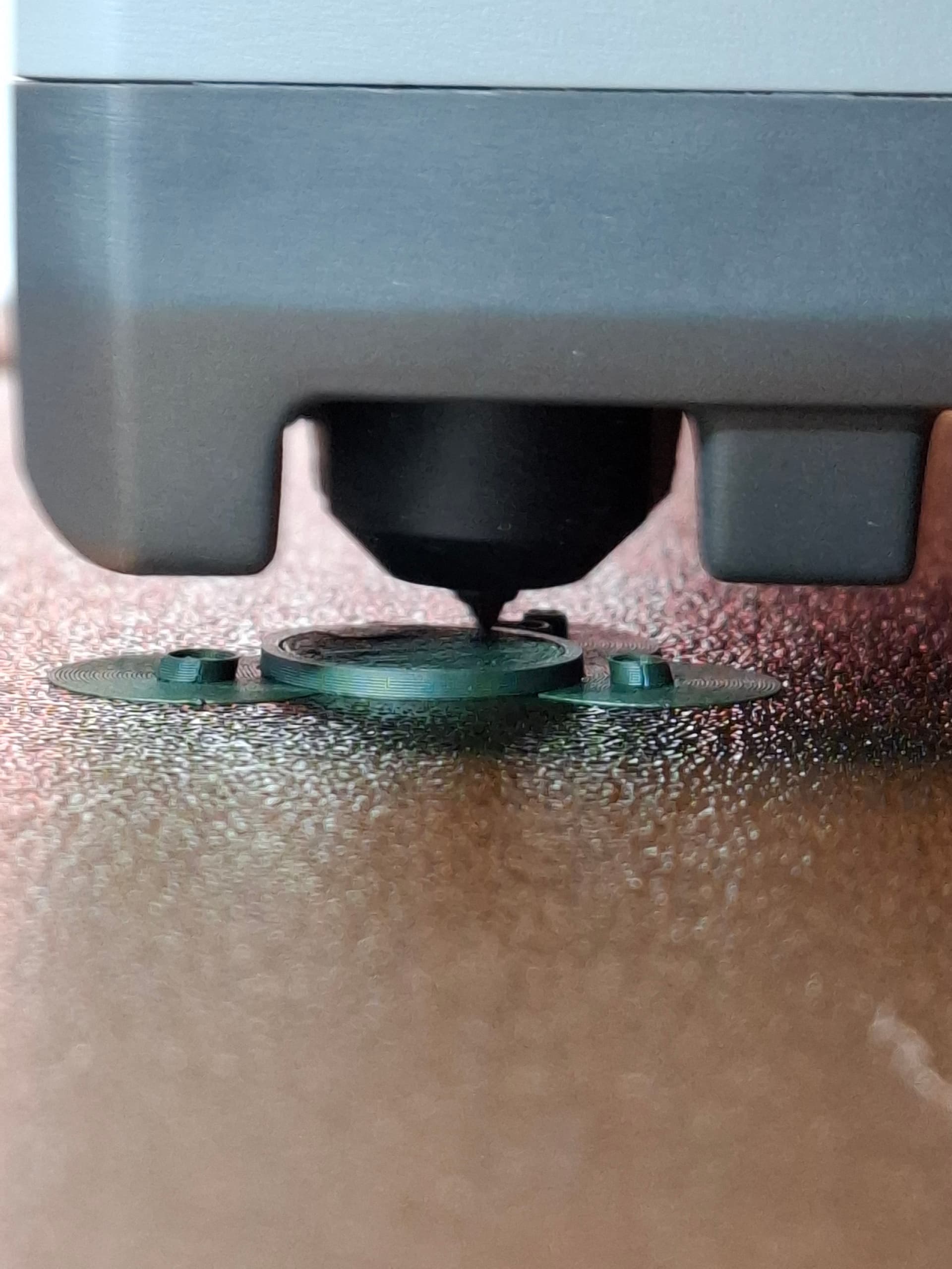

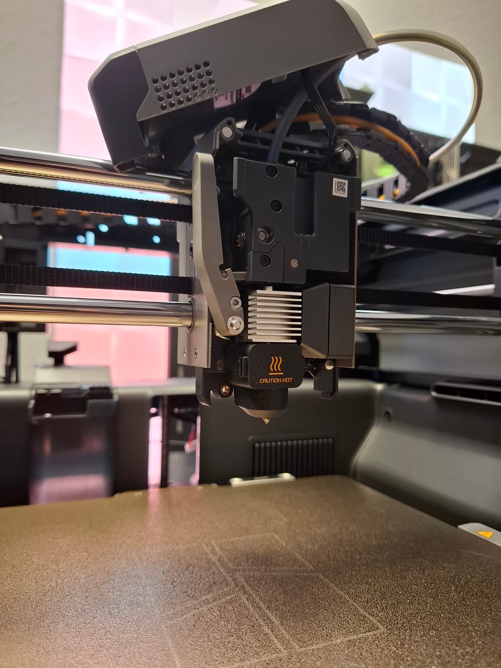

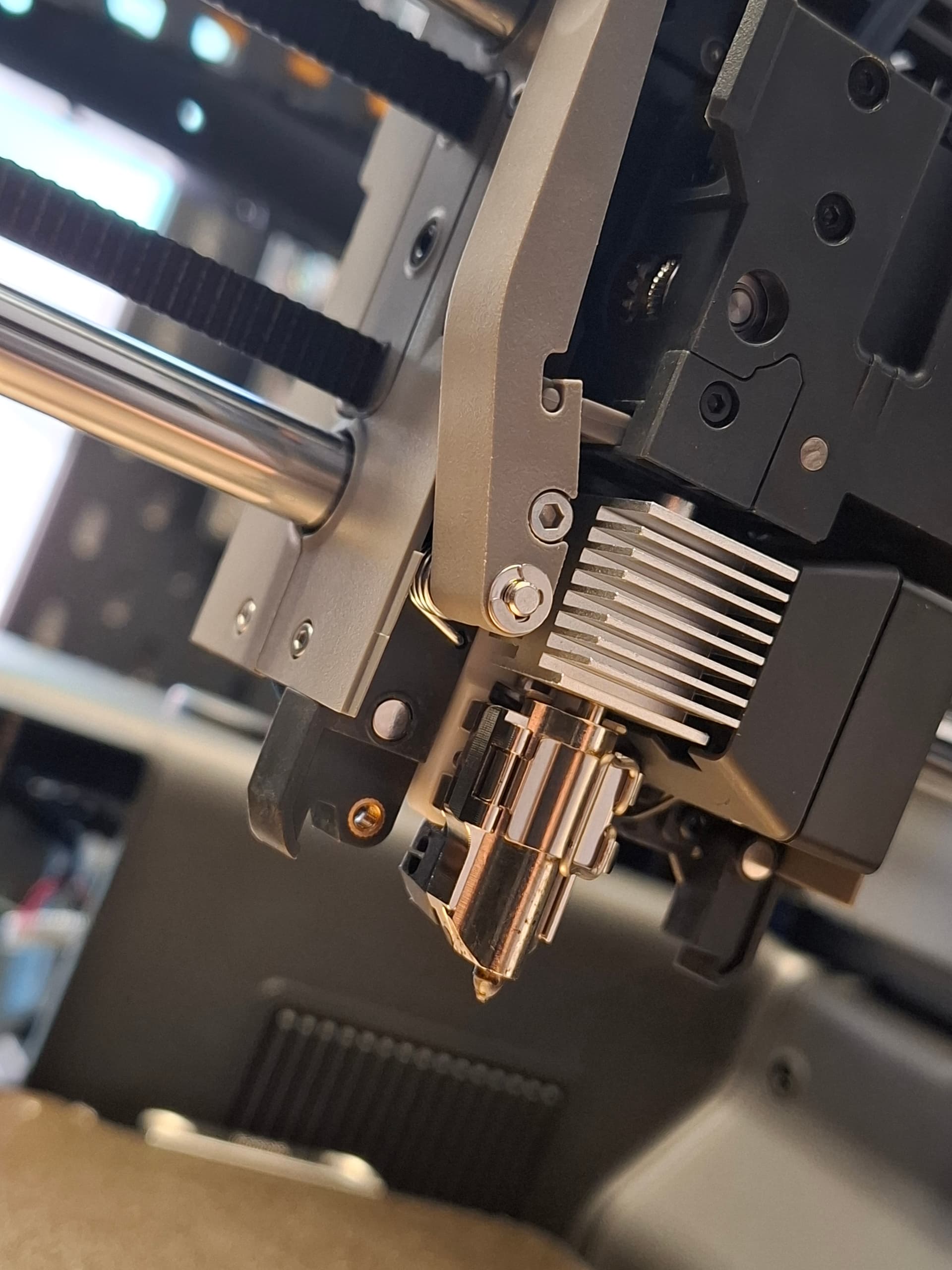

A1 Nozzle on P2S: YES!
I´ve read many questions about campatibility of A1 Nozzles and H2 / P2 Nozzles. even the Bambu FAQ says no.
I´m thinking thats due to flowrates, the P2 nozzles have a longer melting zone, so Bambu cant promote them as compatible as they might not be giving the same output.
I didn´t want to by new 0,2 nozzles for my P2 so i tested that by installing my 0,2 Stainless A1 Nozzle onto the P2S. Had to modify a spare A1 silicone sock, but it fits.
And it prints just fine.
So whoever has the same thought, here you go. It works.

Ich hab es auch versucht, von den maßen her passt es, der Kühlkörper vom A1 ist größer nach unten, aber sonst passt es, silikon muss angepasst werden, …flow, klar der ist anders, allerdings ist es doch genial das es passt…hab noch massig a1 nozzle hier und aktuell 2 a1 mit ams zu Verkaufen
Thanks for the pictures regarding the silicone sock. I modified mine exactly the same way you did. Now I just need to recreate the color coding on the sock so that this stupid error message doesn’t appear anymore saying the silicone sock isn’t installed. But it prints just fine :smiley:
