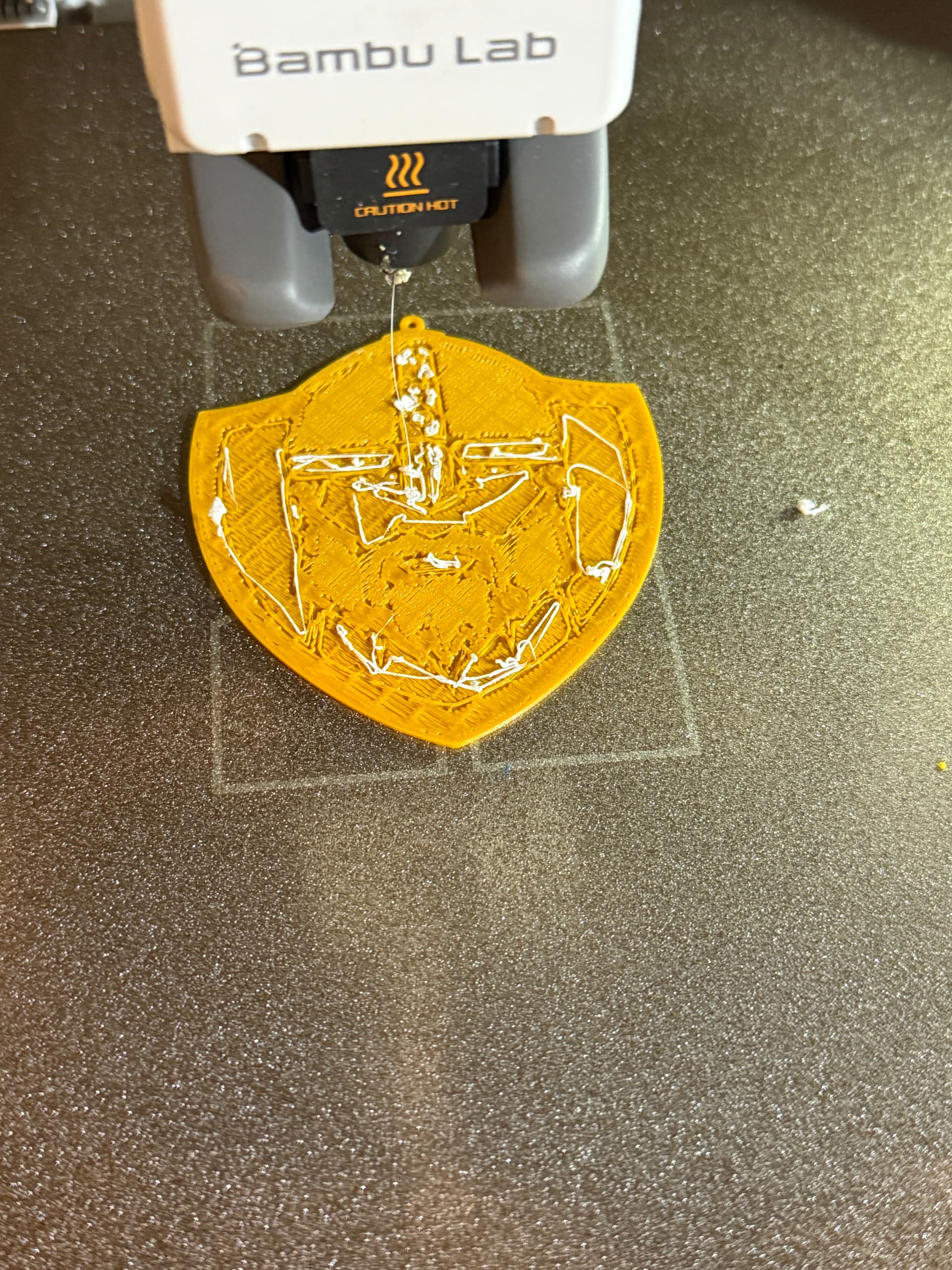

Greetings! Recently got an A1 and I love it so far. I came off a Prusa Mini so it’s obviously a huge upgrade. Most of my prints have worked flawlessly thus far, however I”m really struggling with my latest as I can’t pin down the issue with the stringing and dragging I’m having within a specific model. I’ve tried turning off reduce retraction and also turned up fan speed a bit and printed at 50% speed, but still experiencing issues. Is there anything else I can try? Any help is greatly appreciated!
project2.3mf (1.1 MB)
Filament temp is too high, retraction will lower the nozzle pressure, keeping more of the filament in the head, but the biggest issue is the temp. PETG is notorious for this type of issue. Try PLA on the same print. Keep testing. You’ll get it.
