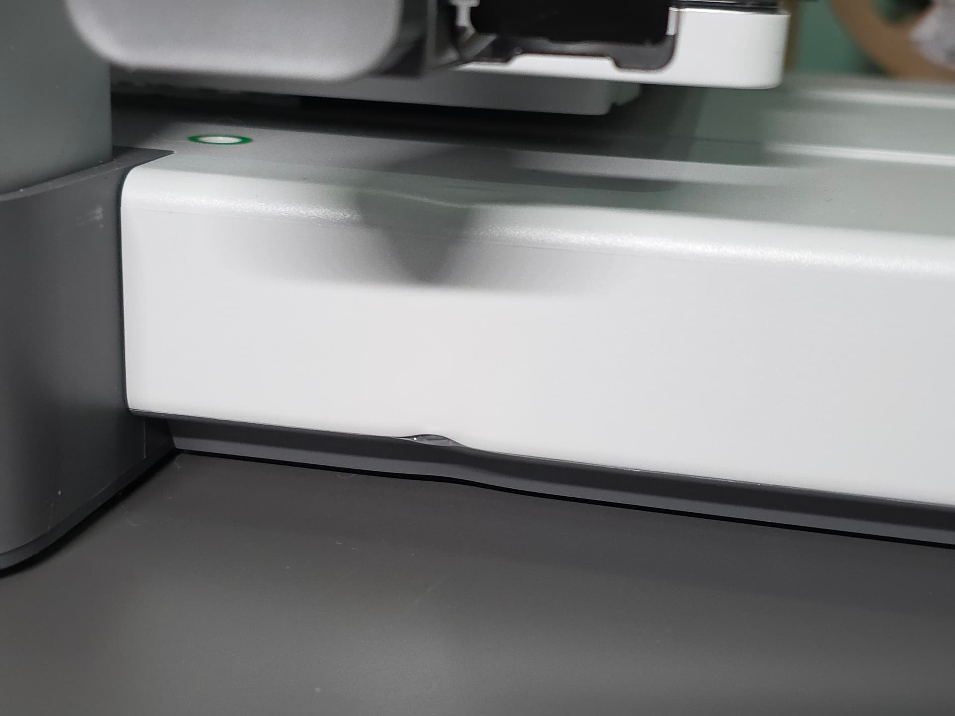

I’ve had my A1 for about a month and it’s been working perfectly. Today, however, I returned to the room it runs in and noticed a burning plastic smell, more so than usual.
It turned out the case on the left hand side under the purge wiper had distorted and was very hot. I have a poop bin there so that obviously doesn’t help with cooling, but it’s not been a problem with multi-hour prints until now.

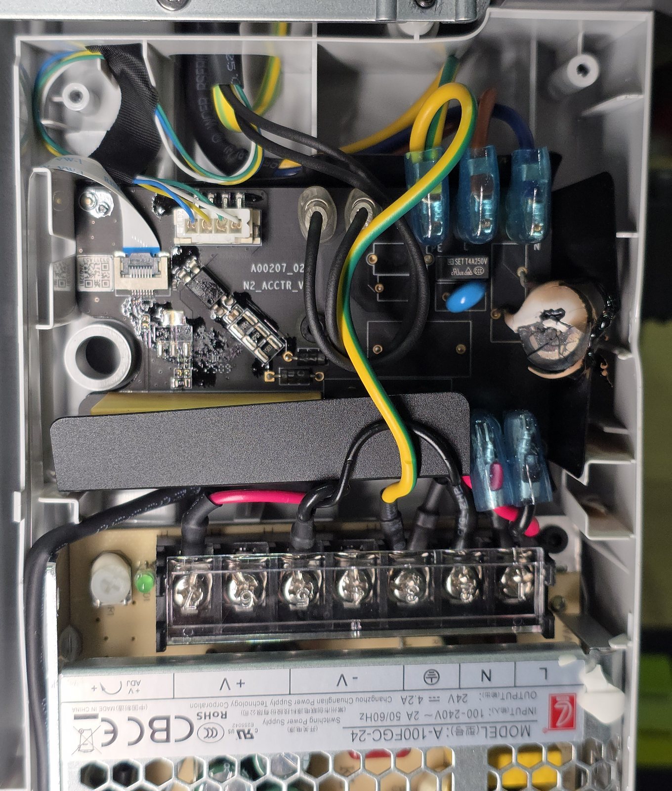

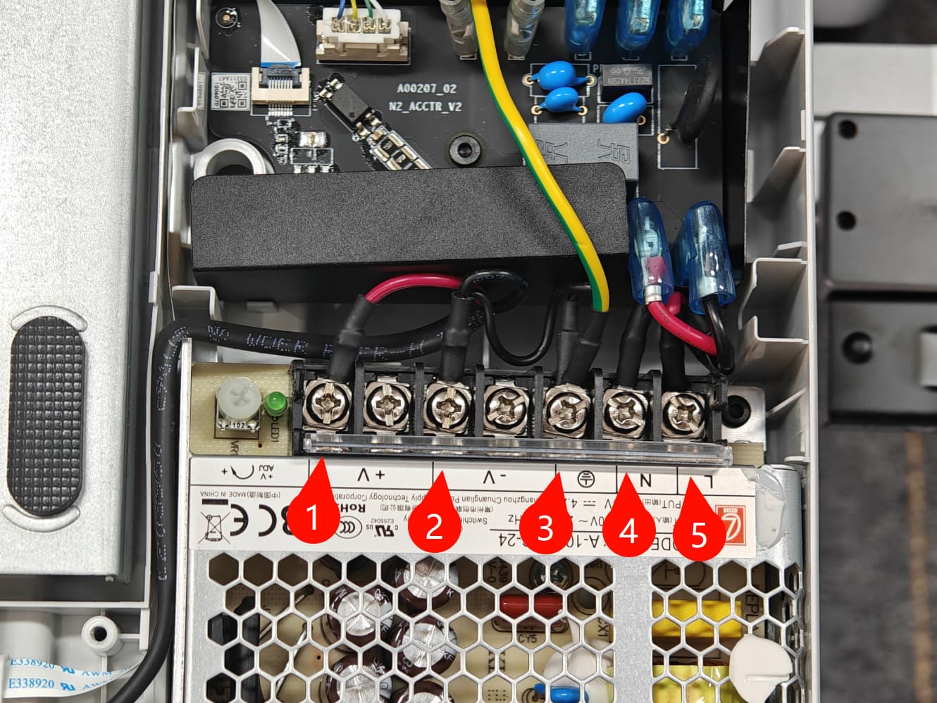

The problem became apparent when I took off the base cover…
Is that the current limiting device?
I’ll open a support call and cease using it.

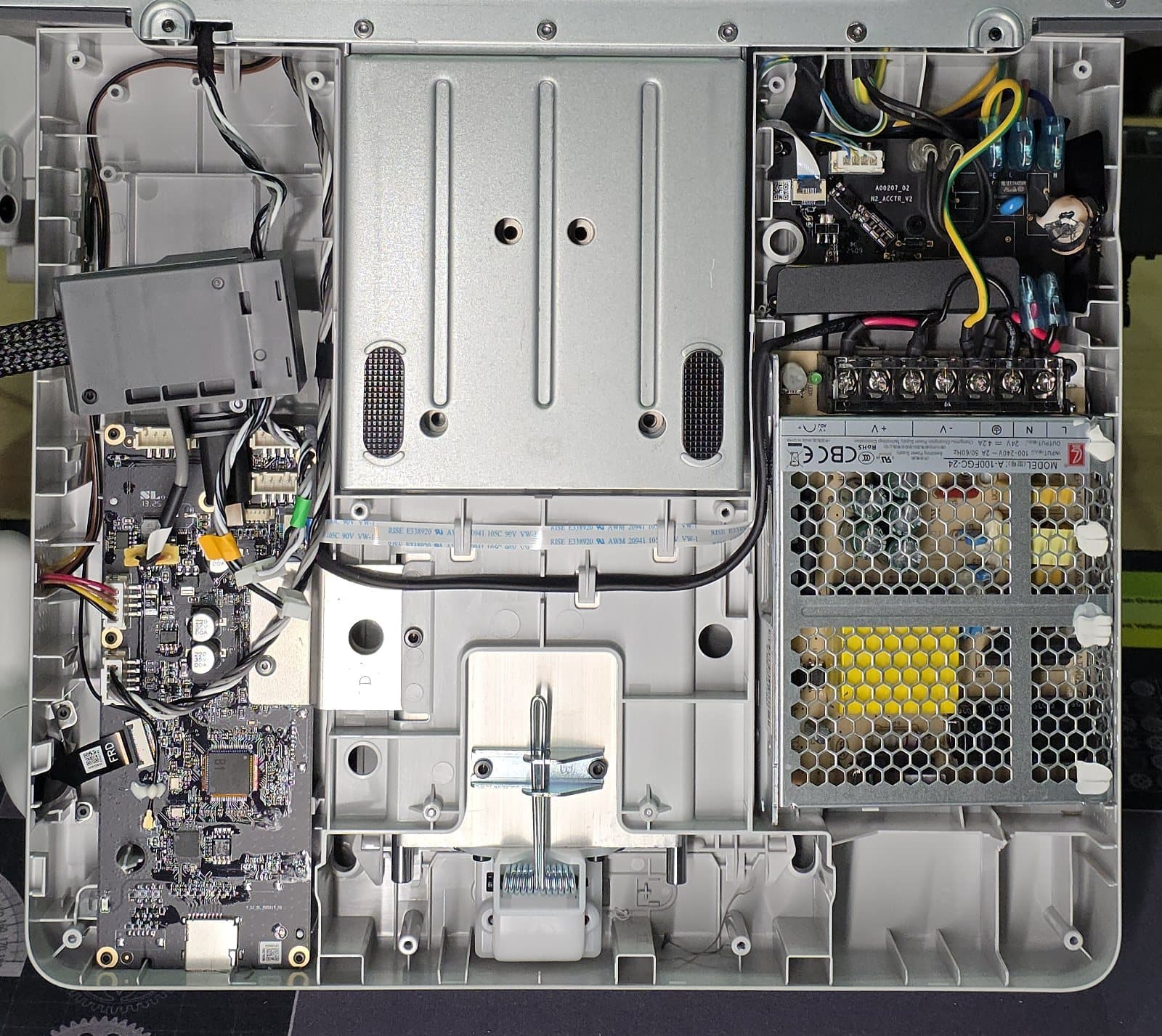

Seeing as I couldn’t find a picture of the insides, here’s one for future reference, in case anyone else finds it useful.

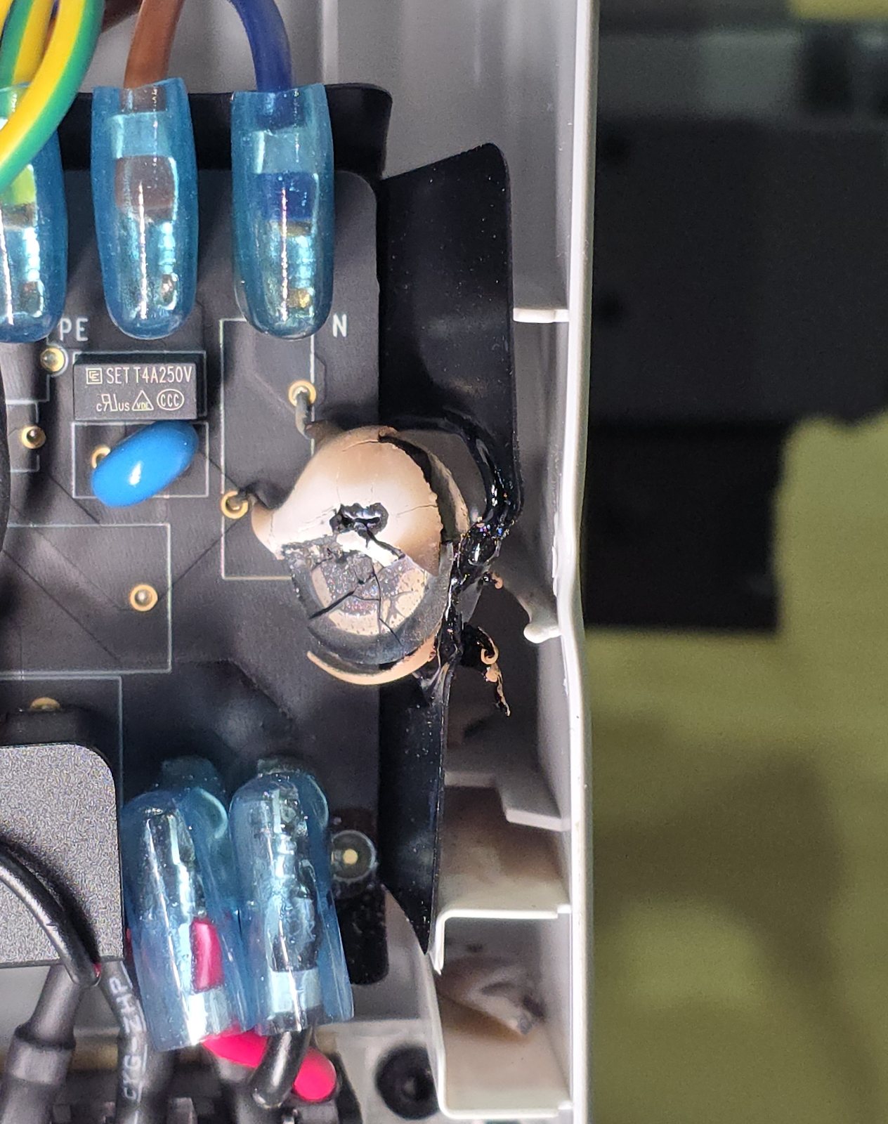

Damn I was spot on.
Cheap capacitors being cheap.
Capacitors act as an energy buffer and smooth phase transitions. They charge and discharge rapidly leading to them wearing much faster. They fail like that when the dielectric is not consitent or does not have full coverage. Dielectric will warp and become unstable with too much heat.
The printer is a gonner. Small faults like that can easily damage other components. The extent is how long it ran after the board failed.

Is that a capacitor or an MOV like @krellboy mentioned?
Actually, that is a great question. I was wrong. Functionality a similar purpose, but yes different things.
The MOVs are the smaller blue attachments next to it.

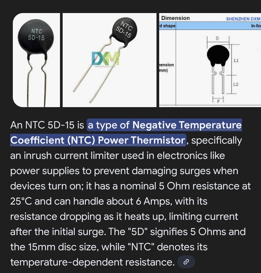

It is a NTC Thermistor
Yeah, when you can’t see a number or value (like uF, etc) and the board is not marked a lot of components look similar (like some inductors and resistors).
I have seen some pretty big MOV’s (sacraficial power protector that diverts something like a power spike to ground) that look similar to the exploded part but again, with no identifier it was a guess on my part.

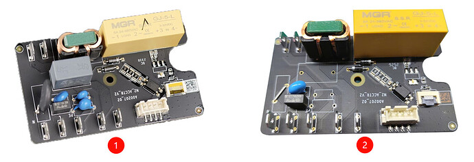

Its also odd. I might be going crazy, but that board does not look the same as when I opened up an A1 last.
That was a great point because it pretty much narrows down the failure mode of to a thermal stress.

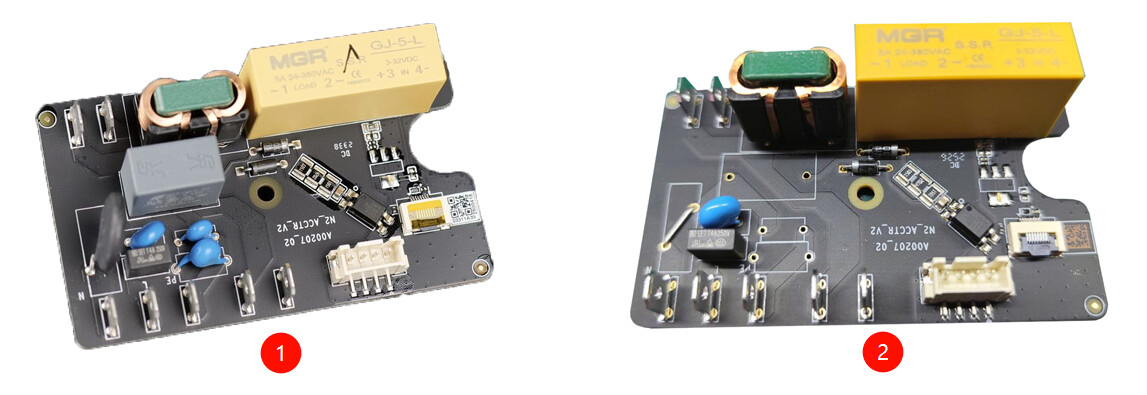

I feel like I have seen 20 of these. Suprised there hasnt been another A1 recall.
OP’s looks like a version 1 board. Looks like V2 has replaced that part with a wire (fusable link?)
Edit… hmmm, OP board says V2 on it… maybe the wiki is backwards? Never mind, they both have a V2 on them
May be because there are 2 boards with the new one apparently getting rid off several components including that capacitor. Strange that a 1 mth old A1 has the old board (or is the wiki to be understood as 2 suppliers and different boards still installed randomly?).
Edit: @thud-oops beat me to it :slight_smile:
I noticed that earlier when grabing the example picture. I still think it looks slightly different. But again, might just be me.
It looks like their board is a odd combination between v1 ans v2. I think the pictures are bad.
Any guess is probably good.
I got rid of my A1 after the heatbed recall anyways. Too many shortcuts in that thing.

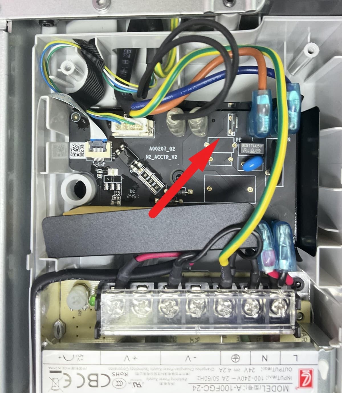

I looked again, OP’s is actually the new board, his is missing the double caps to the right in the wiki pic. Not sure about the wire vs component, maybe one is a 240v board? Further down in the replacement wiki it shows a new board and it has the component also, it’s just covered by a connector wire.
You’re right the OP has a 3rd version of the board. Sounds like BL needs to design a 4th one…
OP even has the ground wire (red arrow) which per the wiki was supposed to be deleted
Hopefully last time contridicting myself…
OP board IS older version, It has the ground wire (green/yellow) attached.
Nothing like using pictures of horses and zebras when talking about gender…
LOL, yeah, I have NO idea what they are doing with the pictures.
My best stupid guess would be mixing 120.240 boards.
I mean, the LUG IS STILL THERE, is there just no trace going to it?
Edit: It looks like they are just “mentioning” the new board in passing. The “newer” A1 doesn’t have the intermediant connector on the ground wire. Since they don’t mention changing out the ground wire (that I saw) I’m not sure what would happen if you put the “new” version of the board in an older A1 and connected the ground lug.

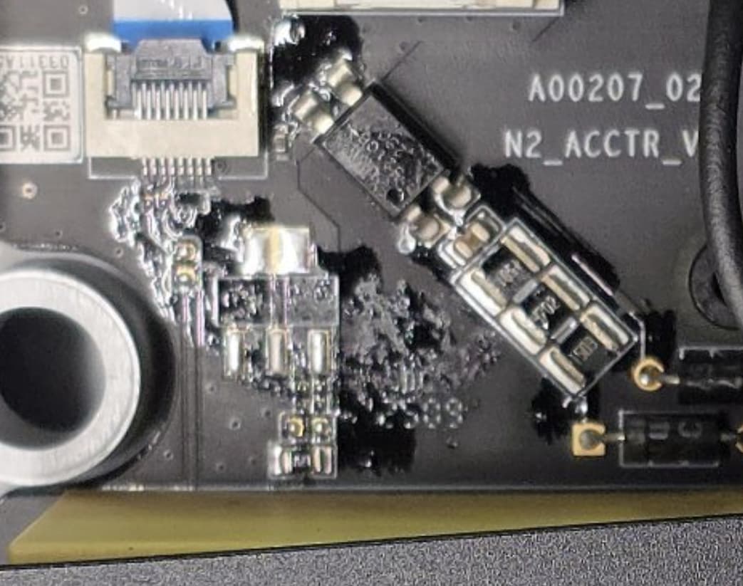

This doesn’t look too healthy, either.
I think this is just reflow on the production line. QC (the small hands operators) reflowing some not perfect solder points.
I have many chinese boards showing the same thing on some solder points but it could be overheat on this particular board.
So you are saying there needs to be another QC after the first QC? :wink:
Looking closer I guess you are right. And it wouldn’t be the first time I see electronics from Chinese brands where the PCDs had been manually soldered after production, some even add extra wired components (like resistors, capacitors) across the PCBs.
At least I hope they used a no-clean flux because obviously they didn’t clean it afterwards.
