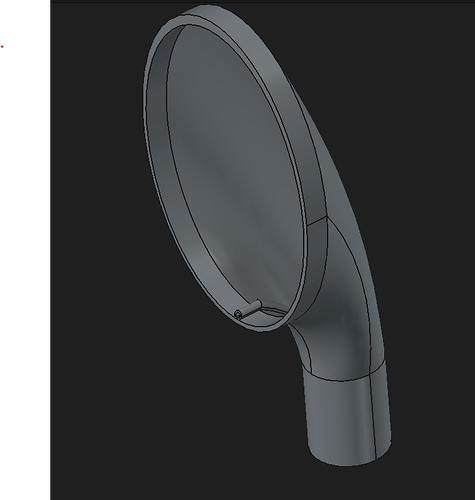

This caravan filler funnel is the thing I’m trying to print.
For some reason I cannot upload the 3MF here, due to the 500 MB limit… Which this 28 Mb doc is clearly above :face_with_raised_eyebrow:
I made this in FreeCAD, which is also fairly new for me. So there is also a possibility that I did something wrong in the design of this.

  • The printer seems to get stuck on the air tube that is inside the pipe.

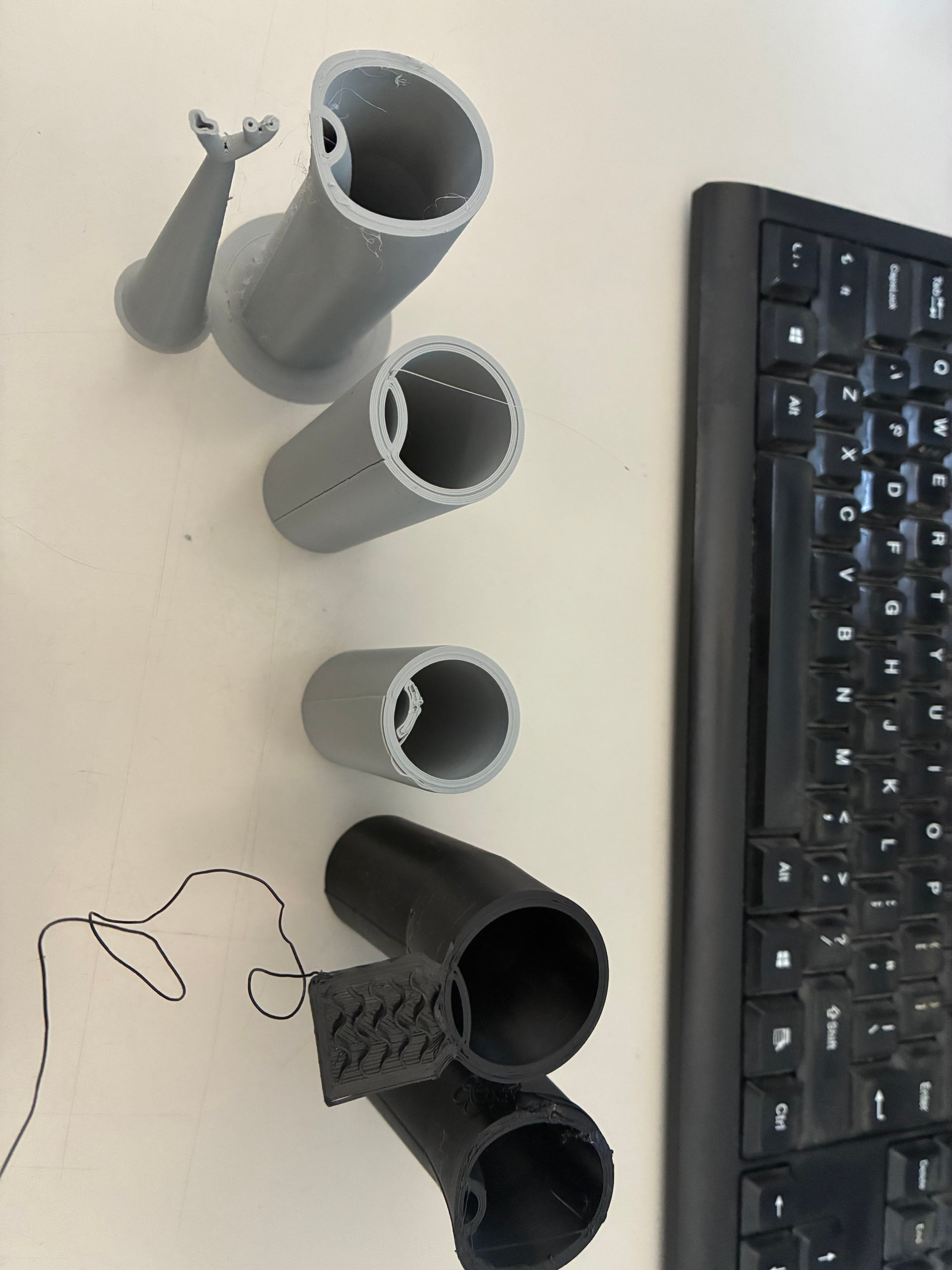

    In two of the versions I didn’t attach that air tube to the pipe. And it failed fairly early on in the print due to that. See image below here.
    After fixing that in the model, the prints got higher up.

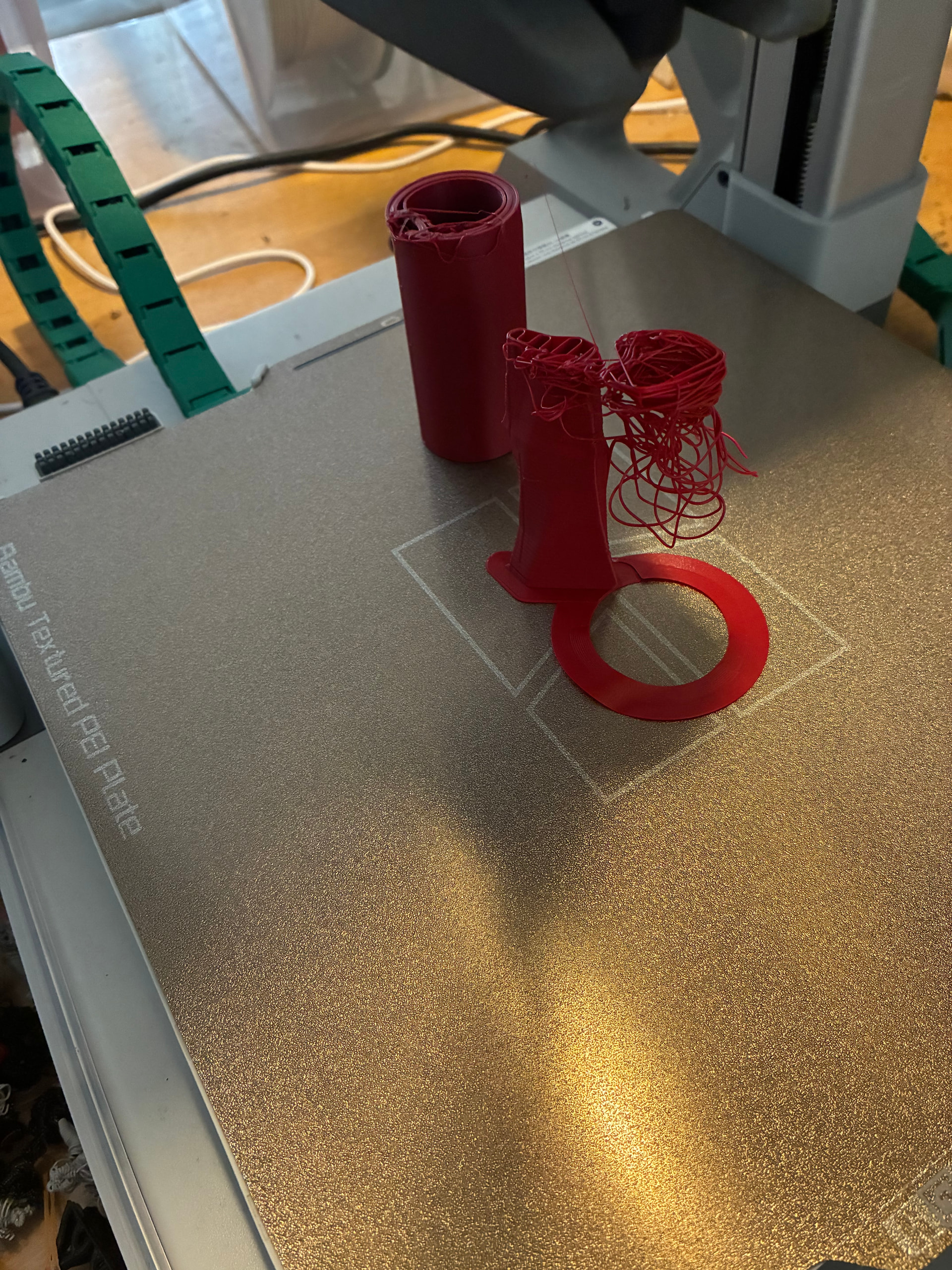

    • Added a block in Bambu Studio from bottom to beyond the inner tube (thinking that it is the problem area) to slow the print down. The print just fell over a bit slower, but still got knocked off. See image below here.

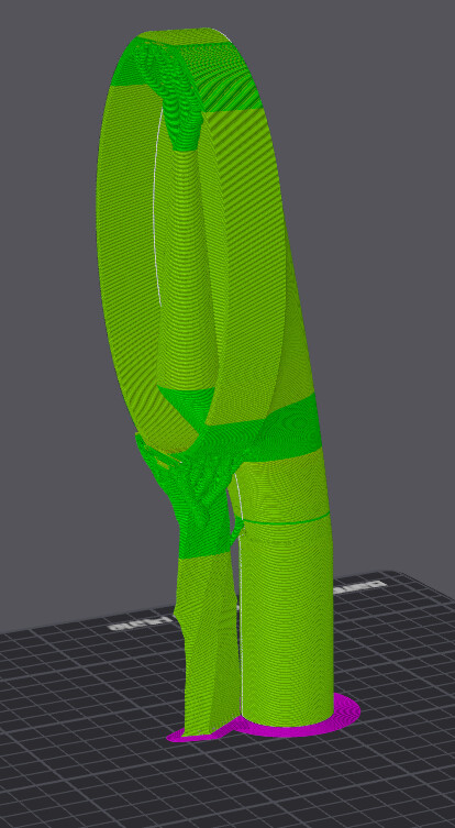

Just downloaded the newest version of Studio (2.7.1.62) and there is a difference in the supports now.
The bottom one looks different and this is the first time a support comes through the pipe as well.
See picture below. It’s on Fan Speed Color Scheme, otherwise you couldn’t see much.
I’m going to give this one a try as well right now. Might be the solution I’m looking for.

This didn’t work either. The pipe got knocked, but the outer support kept in place.
I was a bit late at the printer to cancel as you can see.
The pipe is knocked from the inner and outer brim and dragged across the plate. The outer brim got loose with this happening by the looks of it. Parts were still very much sticking to the plate though.
The outer support is firmly in place still. The inner support moved along with the pipe, but still sits very nicely stuck in the pipe.
I’m going to do a run with the print cut at the pipe. So just the pipe part and see what happens with that.

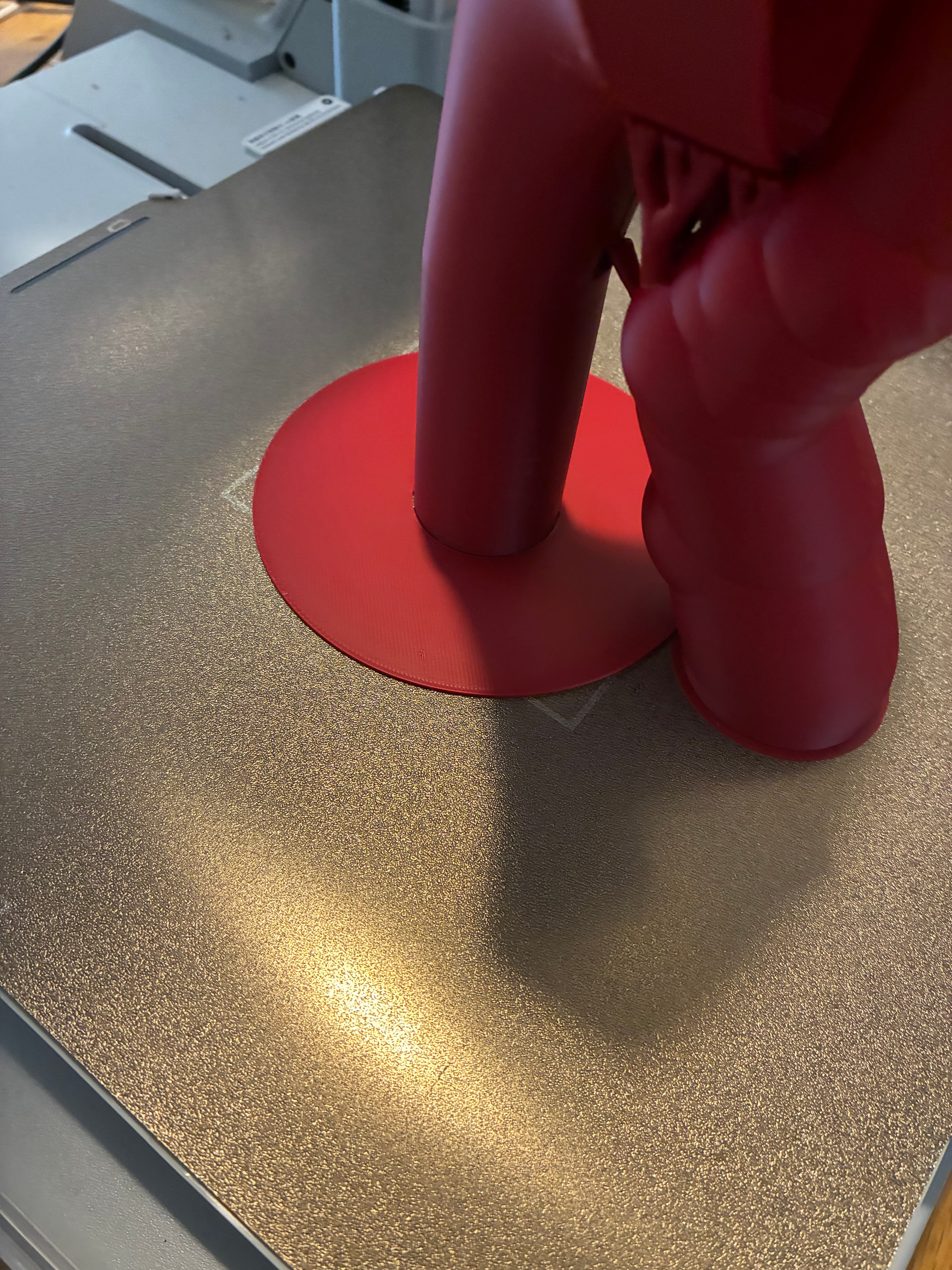

Well, finally made it work without issues.
Solution: Made a bigger plate at the bottom in the model itself. It now has a 100 mm plate of 1 mm thick underneath it. With a 0.10 mm slit between the pipe and plate.
The plate is also attached to the model on 6 sides with a 0.25 mm thick “block”, to keep it attached.
After print the plate snaps right off without tools. And other than 6 pin points to smooth out afterwards, the print is pretty smooth and I call it a success.
I’ll be scaling the plate down to the minimum required size for it not to fail. The plate before this one I used was 25 mm and that failed, so the sweet spot is somewhere between 25 mm and 100 mm.
