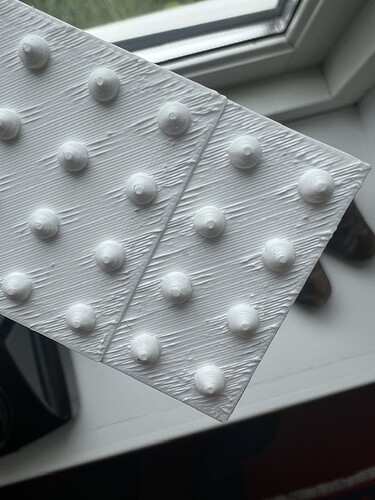

I recently received a A1 which seem a very nice machine for the price. However I have a few questions.
1- When doing some bed levelling at setup the print head went scratching the nozzle on the rear tab area. I guess this is to make sure the nozzle is clear, but to the point of ripping of the coating and leaving a black trace? I worry this has damaged the nozzle tip leading to discussable quality. (More later)
2- The X axis belt is not centred on the right side (see picture). On the left side it is centered in the extrusion grove. Should I center it by hand?

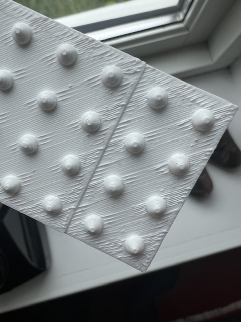

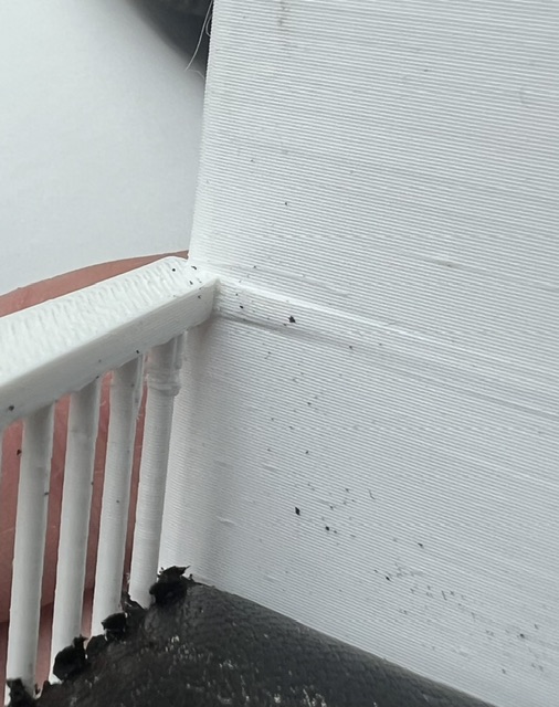

3- Print quality (possibly linked to pressure advance (or whatever they call it)) is so and so in spite of using the correct material profile (Sunlu PLA+ 2.0) and doing auto PA. First layer is very slightly under extruded, on walls there are pressure issues (picture) and the top layer is downright crappy (Picture).
Filament is newly opened but I haven’t been able to dry it more as dryer delivery is delayed. Anyhow it looks more like pressure issues than humidity.
I do worry the nozzle got damaged when scraping on the build plate, or? any ideas?

I’d say overall you need to adjust Flow Ratio down 2%, and the PA is maybe off by a little too but not much, by vibes alone. Flow Rate test is in order IMO. Idk what the black crud is on pic 3 but im assuming not reelevant during print time.
Thank you for the replies everyone. Sunlu PLA+ 2.0 haven’t been the easiest to get right on the P2S either, so I’ll try calibrating and hope the drier gets here quickly.
