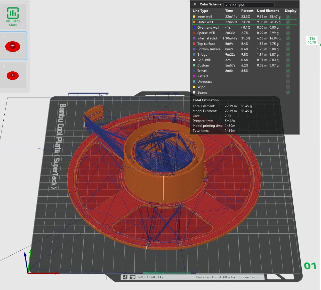

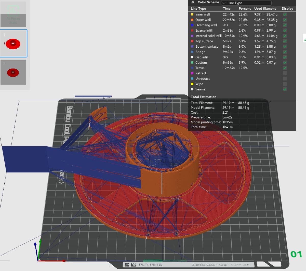

Not a huge time saving on this example, but removes unnecessary travel.
Before:
After:
Thanks for the tip, but on an 8 hour print I saved only 11 minutes. So I’d say don’t bother.
Before (8h 27m)
After (8H 16m)
