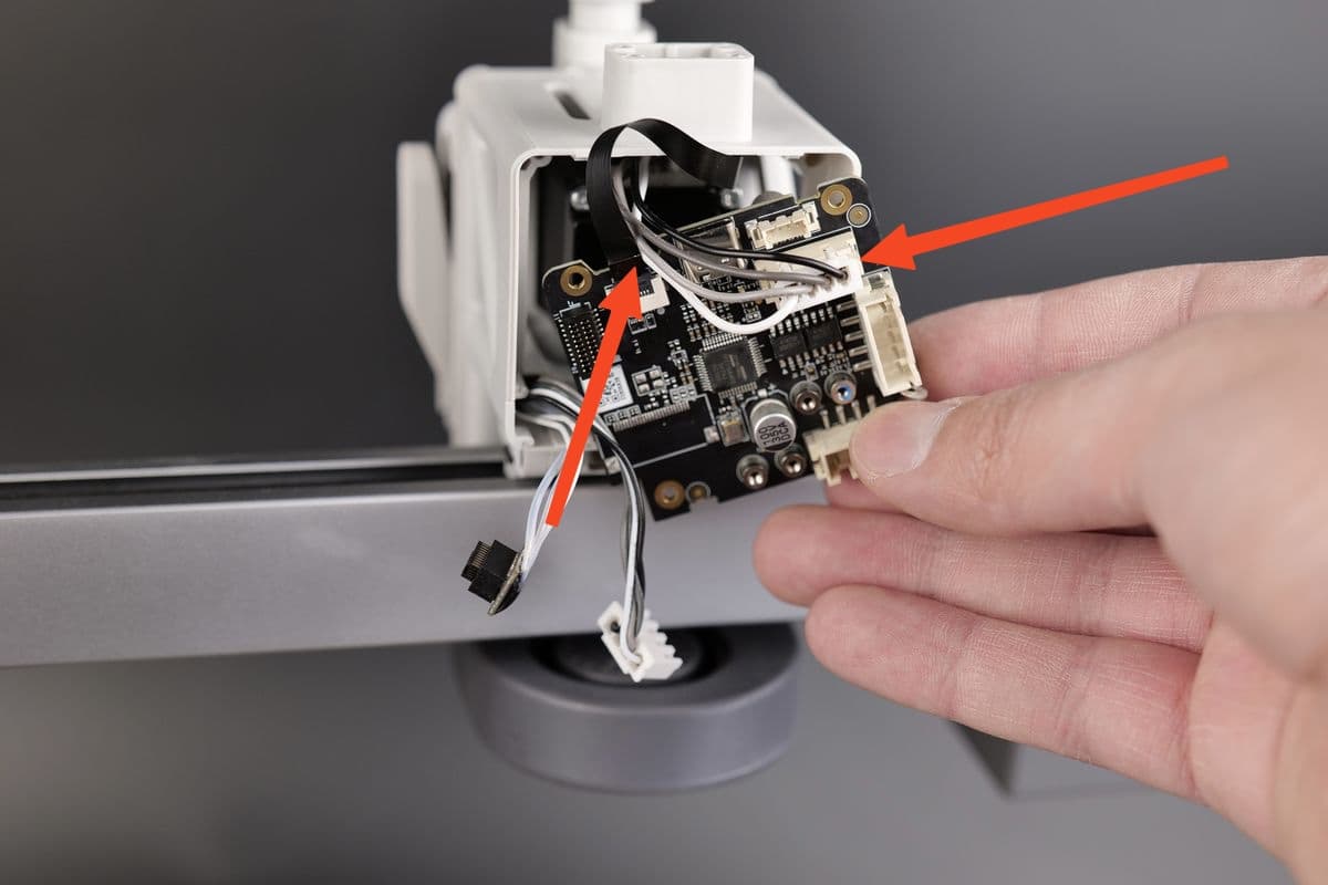

Decided to just bust the extruder unit assembly and replace as I cant be bothered messing around. The tiny ribbon connector on the extruder circuit board was broken - The head assembly to slide it in was disconnected (I think this is the filament location sensor…the tiny connector ribbon connector top left. So not that I have the extruder unit new , do i just buy the rear part and replace the whole assembly, I dont see this replacement cable anywhere on Bambu Canada spare parts, or maybe its this cable I need
Perhaps this is the cable I require?
That is the part you need to order.
Which is hilarrious because I sent the issue explanation to BL support , they replies free TH board coming my way
The filament sensor ribbon does not emanate from the TH board, it attaches to it via a ribbon cable clip insert. I sent them log files and a pic of the cable with no connector on it, platic slide in connector had come off, they can send me 100 of these boards, all wont work without the proper cable with connector, had to resend again with the same pics, gonna be a long 2 wks I think
