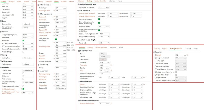

Hello everyone, İ am using bambulab A1 with generic TPU 95A
My tpu prints generaly looks good but Overhangs not bonding. i try several settings and formula but didnt work anything. some sections are good some are not bonding.
i tryed this solutions
Dry fillament 60c at 8hour , speed down, disable flowrate cal. and increase flow, higher tempature, 1 Wall-6wall print, infill wall overlap increase %15 to 50 and more.
PLEASE inspect photos and give some advice. thank you
Bump those temps 15 degres ! and try !
I agree in full…
If it won’t stick it is usually due to the print temp being too low.
With an open printer that just adds to the problem.
Thank you for great advice. i will try muchh more temp to add. But this time i think create much more stringing.
