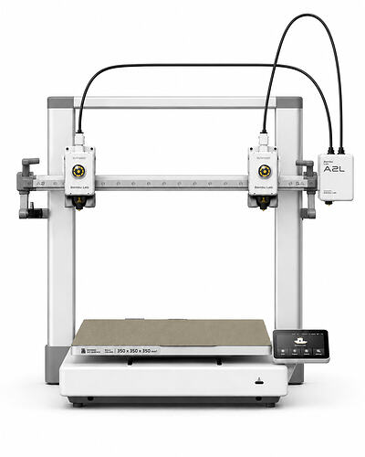

A2L: Dual-Head Kit
One belt. One shuttle. Two mechanically switched toolheads.
  • One X-axis belt
  • One permanent drive shuttle attached to the belt
  • Shuttle mechanically locks to one toolhead at a time
  • When the active head enters its dock, a fixed cam or release pin opens the shuttle latch
  • The dock holds the parked toolhead while the shuttle travels to the opposite side
  • The shuttle locks into the next toolhead, then the dock releases it
  • No independent toolhead movement
Think of a garage door trolley. The shuttle stays attached to the belt, and when the toolhead reaches the dock, cut lever gets pushed to release the latch from the shuttle.
Just a rant for now… but maybe it turns into a project.
