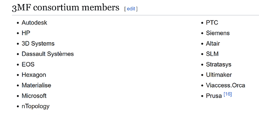

Bambu does a lot of non-standard things to their 3MF format and doesn’t document them. I know, you’re shaking your head and saying “Surely you don’t mean that Bambu Labs would be opaque and non-transparent in their tech” but it’s true, ask anyone. :rofl:
Notice Bambu isn’t on this list:
If you want to get your inner-geek on, here’s the spec at the 3MF consortium website:
