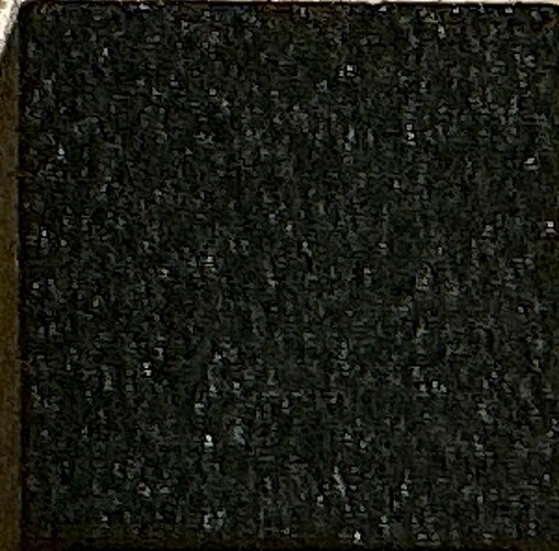

TPU Air produces a satin-like surface finish, while materials such as Bambu Lab TPU 95A HF and similar high-flow TPUs tend to result in a shinier, glossier appearance.

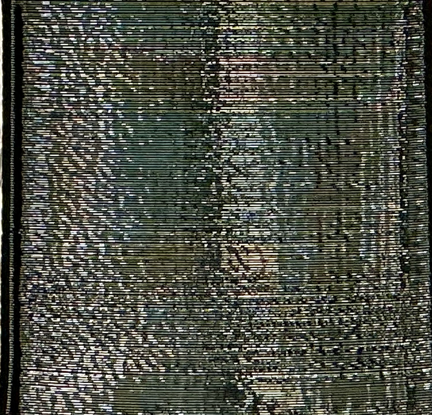

Thanks! Would love to see a few photos of the different surface finishes when you have time.
From TPU Air? Or PEBA?
I can see if I have some TPU Air to show.
PEBA 95A, side from a hollow cube
TPU Air 70A, sid from a smal hollow cube
