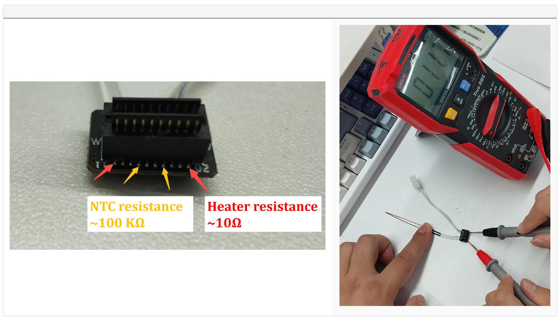

Can you measure the NTC as described in the wiki?

So I did measure the heat assembly resistance at the showed pins.
Outer pins: measure at 6 ohms which is not that much in the 10 ohms range as it should.
Inner pins: measured at 101.2k which looks to be fine.
Other assembly I have measured at:
Outer pins: measure at 10 ohms
Inner pins: measured at 89.5k.
