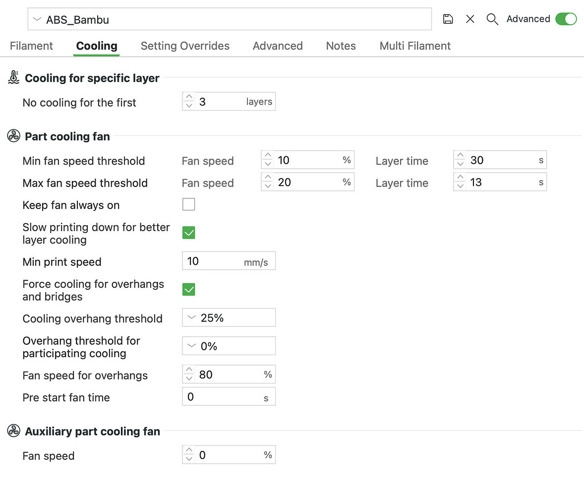

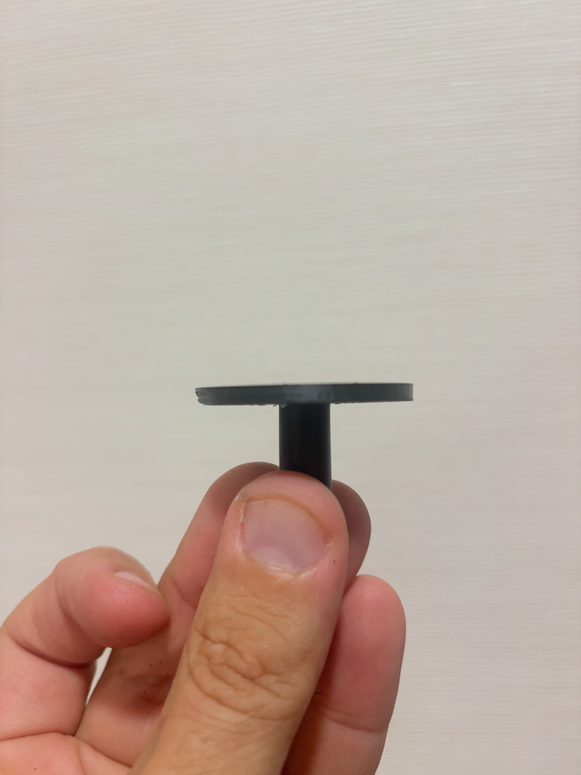

ABS & HIPS Printing Challenge - Bambu Studio & H2D
After closer inspection of the filament cooling settings, I noticed the “Fan speed for overhangs” was still at 80%. Put it down to 20% to be the sam as max fan speed and that seems to have really helped with the outside rim of this test support region.
