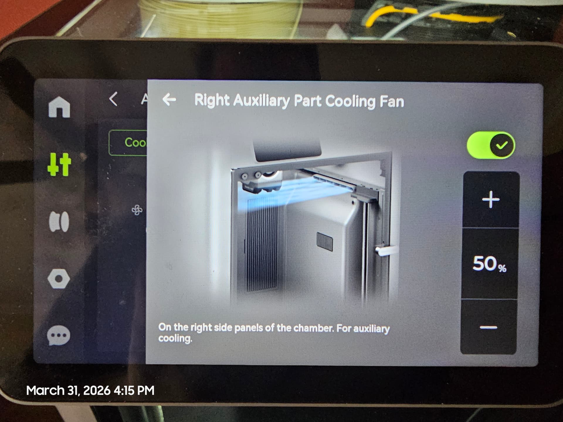

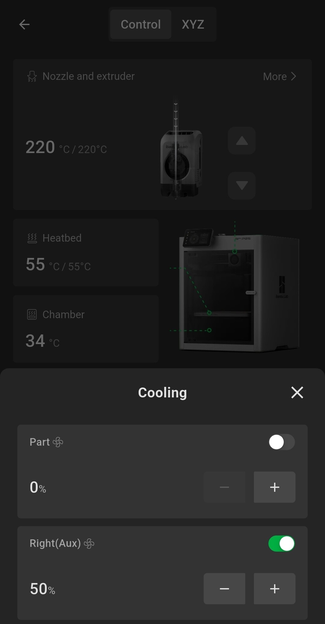

I’m printing ABS on a Bambu Lab P2S and trying to maintain a chamber temperature of around 50–60°C.
However, I can’t find any settings in Bambu Studio that control chamber heating or auxiliary fan behavior. In the ABS filament profile, the auxiliary fan is set to 0%, but when the print starts, the printer automatically ramps it up to 100%.
Because of this, the chamber temperature drops significantly, and I have to manually reduce the auxiliary fan speed every time I start a print.

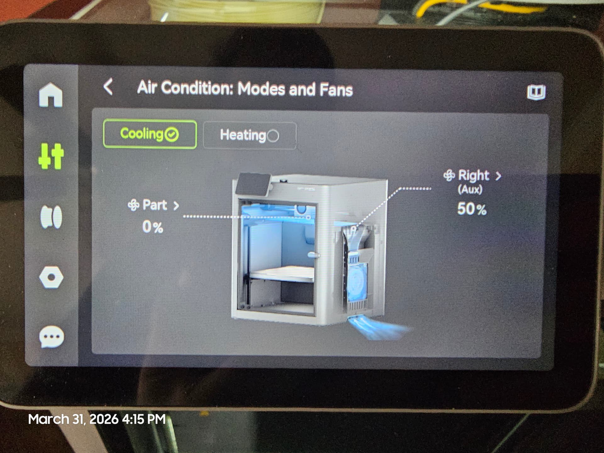

First, we need to clarify which aux fan is which. Bambu doesn’t clearly define them so maybe this will help.
The right side aux fan (P2) is built-in and operates in two modes; cooling or heating. In cooling mode it brings outside air in from underneath the printer and blows it out over the heat bed. In heating mode, it recirculates the chamber air, drawing it through the carbon filter and blowing it back into the chamber through a lower grill, normally below the heat bed. Heating mode does NOT draw outside (cool) air into the chamber. Nor does it provide any heat. It retains the chamber heat, produced by the heat bed and hot end, by not diluting it with outside air.
The left side aux cooling fan (P10) is optional. Unless you have specifically purchased and installed this option, you don’t have it. It simple recirculates chamber air, drawing from the bottom and blowing out over the heat bed. This is the aux fan that is referenced at the bottom of the filament cooling settings as a minimum speed. The printer will automatically adjust this fan speed during a print.
ABS prints with heating mode, so there is no need to stop the (right side) aux fan.
I hope this helps.
I am trying to adjust right side aux fan.
I am printing a lot of ABS. And when Right fan 100% heating mode - chamber temperature is 37-42C. When Right fan OFF - chamber temperature is 50-52C.
Some people use default bambu ABS profile (Right fan 100% heating mode) and have no any problem. I belive theirs models are small and layer time is also small so require more cooling.
the mail problem is that is filament profile only one setting Aux Fan. It set to 0%.
I dont know which fan is in filament profile.
And where is Right fan adjustment.
Accidentally I found code in Printer profile - Machine Start G-Code:
but I have no idea how to set right fan to 0% only for ABS
definitelly “M145” - airduct mode, “M145 P0” - cooling, “M145 P1” heating
“M106 P2” - auxiliary fan
“M106 P3” - chamber fan
