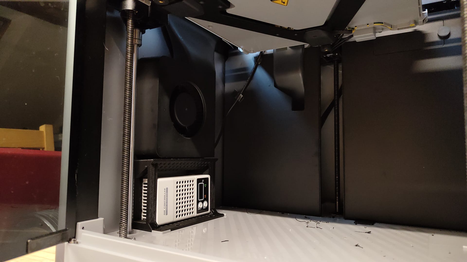

Here’s the only picture I have:
I drew some help lines with a pen inside the chamber before dismounting the wall plates, to know where insulation was needed. All edges of the neoprene sheets are hidden after reassembly - if you would look inside my printer, you’d hardly notice - it’s just a bit whiter.
I was hoping for some noise reduction as a bonus but I honestly can’t say I notice any difference. The printer definitely heats up faster and more, although I have only printed PLA since I added this, which makes it undesirable: I’ve had to open up the glass lid a couple of cm to avoid reaching 40°C chamber temperature with a PEI plate and large prints. Then again, I hate fan noise so I always try to keep them at a minimum.
I can’t find the 1.5 mm thick variant on Amazon right now. The brand was ā€œSDLDEERā€ (Amazon Europe) but there are plenty of similar products - just ensure you get 1.5 mm thickness, and white!! The product description for what I bought was ā€œSDLDEER Neoprene Foam Plate, Self-Adhesive, Multifunctional Foam, Adhesive Foam Roller Sound Insulation Non-slip Insulation Shock Absorption Buffers (White, 300mm(W) x 1.5mm(D) x 1.5m(L))ā€.

I bought one of those heaters for my resin printers. I found the one I bought had an NTC heating element rather than a PTC (despite being listed as PTC). It also doesn’t have a thermal fuse. I didn’t use it after discovering that, it’s just too dangerous. With PTC the resistance increases with temperature, so it’s self regulating. But the NTC one I got draws more power the hotter it gets. If the fan dies or gets blocked then it’s going to go into thermal runaway. I’d check yours before using it. If it is NTC you could still use it safely by installing a thermal fuse (or switch) but the other issue is that because it draws less power when cold the performance at start up isn’t great either. Hopefully mine was just a fluke.
I’ve run a few tests with it for up to 8 hours. I put it in a closed 20L bucket, added power with no control. It takes a few minutes to climb from 2A @ 24V initially to 5.3Amps after that it settles to about 4.7Amps. The highest temperature the air in the bucket reached was around 68-70C. So I don’t think there’s too much danger using it but thanks for the info, I’ll probably add an 80 degree klixxon.

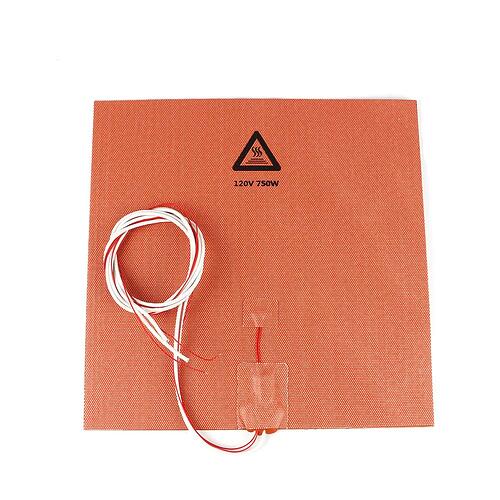

Thinking outside the box (literally): Has anyone here looked into possibly using silicon heating pads attached to the outside of an X1 to raise the inside temperature? They come in practically all shapes and sizes and a whole range of wattages, from low wattage to fairly high wattage… Some are rated for DC and others for AC. Examples:

AC (750w):
Some of them, like the second one, come with 3M 468MP tape for attaching it, or you could buy your own for that purpose.
Just as with a heated bed upgrade, you could insulate over the pad so that more of the heat goes in the intended direction (i.e. inside the chamber, rather than heating your room).
Two of the X1C walls are unobstructed on the outside, and so, for symmetry sake, maybe you’d want to heat both of them equally. That help even out the temperature inside the printer.

Attach to the OUTSIDE of the cabinet? That would be horribly inefficient, I’d think. There are small thermostatically controlled heaters you can stick in the cabinet. They’re made mainly for SLA printers but work fine here too.
Well, fair enough, if efficiency is what matters most, then I concede the point.
