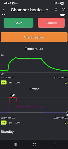

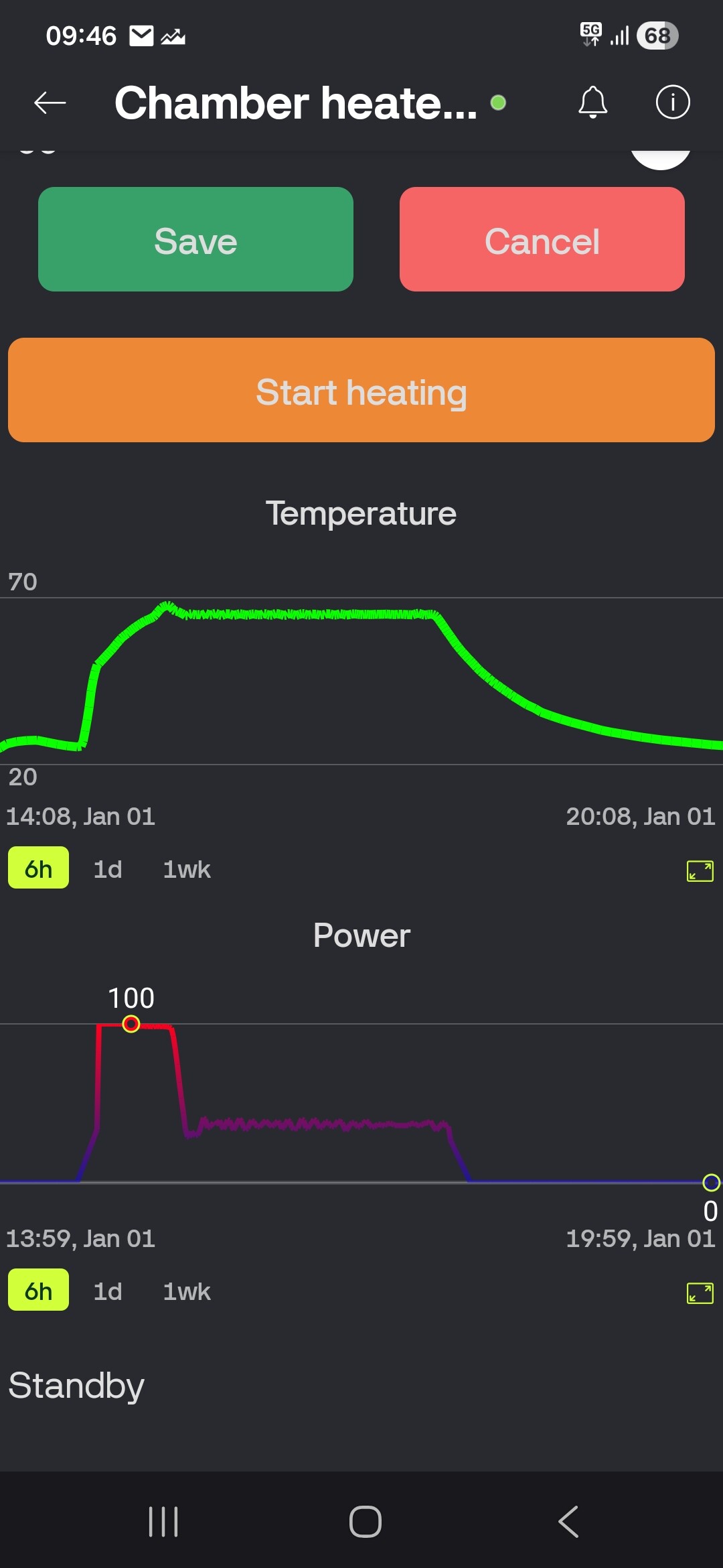

The on/off-induced wobbling you described does not occur with my simple, two-point-controlled DIY heater. Most likely because I’m using a very narrow temperature window of only 1.5 °C.
Like you, ABS and ASA are also among my favorite filaments. These materials need to be printed at high temperatures. I consider airflow — even warm airflow — in the extrusion area to be counterproductive. Even a 65 °C airflow passing over freshly extruded material at around 250 °C will locally cool it down significantly.
From my point of view, the build chamber for ABS and ASA should therefore be as warm as possible, but ideally without any significant circulating air currents.
No matter how small the hysteresis you apply, when the heater is on, the air coming out of it is around 200°C, and when it’s off, it’s 65°C. Such a difference will always cause thermal expansion.I also didn’t notice the problem until I had to print the aforementioned lawnmower house. Due to its size, it couldn’t be moved away from the heater, and its height revealed the issue.With an on/off chamber heater, I recommend choosing solutions with upward exhaust and placing the printed model on the opposite side of the build plate.As for air circulation, it’s always a compromise here — lack of circulation will create a temperature gradient (hot air rises) and uneven distribution in the chamber. On the other hand, too much circulation will weaken bed and layers adhesion.I use 65°C and 10% speed on the auxiliary fan.
In the photo, you have a graph of power and temperature over time. Only at the beginning (when the model is low and it doesn’t matter) is the power high, and then it drops to a constant value, which means the temperature of the air from the heater remains consistently the same the whole time.
